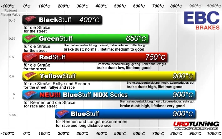

From my couple of research, this is the best I could find to summarize the color vs brake pad from EBC:
(With the update that YellowStuff are now not recommended for track uses.)
Looks like RedStuff is the best for rotor wear, which will probably be my choice since no track day are planned. The low dust is just a plus!
If it wasn't for rotor wear, i would go YellowStuff.
BlueStuff might have some braking problem under low temp (which for me in Canada could be a problem in Spring/Autumn) so choose the right "NDX Series" version.
Last thing, the RP series isn't legal for road use... Just a heads up, not like cops would look at your brake pads...
