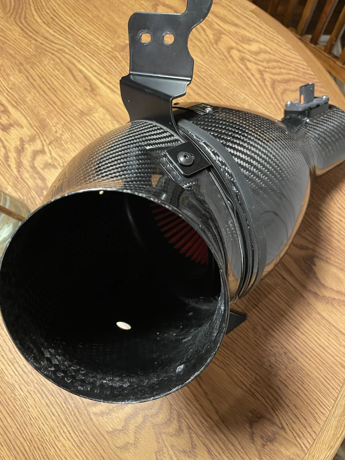

The Eventuri angles downward towards the drain hole when it's installed which you can see in the inside bottom of this picture, so any water that might enter drains before it can go up into the filter.

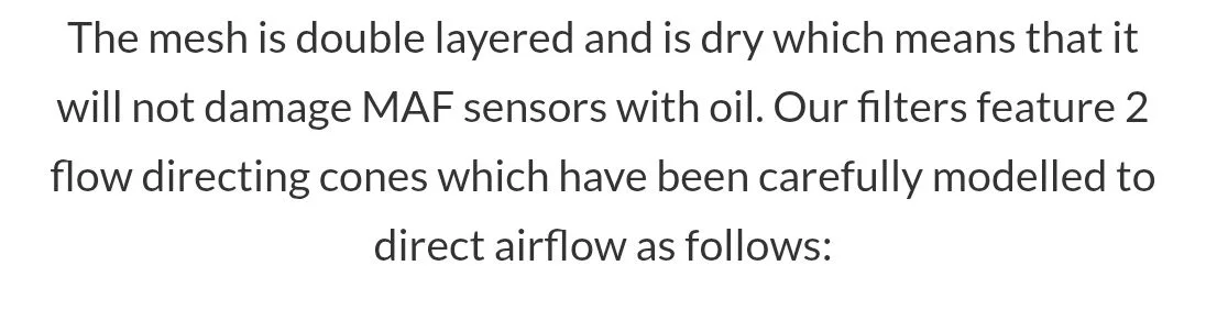

Just to offer a slight correction, the above description text for the Eventuri filter is actually taken from your site's product listing, and in the listing for the full Eventuri kit, it also says the filter is dry. I think they manufacture both types but for the Emira specifically they use the dry type. The confusion lies in the fact that a bottle of oil is included in their filter cleaning kit.
Ahh sorry, I am getting different kits and filters mixed up.
The Eventuri kit does use a dry filter -- (The cleaning kits include oil which isnt used)
