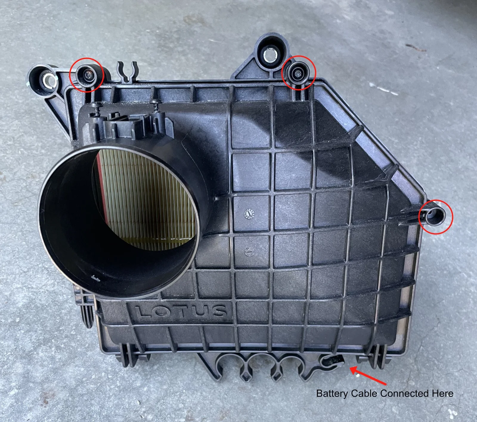

Got the Eventuri installed last night. It was a bear. Took me 2 hours; not because of the Eventuri, but because the factory airbox did NOT want to come out. The battery cable that connects to the engine is routed through a clip/holder on the far end of the lower airbox. It's just out of reach, so it was very hard for me to get it out of the clip so I could remove the airbox. You have to lean over the back of the car to do everything, and it really put a strain on my lower back. If you are younger (I'm 72) it may be easier, but it was a strain for me.
If you have a long (12 inches) or two 6 inch extensions combined, it will be MUCH easier to remove the top left bolt on the airbox. The Eventuri instructions say the 2 bolts at the top of the airbox are 13mm, but mine were 10mm for some reason. I guess Lotus changed those for North America as opposed to the U.K. version?
Below is the factory airbox. The 3 screws circled in red are what you need to remove if you're simply changing the air filter. The front swings out and there are two plastic hinges on the bottom that come loose when you do that. The two large holes on the top left and center are where the mounting bolts are that bolt the airbox to the car. At the bottom I put a red arrow to show where the battery cable goes through. You have to push it towards the front of the car to get it to slide out of that groove. That's what gave me such a hard time. It was tight and did not want to slide out.

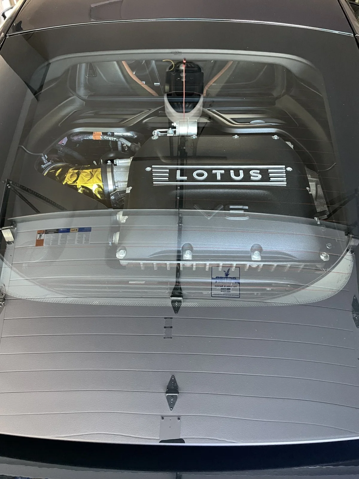

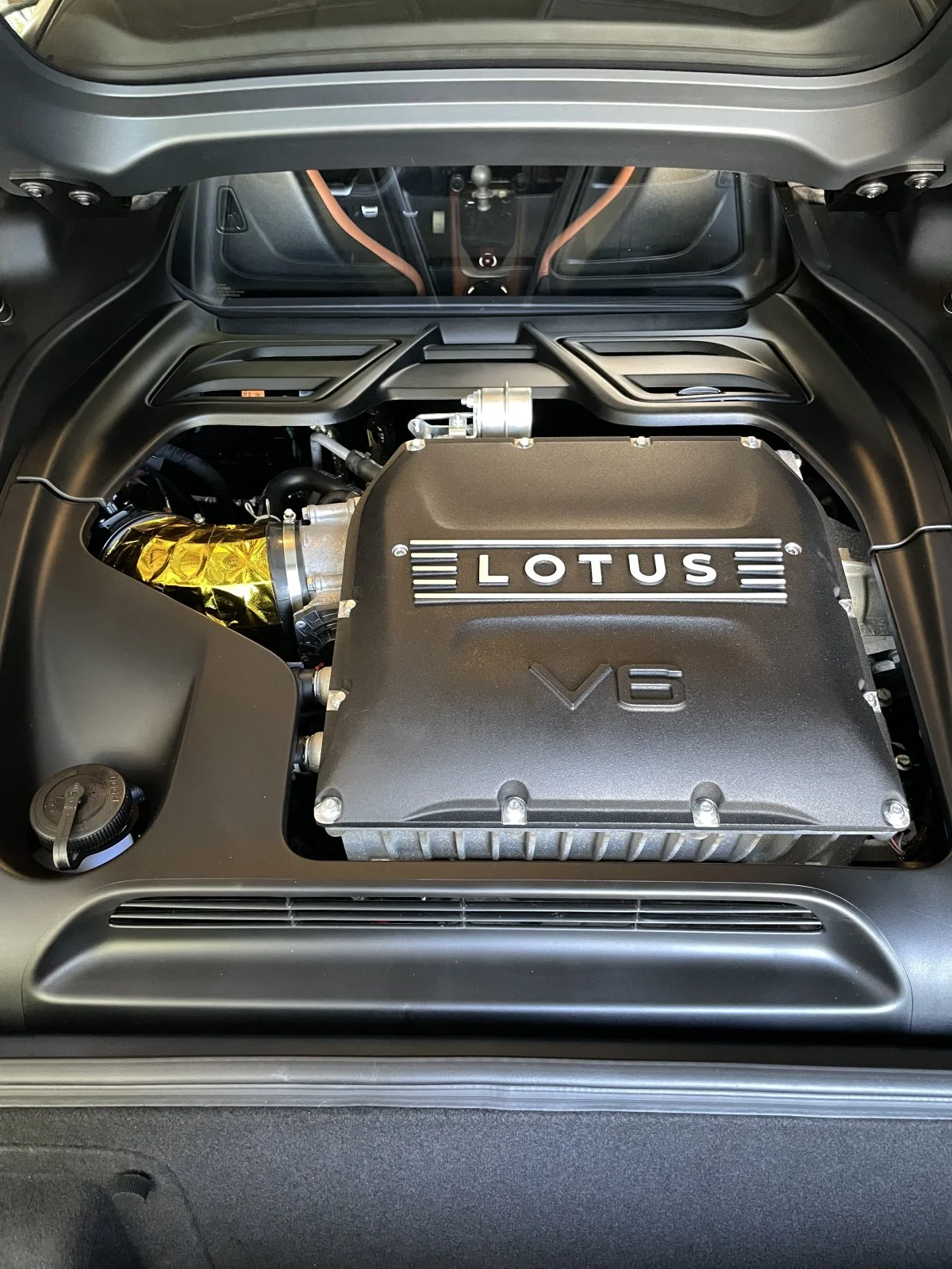

I got some gold heat reflect tape and put it on the Eventuri connector tube. I did it mostly for cosmetics, although obviously it will keep the tube cool. The travel path from the side of the car to the supercharger is so short, I doubt it will make much of a difference for street driving. For those taking their car to the track, it will probably make a bigger difference; especially to help minimize heat-soak after you come off the track. I just like the way it looks. There are a lot of small ridges all over the tube, so it made it a bit difficult to get everything to lay down. I washed the whole tube in dishwashing liquid and let it dry thoroughly before putting the tape on. It stuck to it with no problem. If anybody else is going to do this to their Eventuri tube, I'd recommend using smaller cuts of tape instead of trying to wrap it with long pieces. There's a lot of changes in shape and angle that are just easier to cover with smaller pieces.
Through the rear glass (I don't have the privacy glass) I think it jazzes up the engine compartment nicely.

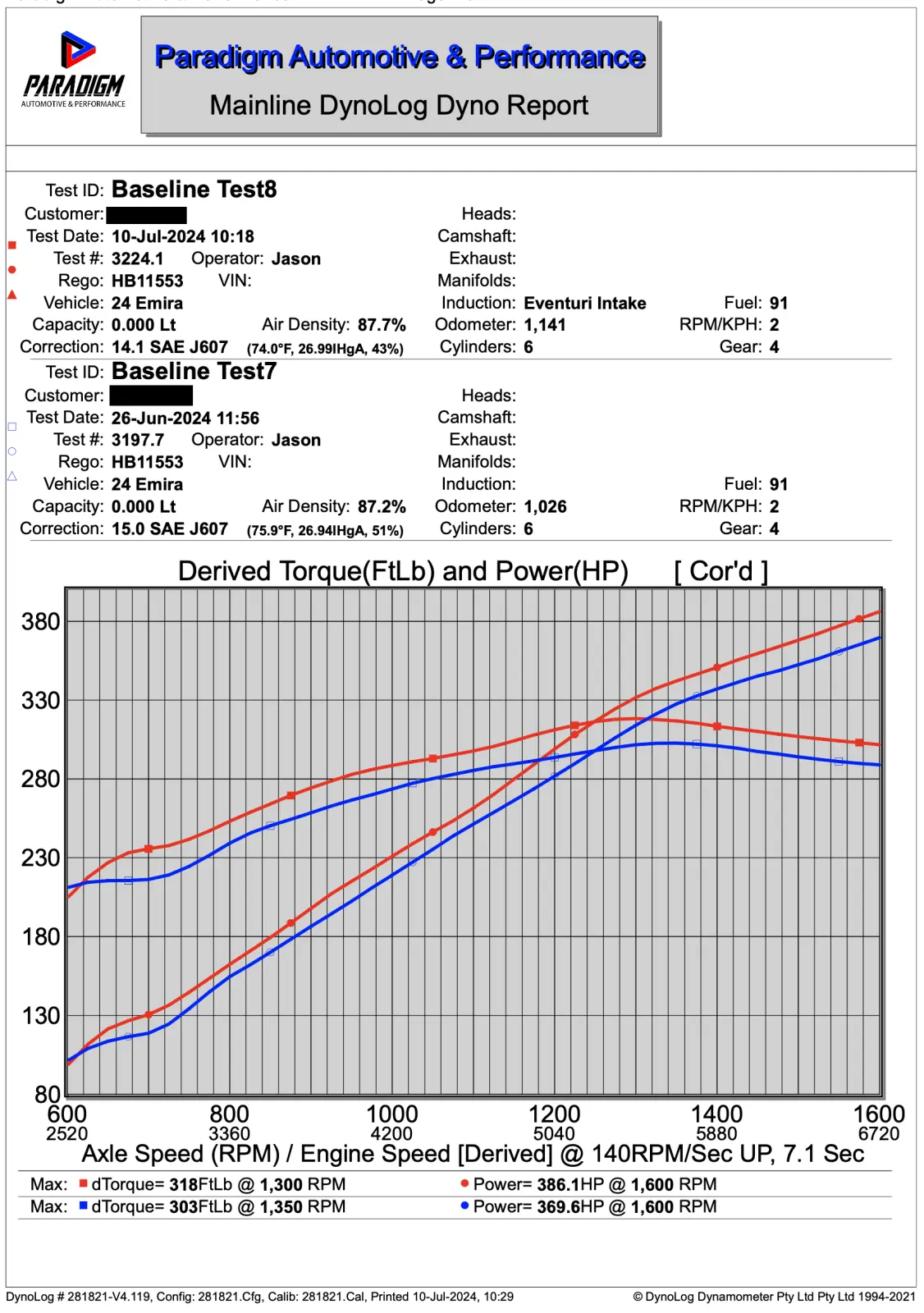

Got the dyno and the results were excellent. The Eventuri delivered as advertised. The only difference between this and the baseline run in blue, was the Eventuri. The car has the full stock exhaust system. What the chart shows is how the car feels. There's a nice lift in torque right away, and the gains are consistent all the way up the rpm scale. Power is now 386.1 hp compared to the baseline which was 369.6 which is a gain of 16.5 hp, and the torque increase is 318 ft lbs compared to the baseline of 303 ft lbs for a gain of 15 ft lbs of torque.

Right now with the gains from the Eventuri, I'm guessing I have about 418 hp at the crank. The dyno shows the power to the rear wheels, which is subject to the drivetrain loss factor, which based on the baseline dyno is 7.6%. So the 16.5 hp the Eventuri added to the rear wheels, minus the drivetrain loss, means it's added about 18 hp. With that new number, my weight to power ratio is now 3,240 lbs / 418 hp = 7.75. I'm guessing the Aerie wheels with the titanium lug bolts will weigh about 24 lbs less than the stock wheels, so that will put my vehicle weight at 3,216 lbs, and improves the weight to power ratio to 7.69.
