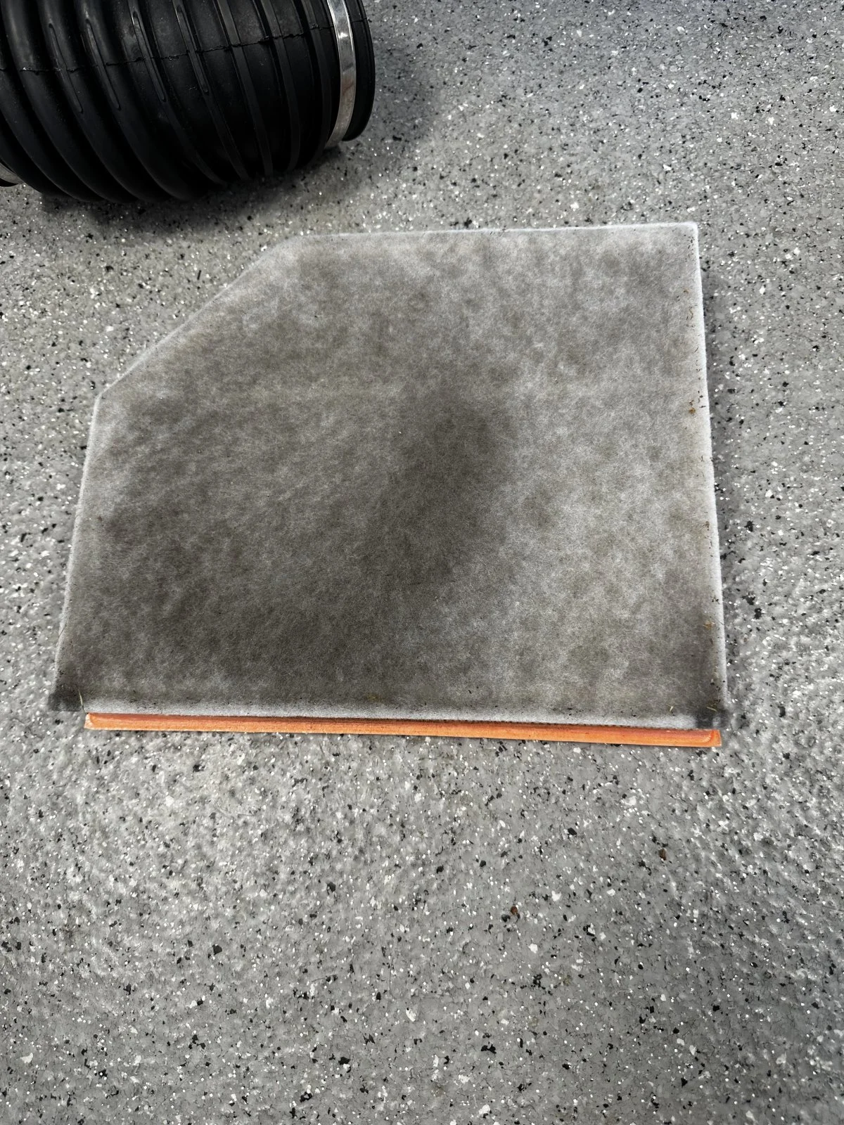

It’s definitely a concern. I was surprised by how much crap was inside the intake box after only a few thousand miles, including plenty of leaves.
Agreed - here’s mine after 3600miles, no leaves though 😉

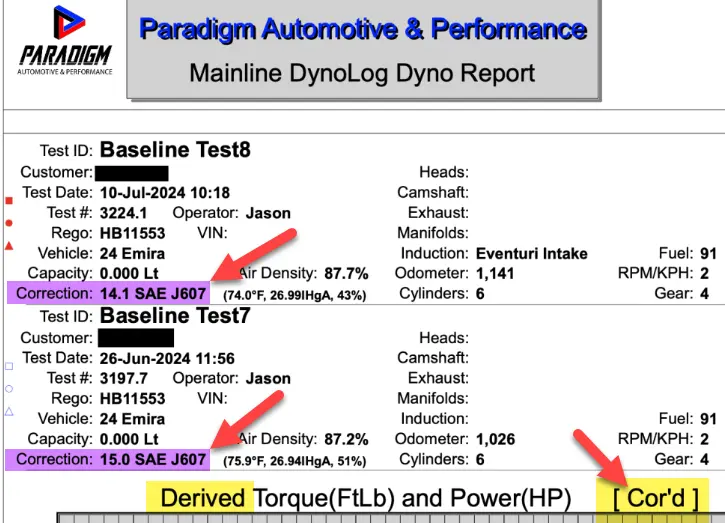

Can we get the uncorrected dyno charts please? Your two pulls are showing different SAE correction factors, which is unusual considering the weather is almost identical. It may be automated based on a weather station "accessory" with the dyno, but it's hard to say whether the correction factor is correct without knowing if it's been calibrated recently.
To avoid doubt, there should be a way to switch the view into uncorrected mode, which would make the absolute values less "accurate" but increase the fidelity of the comparison between the two runs, which is what most of us care about.
The weather was NOT the same. For the baseline run it was raining that day, and I literally drove through the rain to the dyno shop. Temps were in the high 70's. Today we're in a heat wave. It's currently 106 and this morning it was already 91 when I had my dyno run.
Well something weird is going on with their sensor pack then, because the two runs show a nearly identical barometric pressure. That's super unlikely in the scenario you've described.
If the dyno is indoors I can see the ambient temperature being almost the same, but having the same barometric pressure in two very different weather conditions would be way unusual. Is the dyno in an air conditioned space? Or was it warm in there today?
Also, if somehow they are coincidentally both the same barometric pressure, 26.99 and 26.94 InHg Absolute are both super low. Are you at altitude? I would expect a low value on a rainy/stormy day but not on a hot clear one. Even if you're somewhere high like Denver, I'd expect the clear day value to be substantially higher than that.

Isn't the difference just the SAE factor though?
That's what I'm trying to determine. The SAE correction should normalize the runs to the same values regardless of weather. But in this case the numbers raise questions.

if the atmospheric numbers are to be believed than they are so similar that the relative gains hold up. Plugged them into a dyno correction calc to confirm. @Porter rightly questions the condition inputs based on the actual weather observed.
Yeah agreed - to answer my own question, if the atmospheric numbers were measured correctly then the SAE change should be fine. They use the older formula, so my calculator won't be exact, but using the newer J1349, you get:
Original test: SAE adjuted gives 369 wheel hp, which calculates as 330hp uncorrected (and 410 hp at the flywheel)
So if you take the same 330 uncorrected hp and use the new SAE, you get 366 wheel and 407 fly.
They all seem a bit high, but the correction makes no real difference by my maths! So looks like a good upgrade if it sounds OK and isn't sucking sand into the engine!

I think it could be mostly brake dust when you look at the photos of that used air filter element above...
And one comment to the correction factors. I was told by someone who is dynoing a lot of cars, that he only compares uncorrected data because most cars with forced induction factor in atmospheric pressure and temperature.
For example on a mountain with less atmospheric pressure the ECU runs a little more boost to get the demanded power.
So these correction factors really made sense in times of mostly naturally aspirated engines, where these different conditions really had a huge impact and could not be compensated.
Ooooh, very good point! That would explain the black soot looking dust. I wonder if this additional mat was added specifically to filter out brake dust like this.
I don't know how to run a dyno, so I just trusted the operator to know what he was doing. It was the same guy, same dyno, so I figured the results would be representative of the actual gains the Eventuri provided. We're at an altitude a little over 2,700 ft.
If it is fine brake dust particles, would the Eventuri (or any other high flow filter) remove these before entering the engine?
I don't think it's brake dust. You aren't generating that unless you're stopping or slowing down, and based on how it clings to the wheels and brake calipers, I don't see it making it's way up the side of the car and into the intake. To me that looks more like dirty water spray coming off the tires from the road when it has rained or is raining. If you're driving through overspray coming from the vehicles in front of you, that could possibly make it's way into the intakes on the side. That could possibly be why Lotus has that gauze on there in the first place, to keep moisture or flat out water from making it's way through the filter and onto the MAF sensor.
I have been a dyno operator, which is the root of my questioning. I am not questioning that you saw gains from the intake! Far from it. It looks like a very legit product.
What I'm scratching my head about is the slight disconnect in the displayed data between the calculated/applied correction factor and the indicated weather conditions. If I were the dyno operator I would want to sanity check my numbers by pulling up the two run files again, and comparing them uncorrected.
