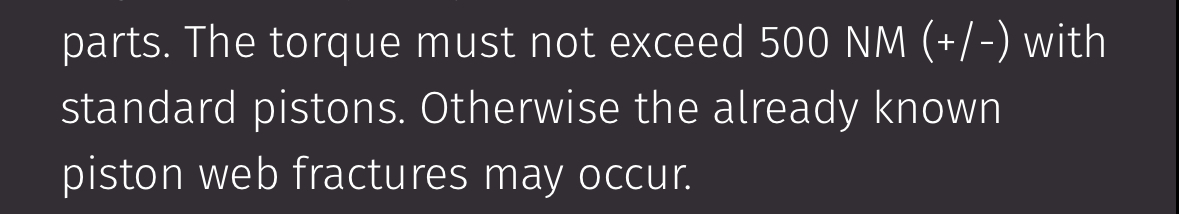

Would be interested for your thoughts on the additive effects of these mods on torque. The Jubu 440 ECU kit has been optimised to max out at 500Nm which I gather is the limit for the standard Toyota V6 engine before strengthened parts such as forged pistons and conrods are needed. Would a Jubu 440 ECU plus a 3rd cat delete and Eventuri intake push the torque above 500Nm? Or put another way, to avoid expensive engine upgrades (or a blown engine) would the Jubu ECU programming have to be modified to reduce torque to compensate for any increase provided by the other modifications?
I haven't looked at the specs of the Jubu 440 tune, but I'd be very surprised if it's able to deliver that much more torque with only a 40 hp increase in power. 500 Nm translates to about 368 ft lbs of torque which I believe is the limit for the transmission more than the engine.. My car stock showed only 303 ft lbs, and the Eventuri took it up to 318 which is still well under the limit of 368. I don't think the 3rd cat delete will have any effect on torque, just sound mostly. I'll have to look up Jubu's tune and see what they're claiming.
Okay, after having just looked at their website, they're claiming quite a dramatic increase in torque. An additional 100 Nm is 73 ft lbs. They're saying that it's the engine that has the limit, but I was under the impression it's the manual trans. Maybe they're thinking of the auto trans? If you're going to get their tune, I would definitely recommend telling them about the Eventuri as that would push things over the limit they claim the stock engine has. Obviously this would void your warranty, and undoubtedly blow your emissions compliance out the window as well. There's also a possibility your insurance company might cancel your policy. It certainly has interesting numbers though.

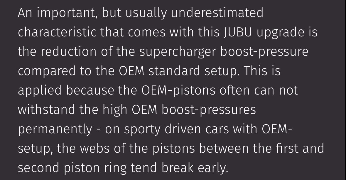

Jubu actually limits torque to 500nm on all the packages that don’t include a built engine. Both the 440 and 460 tunes have 500nm.
The 460 package actually comes with a smaller pulley to lower boost pressure
The 460 package actually comes with a smaller pulley to power boost pressure
I wonder if that comment about the factory boost pressure applies to the Emira, as opposed to the Evoras which were 416 to 430 hp?

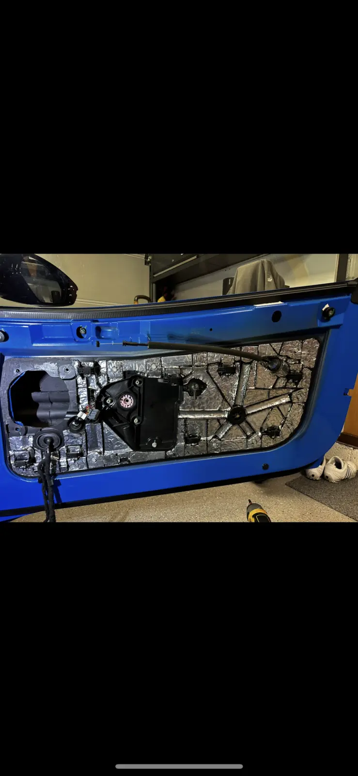

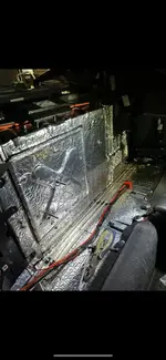

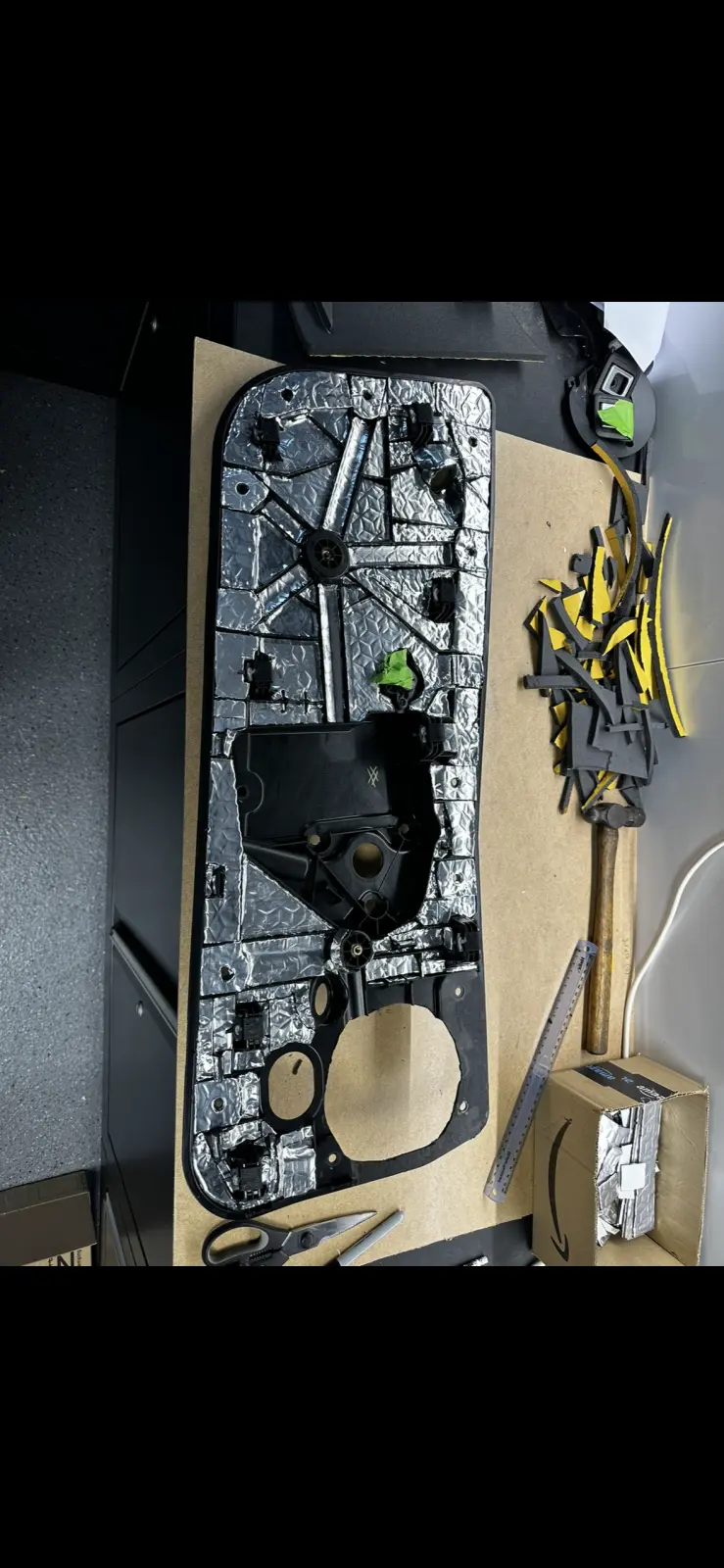

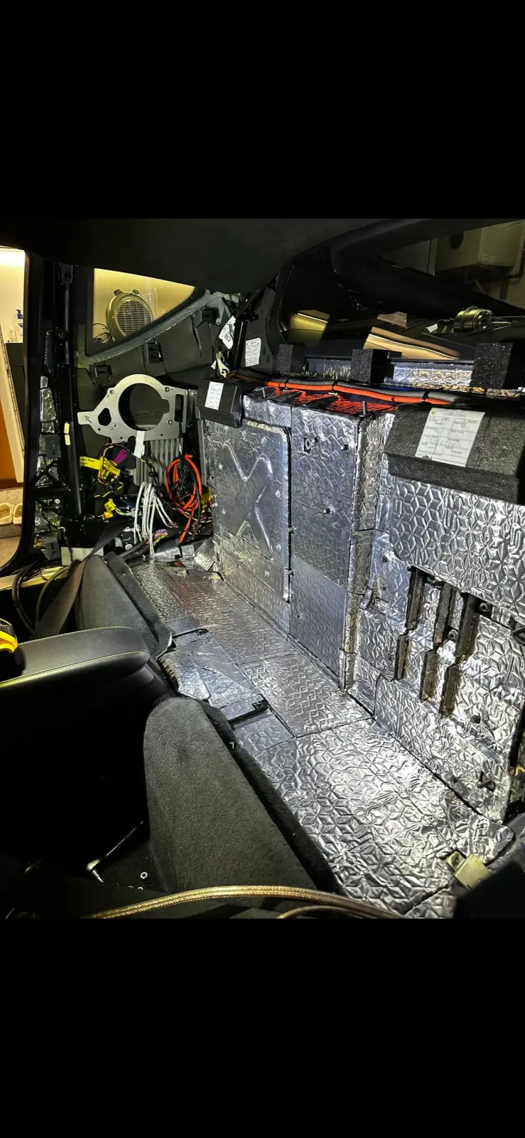

All have installed Skinz sound deadening to both doors and the whole of the rear compartment / engine bulkhead, which helps massively with holding a conversation with the passenger, phone calls, no more stone flicking noise, listening to music on the motorways etc, if this helps you?
Was it hard to do the doors and was the bulkhead panel fitted in the engine bay or cabin?
Not hard, just time consuming to cut everything to shape.
I stripped out the rear cabin trims to install everything back there. (See attached pics).
It took me around 10 days to do everything neatly and without any rushing.
A box of Skinz is around £120 in the UK.
