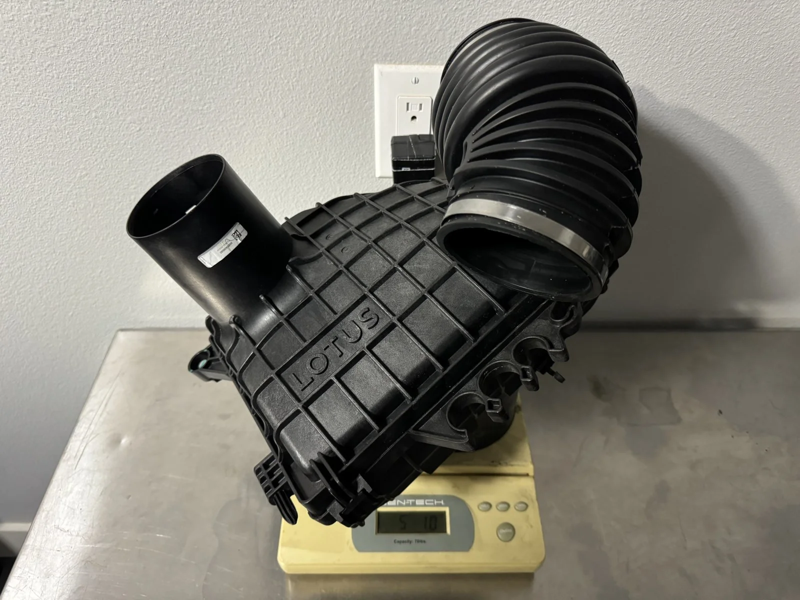

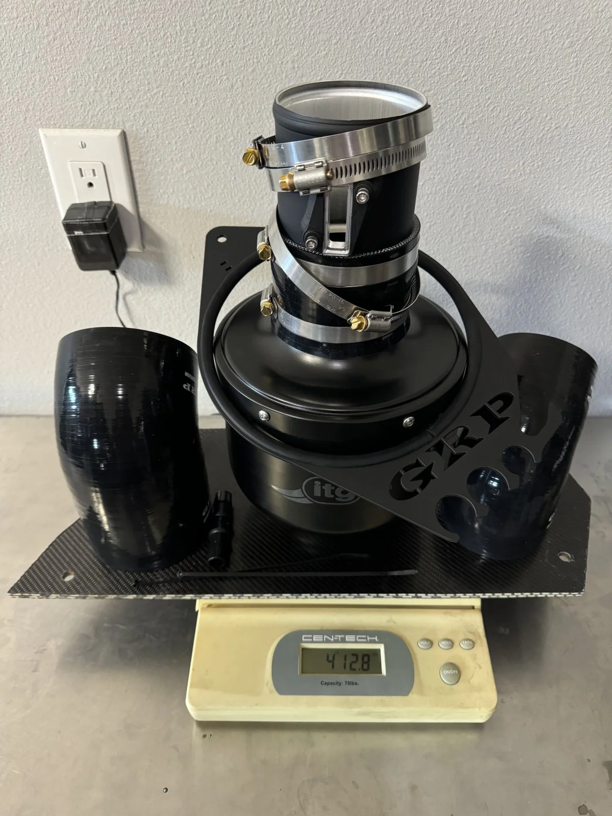

is there a weight difference or have I missed that?

Yeah when I weighed it compared to the factory airbox, the Eventuri is 1/2 lb lighter.

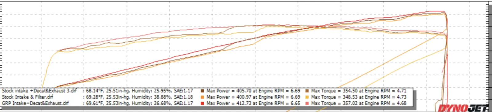

@GRP any update on the dyno tests for the exhaust? I'd really like to know if the 3rd cat delete does anything for increasing torque.

While we wait for the more detailed results from Greg on his follow up dyno testing, the chart below shows his dyno results with the exhaust and decat with both the stock intake and the new GRP intake. The exhaust and decat alone appear to add about 5 hp and 6 ft lbs of torque. This comes from hs listing for the new intake.

The only thing that looks like it's making any actual difference is the intake up to the point where it looks like the ECU is making a sudden correction of some kind. I'm guessing that's around 4k rpm? But you can also see once that correction is made, there's no practical difference between stock and the mods. That has to be the ECU not having time to truly adjust to the changes.

Yeah, the gains are pretty modest and favor the intake based upon the charts we've seen and I don't know how much of an adjustment the factory ECU could make over time. My take is that a tune would be required to take full advantage of the bolt-ons and that would open up a lot of additional possibilities. It also adds a fair amount of cost and inconvenience of course.

It would be good to see what either make after say 500 miles.
My previous Eventuri made 8hp out the box but 17hp on the same set up on the next base run I did 1000 miles later before swapping the turbo.
Hearing owners saying they had the biggest gains in lower rpm 2nd and third gear it’s a pity that can’t really be measured on the rolling roads.
I fully agree on a tune to get the best out of the air intakes. I believe the JUBU 440 uses a penance drop in filter so doubt it will make much of a difference.
The difference from OEM all depends on whether restrictions hold it back, or it’s all minimal.
When someone does a tune that requires a pulley change for increased boost they will come into their own but I’m now sure we will see that without having to have a built engine. It is possible to have a 500hp tune with the torque limited to 500 but probably not the call for it.

Thanks for the videos and this is my first post as well as have been watching from the side. After all that and the excitement did you end up checking the weight difference?

Thanks for reminding me to post the weights. The GRP intake saves about 4 oz. :)
