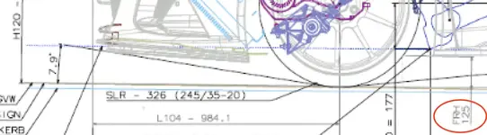

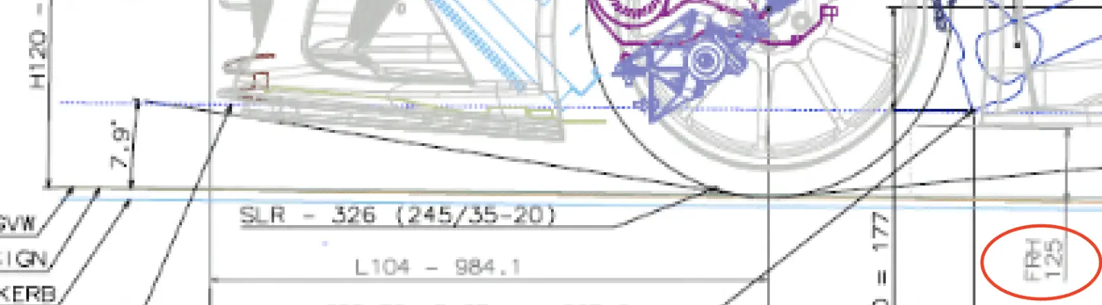

Squinting at the diagram (in the main document) on that linked thread, it does seem perilously close to the the regulated maximum speed bump height in the UK (100mm) - the lowest part of the body work ahead of the front wheel looks a little lower than the main sill, which I'm reading as 125mm (somebody correct me if I'm wrong)

Thanks for the references. So it looks to be 125mm at the very front with the lowest point (at the back end of the 7.9 degree slope) somewhere around 100mm? Could be tricky. Do we know what the side clearances are?

To clarify my earlier reply - I was saying the main sill looks to be 125mm, but the front (and rear) skirt looks to go a bit lower than that 😬 ... I'm far too lazy to calculate it properly, but my eyeballs say closer to 100mm of clearance just ahead of the front wheel. I hope I'm wrong.

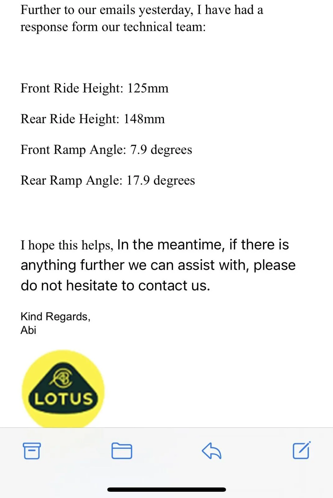

Response from Lotus:
Appreciate the fact-finding effort, although the info from Lotus is still missing fidelity. I recognize the very front is 125mm but what about the lowest point of the front, at the end of the 7.9 degree slope near the front wheels? 100mm or less could be tricky with my driveway. It will also put me into grandma mode looking for every road imperfection (instead of looking down the road like a good driver should). A previous car of mine had 85mm of front clearance and it killed the experience.

Is it ground clearance of 125mm at the lowest point? which is the only way any manufacturer states i ever in the history of automobiles? Or it is 125 at the front and then descends on that angle to a lower measurement? which no other manufacturer on earth would rationally state? Hoping for sanity and sensibility in the 125mm number

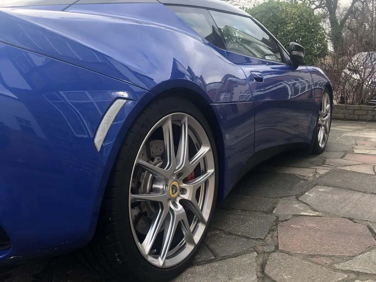

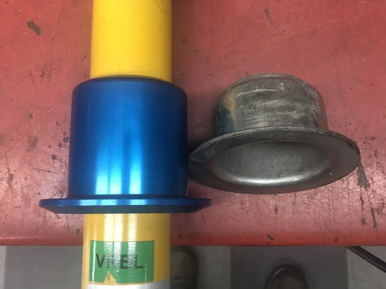

I tried the BOE lowering cups on my Evora. 19mm drop.
Looks great but you obviously have to be more careful over bumps and steep driveways, etc.
Handing was fine but I wasn’t pushing the outer limits.
They might fit the Emira as in the photos I’ve seen the dampers look very similar.
View attachment 2696View attachment 2697
I can't believe I've not come across the term "lowering cups" before today! Am I right in thinking this would mean ride compliance and handling would be similar to standard (as spring and damping rates aren't changed), but just... lower? Interesting... :unsure:
EDIT: I suppose this means you just meet Mr Bump Stop a lot if you get too frisky.
