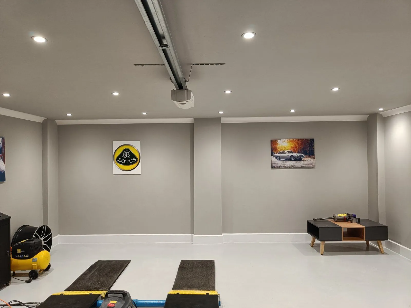

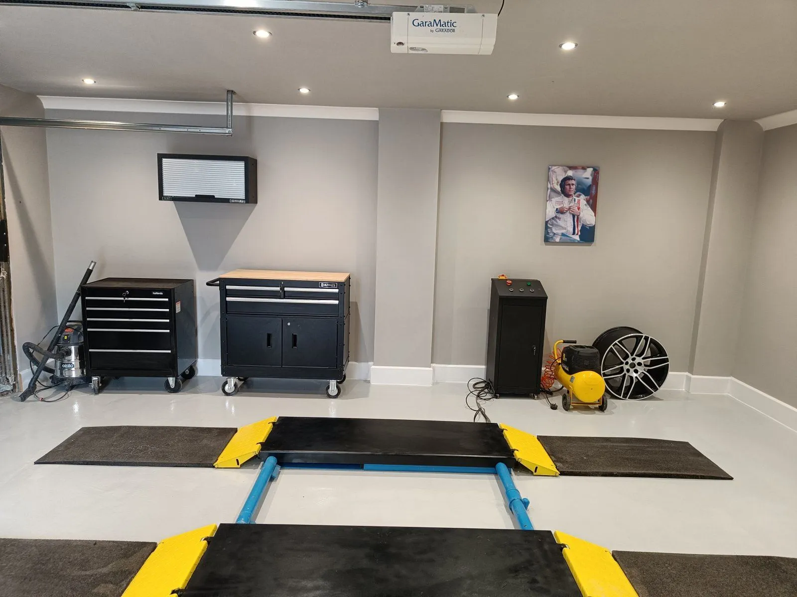

I've pretty much finished the garage for the Emira.
Involved building a new storage shed to get the crap out the garage. Then:
Dryline and insulate
Plaster and paint
Install spot lights and power sockets
Refloat floor and paint with epoxy
Add coving and skirting
Heating

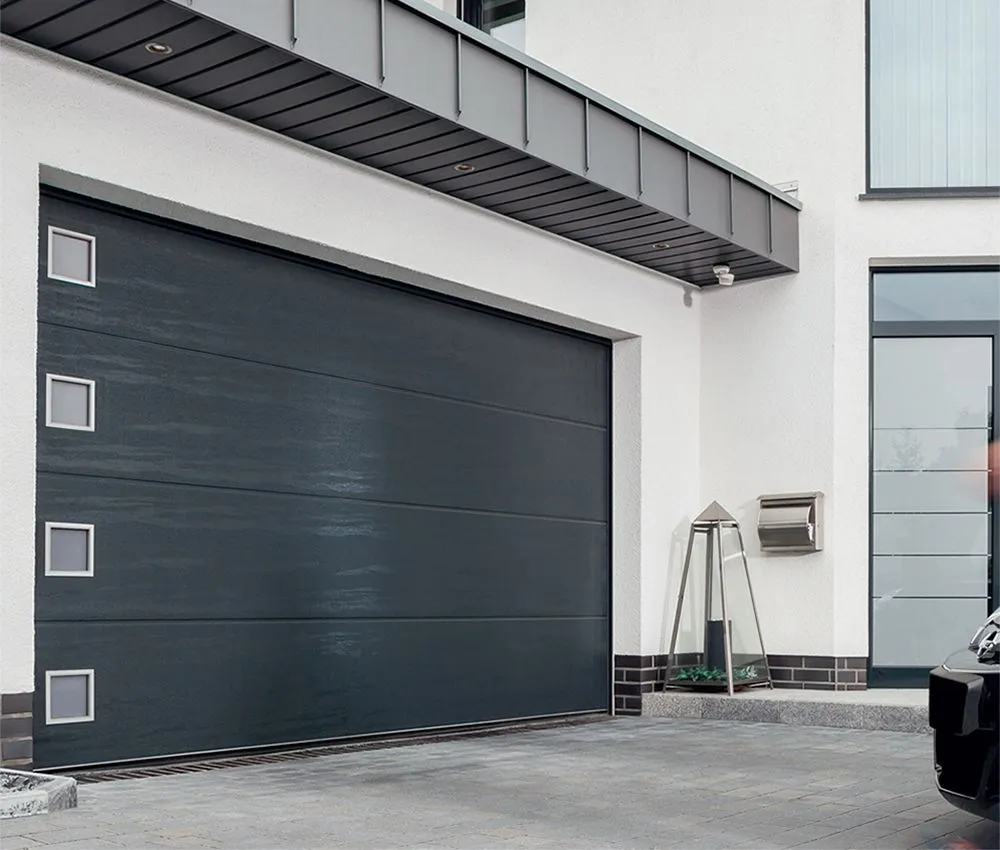

New insulated garage door with Bluetooth
Very nice!! What colour of Emira will live in that garage?
I like the low profile lift, what brand is it?

I built my own house so i did a lot of the work myself. The most expensive bit (which you can't see as it's still not here) is the insulated garage door £3K fitted the rest of the project was about 3k so all in 6K, not super cheap but it's like having an extra large room in your house. I've got a sofa and small beer fridge to install.

Yep got the self build scars!
Floor make up:
Self leveling Screed over the slab so you get a smooth finish.
Then 2 coats of

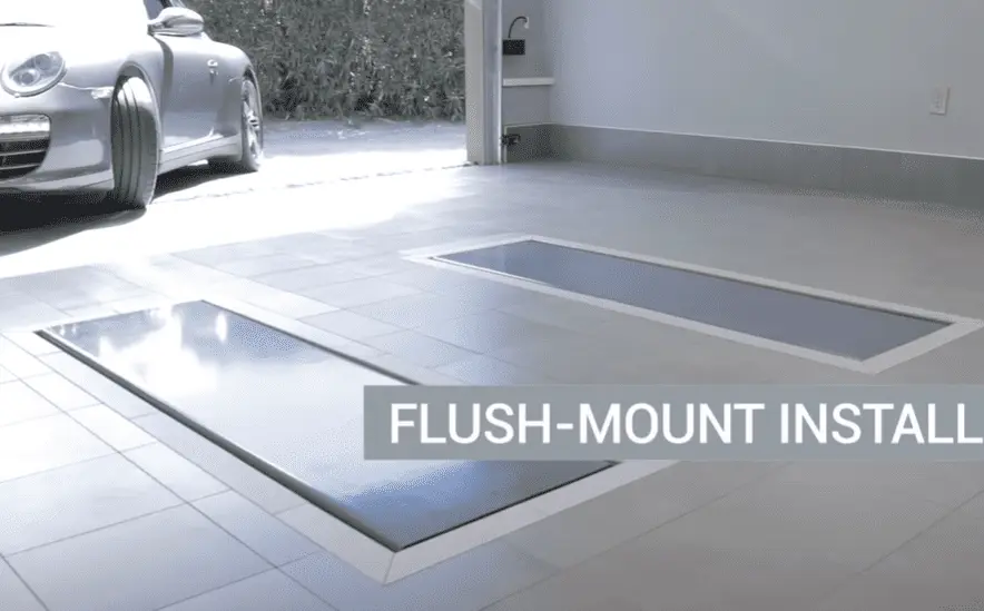

This is fantastic. I'm about to build similarly but in a 1-bay single car size, 12'x20'. It should be similarly appointed/finished, but with the workbench at the narrow end, a vaulted ceiling, and carriage doors (dual 4', for an 8'w x 7'h opening) at the other end. I'll be doing a lot of the finish work myself, and likely about half of the construction. The plan at the moment is to do SIP panel walls and roof, with a gluelam ridge beam for support to get the clear span height. The high insulation value of the panels and doors should allow me to keep it well climate controlled with a bar-style mini-split HVAC on the wall.
The size and clearances will be tight but I hope it will be a high quality result, sort of a "jewel box" miniature workshop. I'm planning to build recesses into (and conduit within) the concrete slab for a similar vehicle lift to yours, but mounted completely flush if possible. The floors will eventually be finished in ultra-durable non-slip porcelain tile, and the planning for the lift recesses will take that finished surface height into account. I hope the result will look something like this:
For more views of ^^ that lift installation, see this vid on YouTube.
[edit] to clarify - I can't justify/afford the lift yet. :ROFLMAO: So I'm going to build the holes in the floor and fill them with reinforced plywood boxes to walk/drive over until I can rationalize the additional expense. 💸
