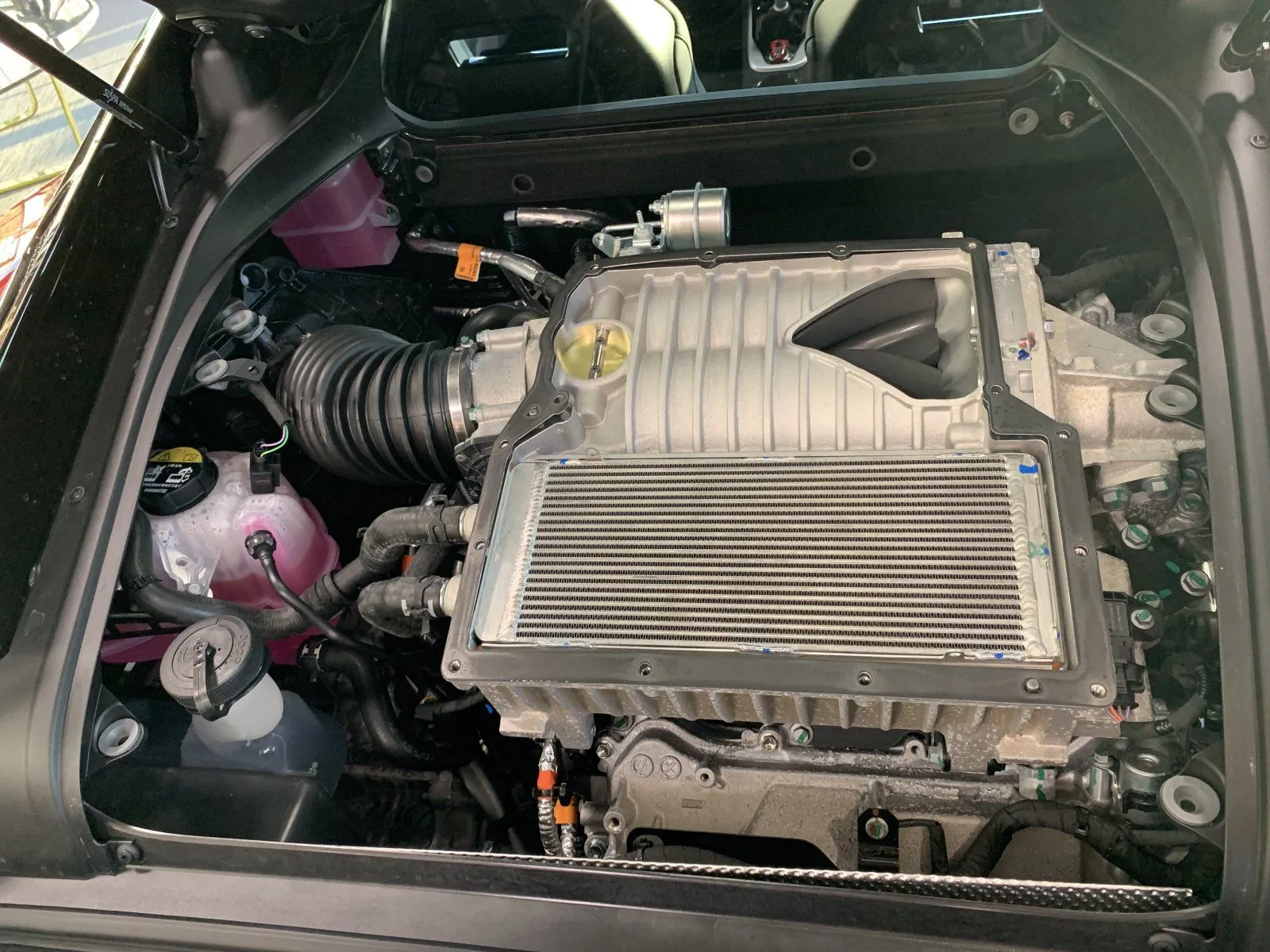

Should we add engine block oxidation to the list? It seems like every one I'm seeing has some pretty severe oxidation/corrosion on the aluminum block already. I'm starting to think these cars were sitting outside in the elements for a very long time before being delivered. I believe this is mostly cosmetic, but still unsightly on a brand new vehicle. :oops:

Same issue with mine

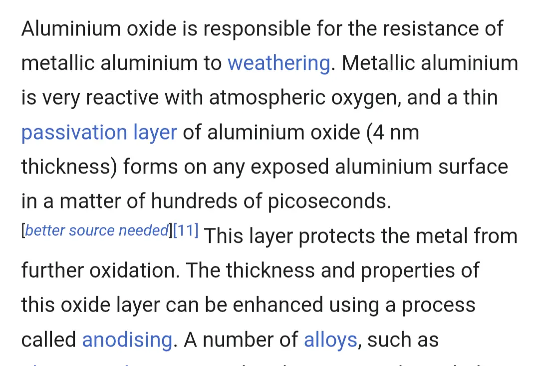

That's aluminum oxide (Al²O³), and while it's technically a form of corrosion it's actually benign and protective. Once the layer forms it prevents further exposure of the underlying metal to the elements.
It's very common on cast aluminum engines unless they've been coated with something. Super common on Subarus, for example. Purely cosmetic, and there's a solution you can spray on to clean it off but it's typically not recommended unless you are going to coat it regularly with some type of light protective oil.
It does need to be removed prior to any paint or welding on an aluminum part, but that's an uncommon scenario on these particular parts.

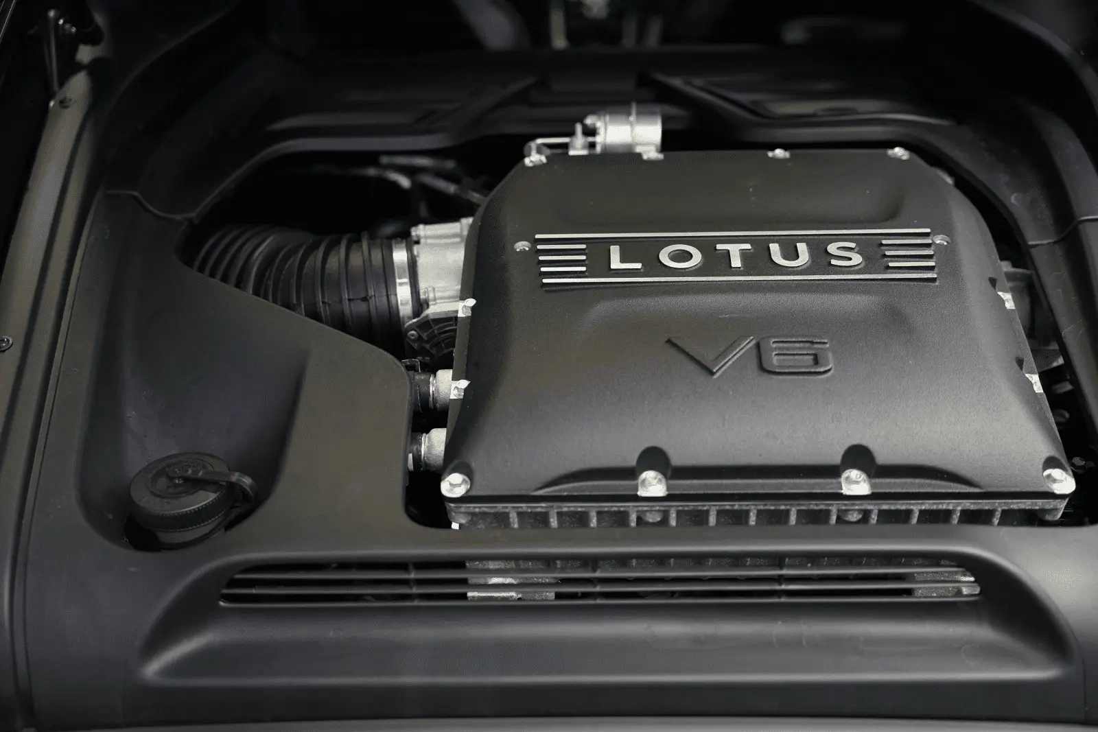

The oxidisation in question here is on the block/supercharger, not the top cover.
As Porter pointed out, is quite normal... Is actually one of the reasons I have spec'd dark tinted windows, as all aluminium components do this unless painted, anodised or treated in some way.
