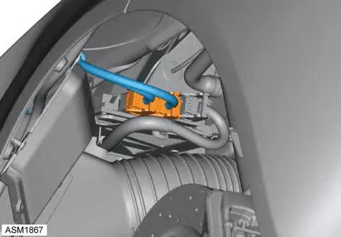

There are reports of several water damaged ECUs as they sit under the rear wheel well
The Engine Control Module sits in the left side of the engine bay tucked forward of and above the airbox inlet. It's just easiest to access for removal through the wheel well once the wheel liner has been removed. That area is not exposed to water spray in any normal condition and I believe it's tucked away in that location specifically to avoid that during (for example) spray wash of the engine compartment.
The module unit itself should be weather sealed as most ECMs are nowadays, and should not be particularly vulnerable to moisture. Not sure about the harness connectors, but most modern ones in engine bays like this are usually gasketed pretty well.
View from wheelwell with fender liner removed, showing location above and forward of the air inlet tube:
The ECM is visible in this angle of the left side of the engine bay, above and behind the airbox (air filter housing):
Here's the same engine bay view with the airbox itself removed, so you can see the context.
Hope this helps. The ECM issue that some people have experienced is almost certainly not a result of being located in a "weird" place that exposes it to weather... it's located there because it's a mid-engine car and that's where the engine is.
Tons of front engine cars have ECM modules in the wing area above and behind the wheel arches in the fender-meets-cowl space, which is very similar to this in exposure.

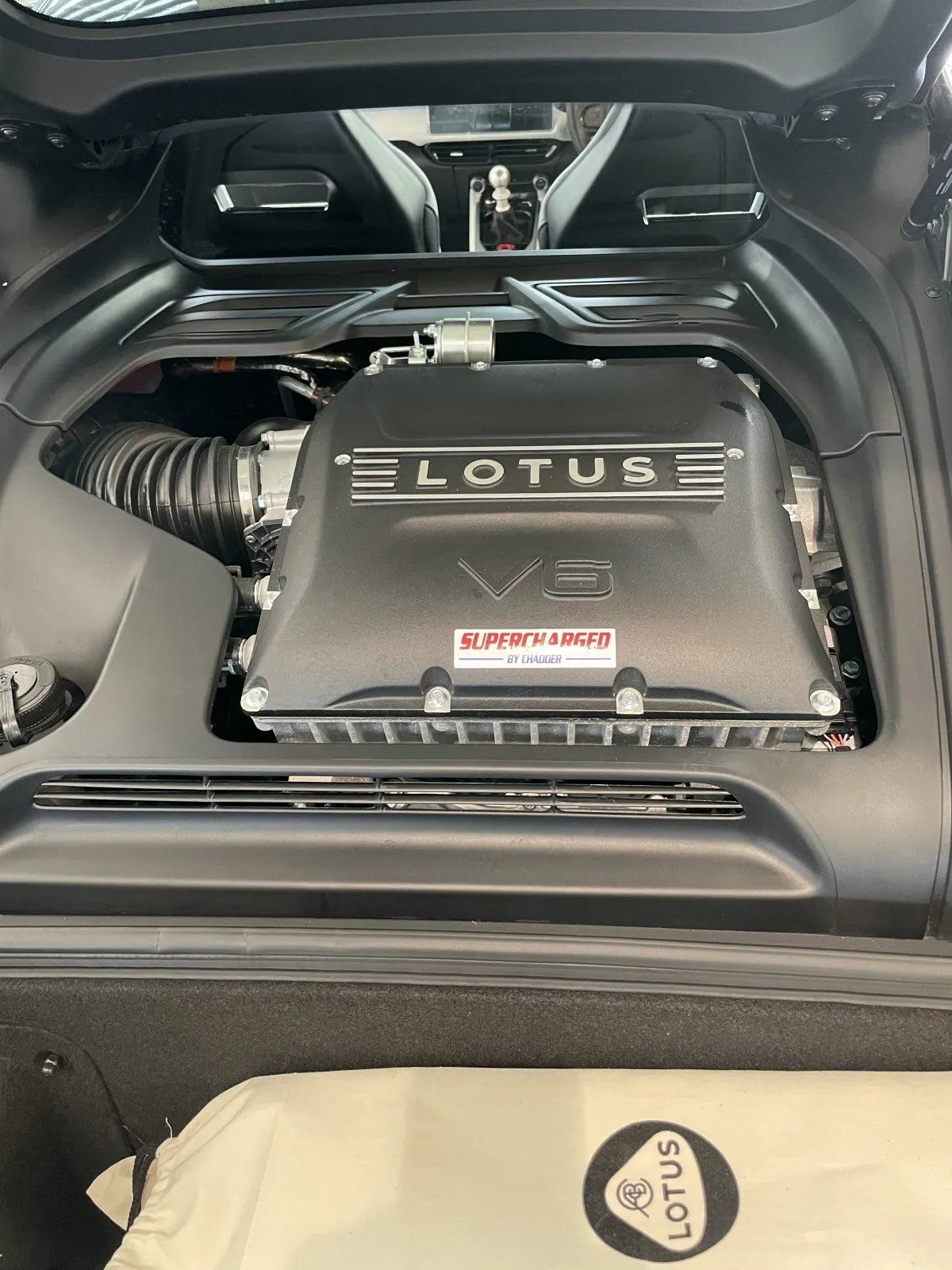

Should we add engine block oxidation to the list? It seems like every one I'm seeing has some pretty severe oxidation/corrosion on the aluminum block already. I'm starting to think these cars were sitting outside in the elements for a very long time before being delivered. I believe this is mostly cosmetic, but still unsightly on a brand new vehicle. :oops:

Mines like this too. I did wonder if I can polish this using a copper wire brush or something.
