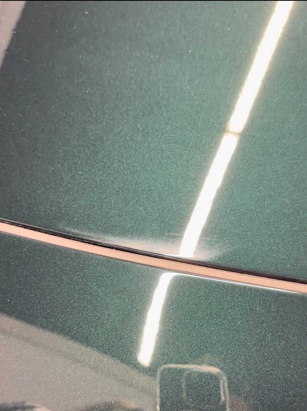

I would STRONGLY advise no Emira owners to have home delivery. The car must be inspected under strong showroom lights or with a detailer light gun. My car had a number of issues ... small scratches, paint swirls, machine sanding marks / overburn, polishing dust between film etc.
I rejected the car initially and Lotus had to take it back to the bodyshop and repair. However, even then it still wasn't great. My detailer who applied PPF film told me he had to effectively do a "used car detail" paint correction ... he was shocked at the quality and also how soft the paint is.
Sanding mark on bonnet …
