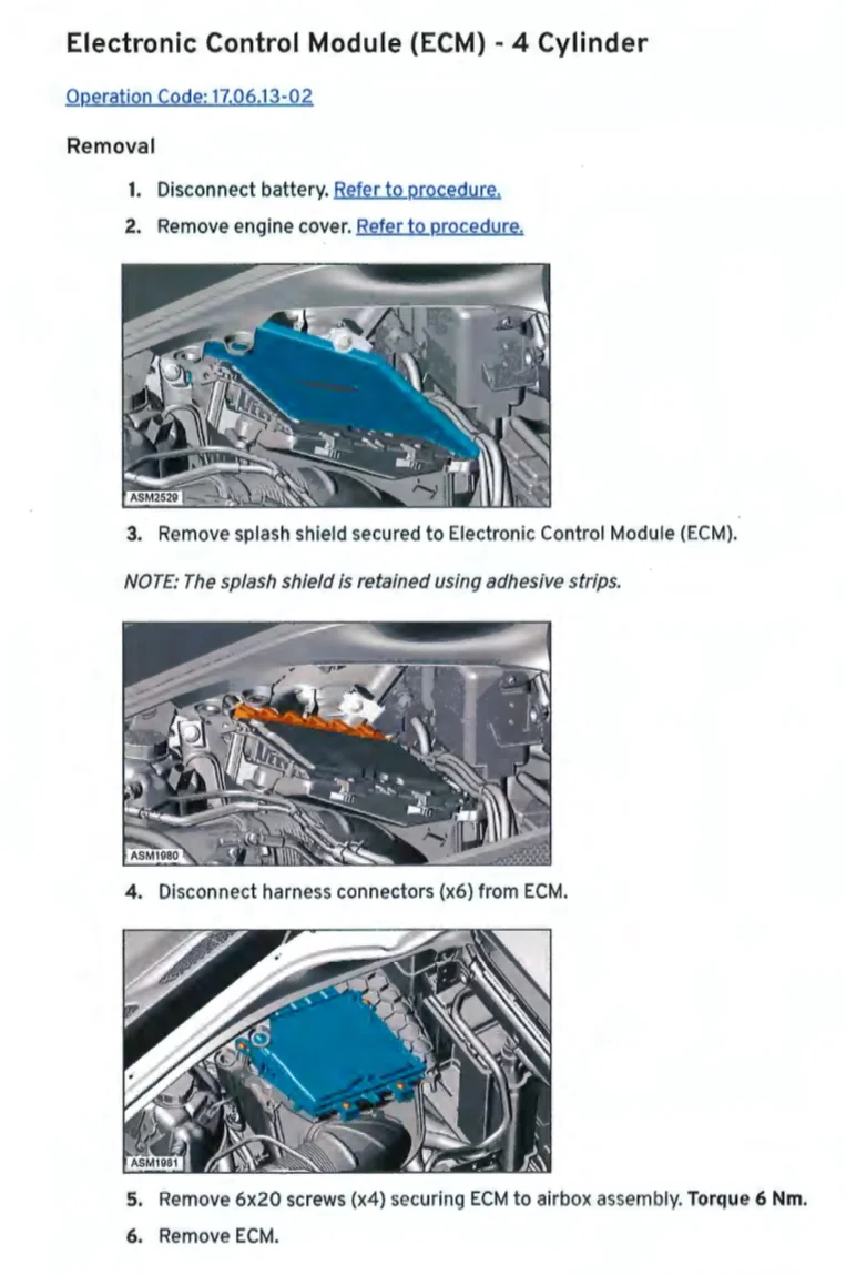

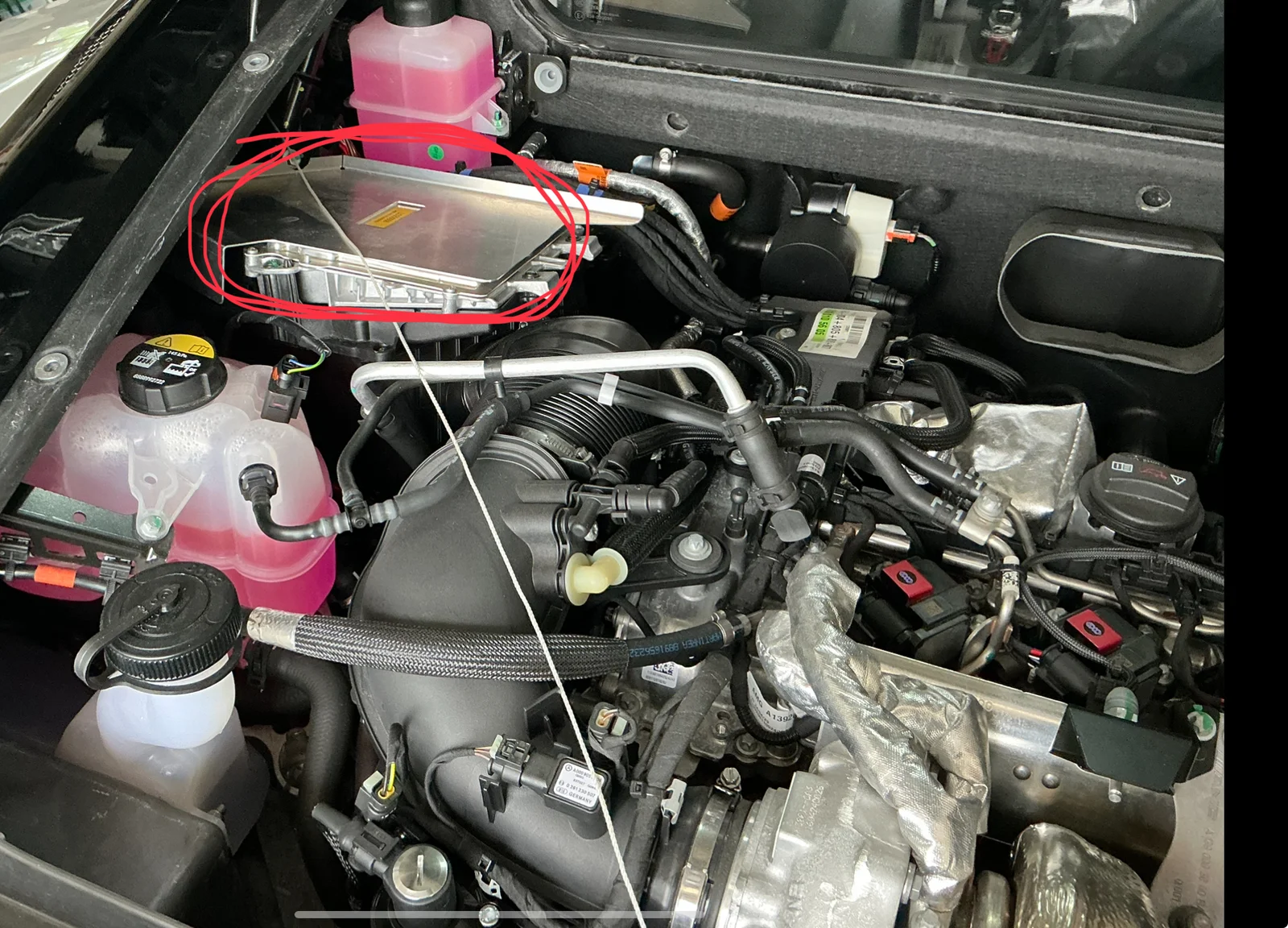

Where exactly is the ECU on the i4 to remove - is the location the same as V6? Thanks
if you open the rear hatch, its the big shiny silver rectangle with many black wires on it. Right at the top under the cover. Super easy to get to
Specifically, top left corner and sitting on top of the air filter. It actually has to be removed (unscrewed and set to the side really) to swap out the air filter.
