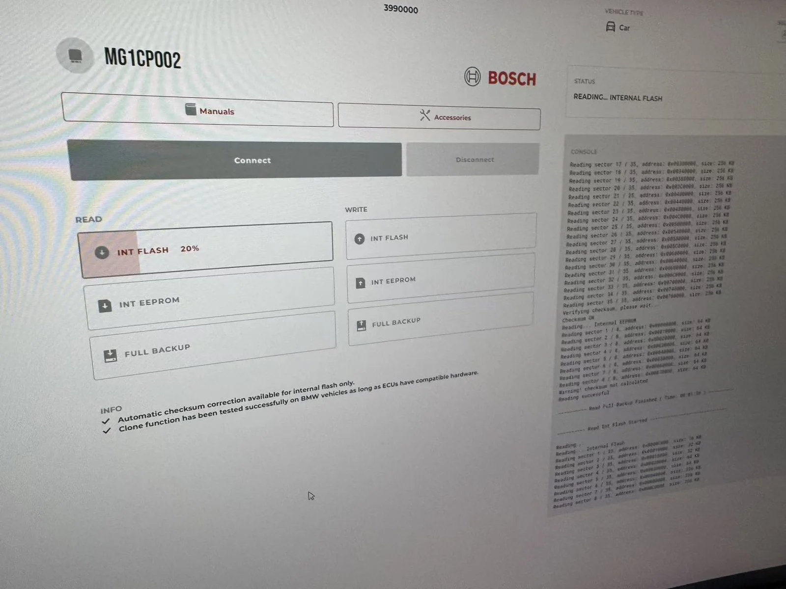

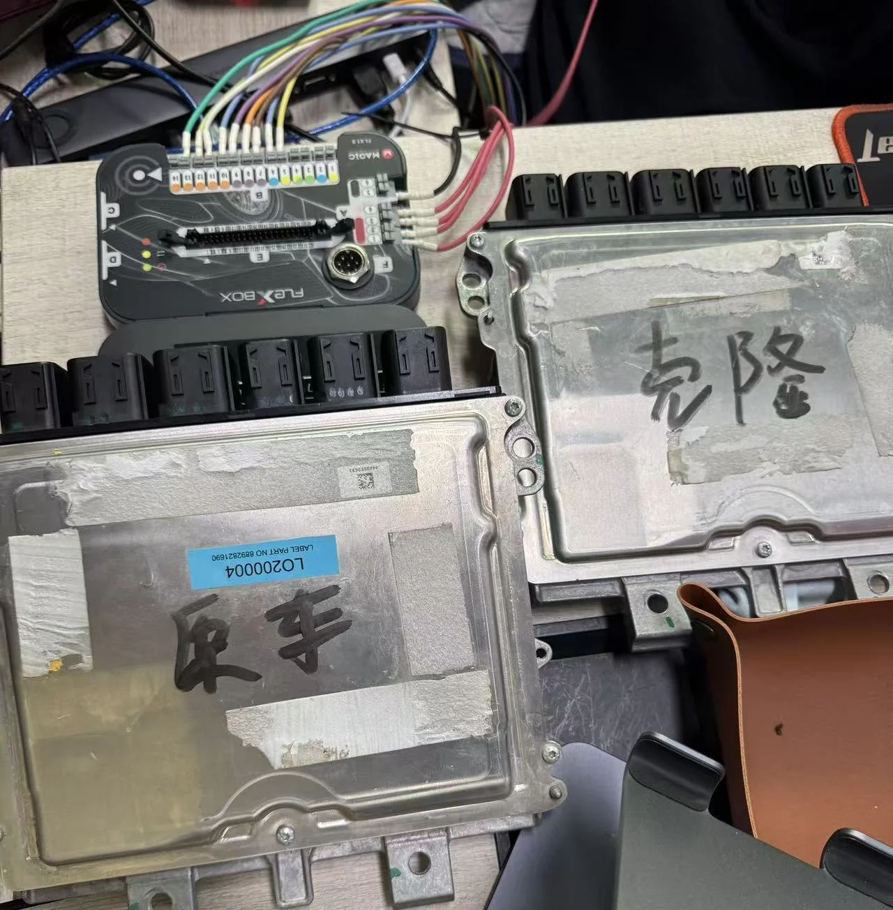

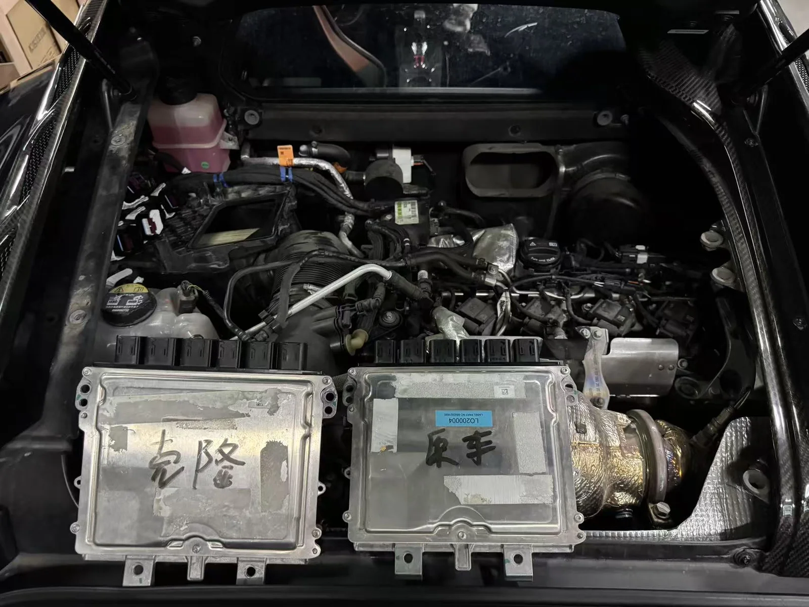

So let’s get the record straight, Emira’s ECU has not been unlocked for direct tuning. Tuners in China have tried to crack the lock for 2 years, and even sent the ECU to other part of the world and came back with no luck. However, Ryan @Boomgear in China came up with a different approach. He managed to clone (this part is unlocked for data transfer and conversion) the Emira ECU onto an older version of the MB M139 ECU, one that has no lock to begin with. So for anyone who wants to go this route, happy hunting on your local salvage yard.

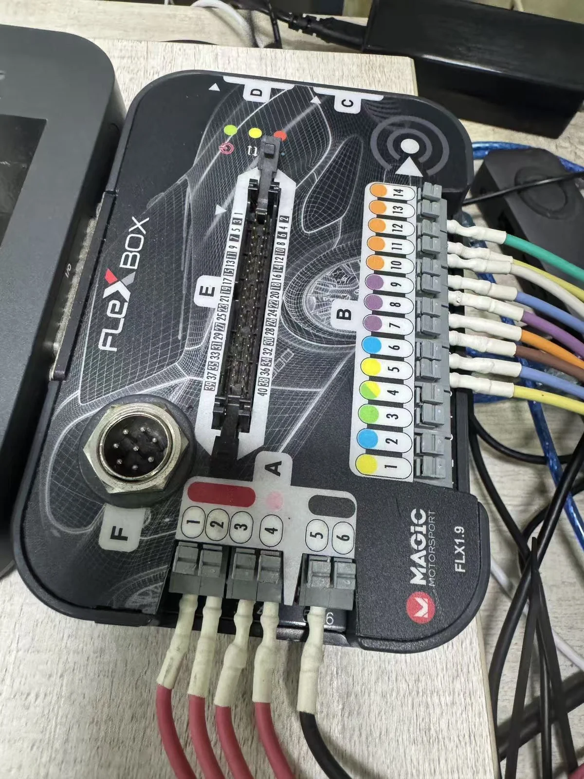

Clone was installed and car starts up fine and street tested for three days, everything is fine and no CEL or warning of any kind, then bench flashed with a FlexBox FLX1.9.

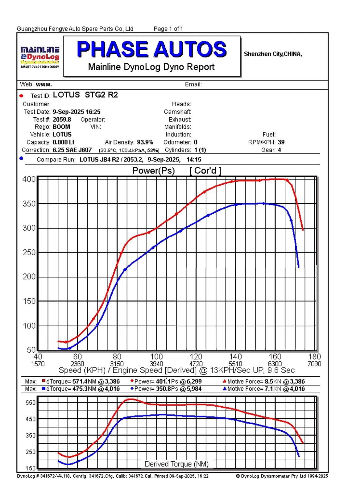

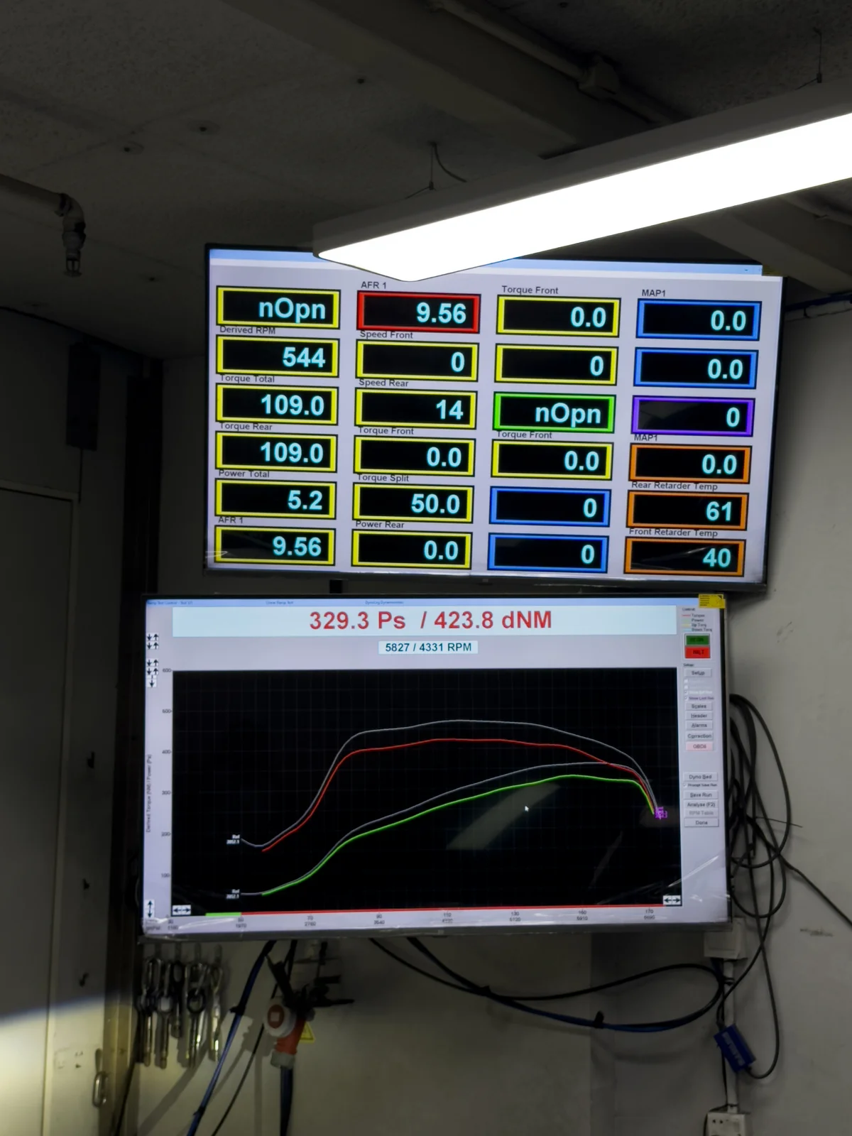

Tuning was performed and dyno on a Mainline, for people who are not familiar with this dyno, it is considered one of the more accurate and harder to cheat dyno, but it also produces a very small number. Just compare the baseline number and the delta for result.
TLDR: 510HP, car RIPS, Tour mode now usable!
All dynos were performed on the same car on the same day (ambient 85 – 90F).
Pure Ron98 fuel, no octane booster or additive, no methanol.

Normally 3 runs per setup and pick the median as result, but since we had to do so many dynos on the same day plus the uninstallation and installation of the full exhaust, we had to limit to 2 runs per setup and pick the lowest as result.

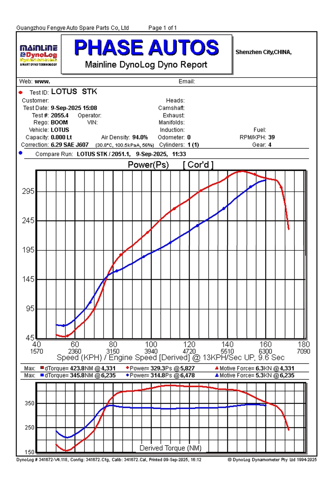

Here are some of the dyno comparison:

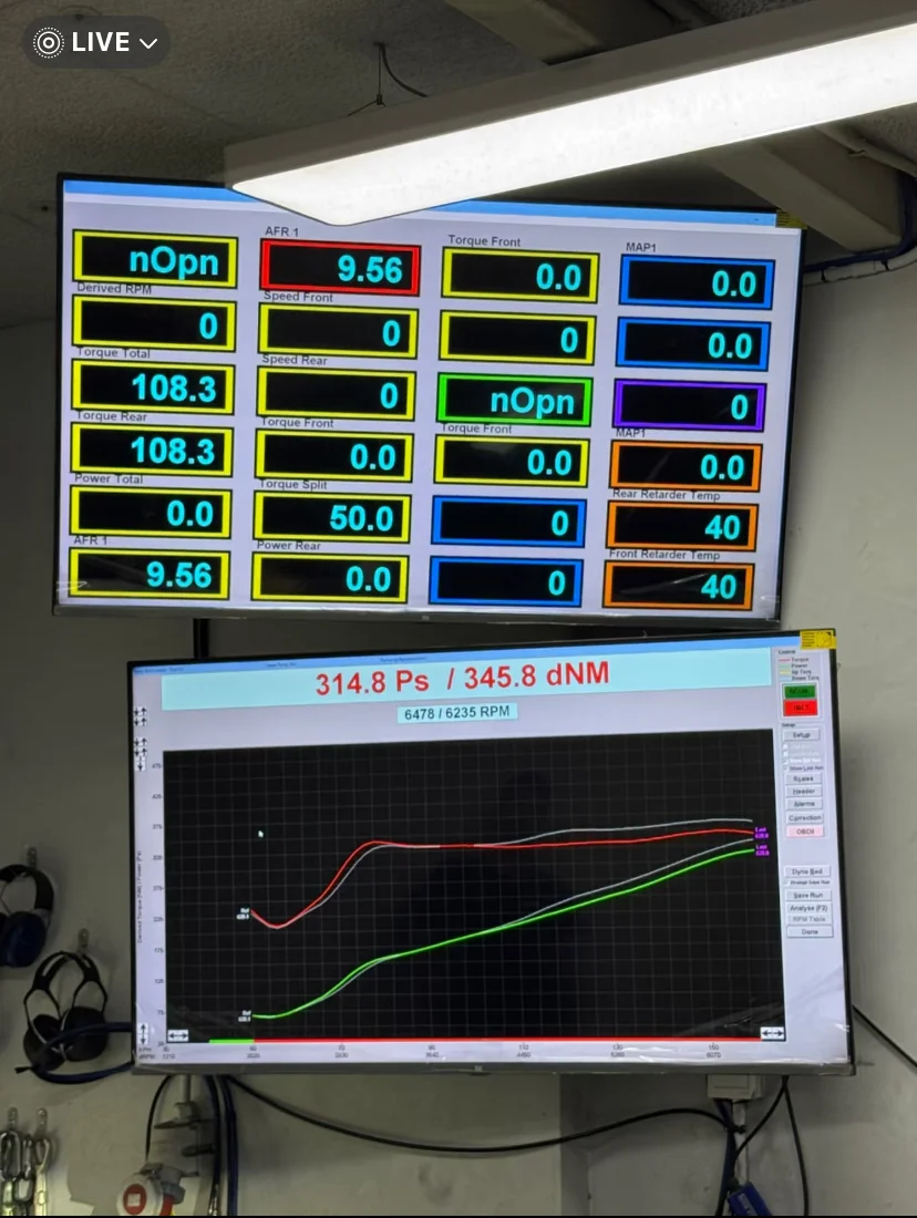

Stock vs Bolt-on Mod

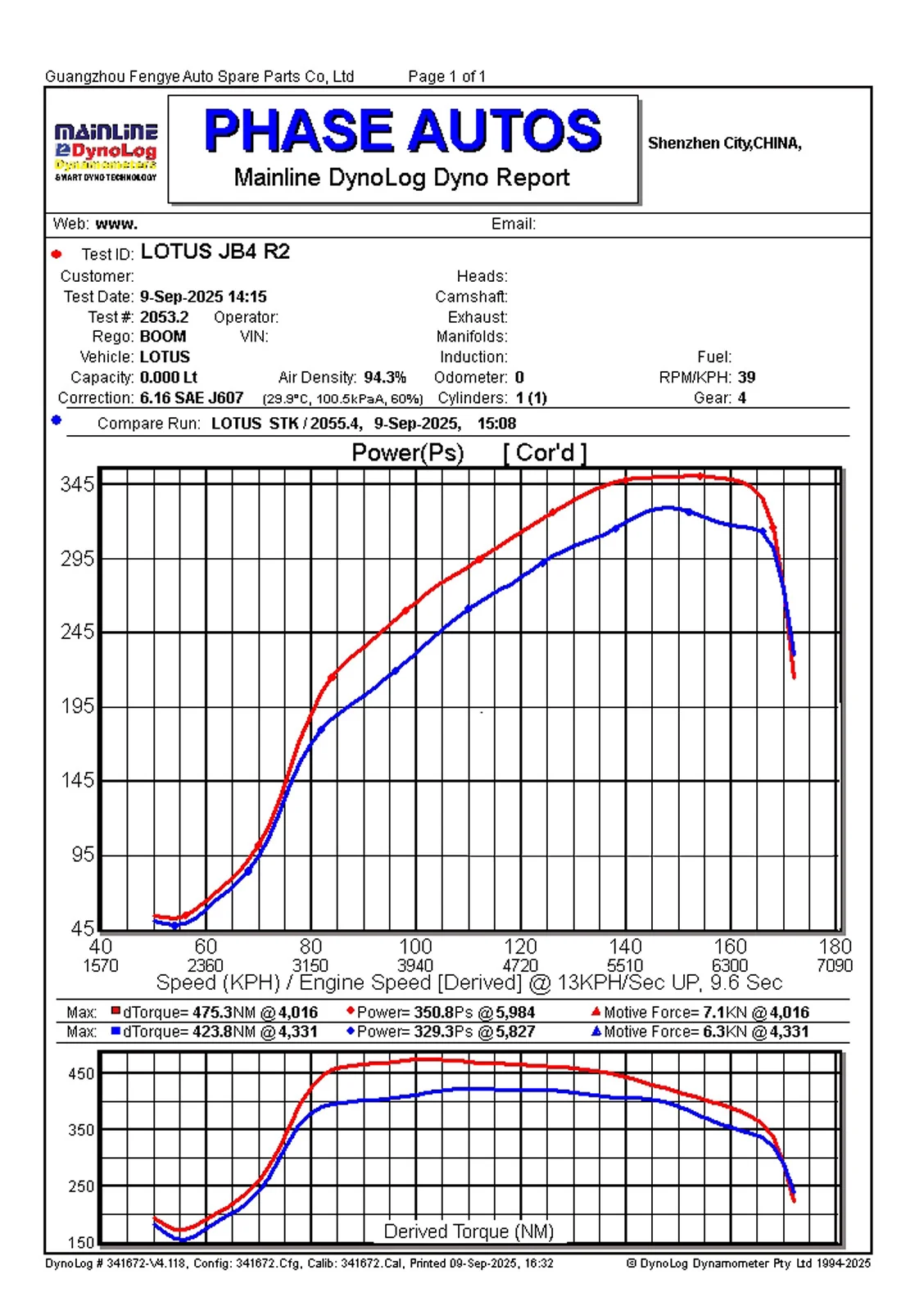

Bolt-on Mod vs JB4 Map 4

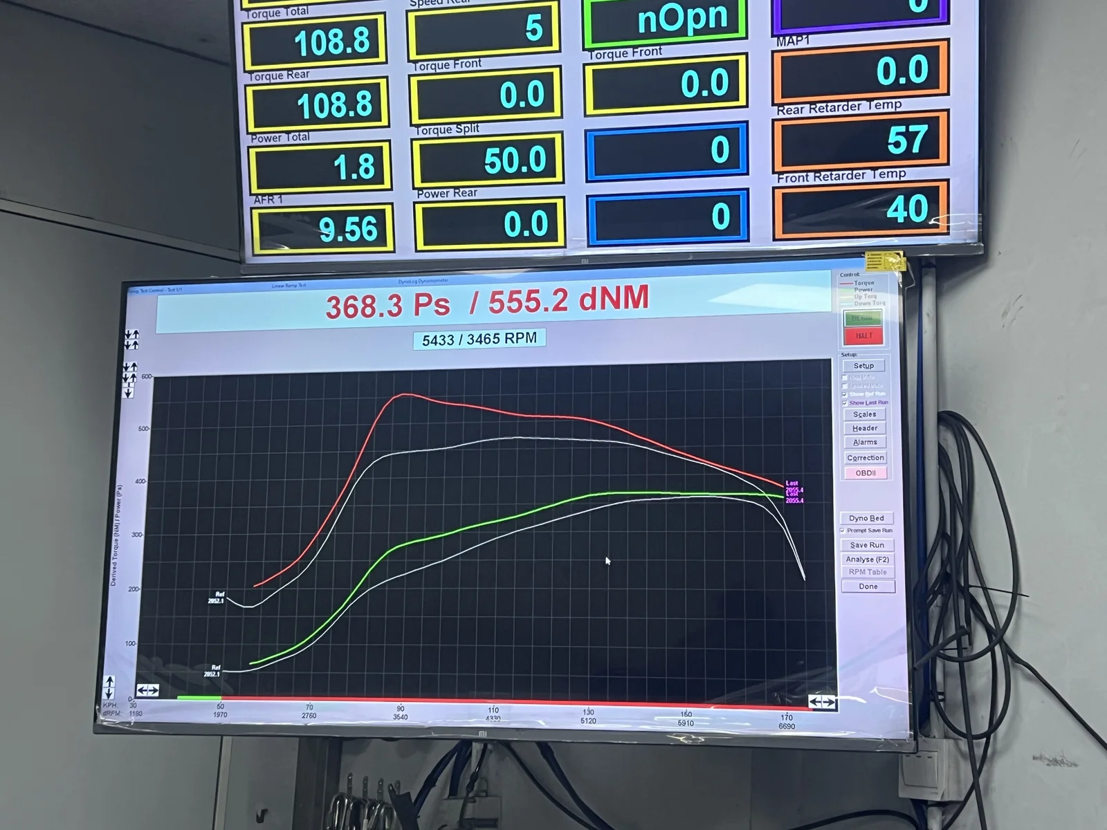

JB4 Map 4 vs Stage 2
Based on my baseline 314 HP at wheel, (400/314) x 401 = ~510 HP, I am guessing there is around 500 HP at the crank (correct me if I am wrong) with massive torque as early as 3000 rpm. Now this is a very fun car to drive!

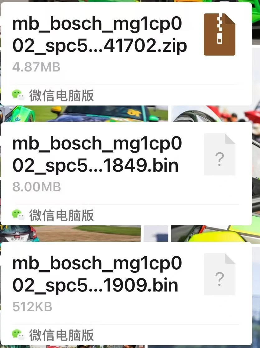

At our workshop we also work with Flex, so I’m really curious — would you be able to share the BOSCH Part Nr. (0261xxxxx) of the unlocked unit you used as the base?
We have a few units in stock and this could open the door for us to try the same approach.
Also, when cloning, did you transfer only the immobilizer data(EPROM) and keep the original MB A45S (420hp) calibrations?

I have asked and unfortunately he won't give out the part number for the ECU since he was only able to stock up 50 ECU but already sold 26 of them. He is worried if he gives out that information the price will be jacked up globally. He said you just have to try and error but at least now you know where to start.
The whole programming is cloned from oem to old ecu.

That's the problem. He can't just sell you an old ecu with new tune. He has to clone your original onto an old ecu,, which he doesn't think anyone oversea will take such a risk. That's why he allows me to write up this forum post to give oversea tuners a new direction.
