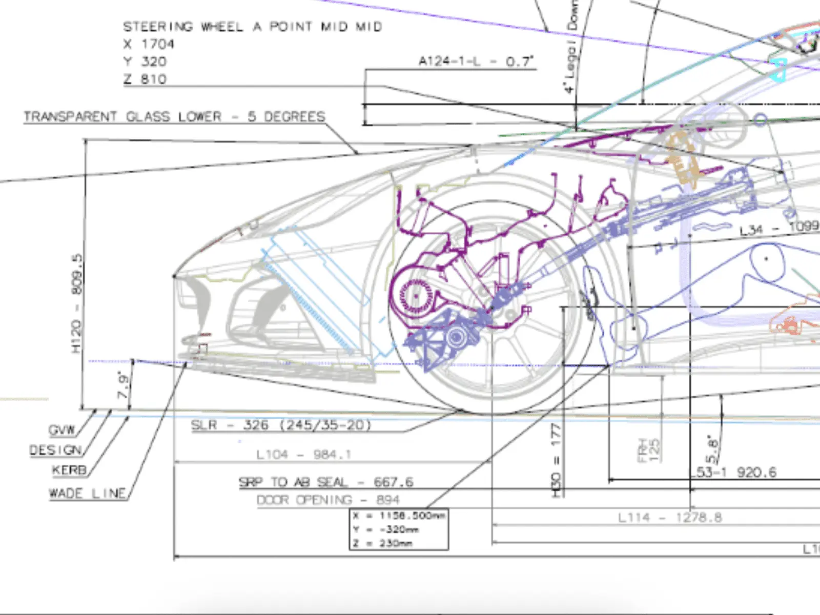

Thanks, yes I have seen that. Unfortunately, it is not an accurate picture of the production vehicle. That rubber molding is not on the production car. It’s also unclear if there is a difference between sport and touring ride heights. U.S. cars may also be higher due to regulations.

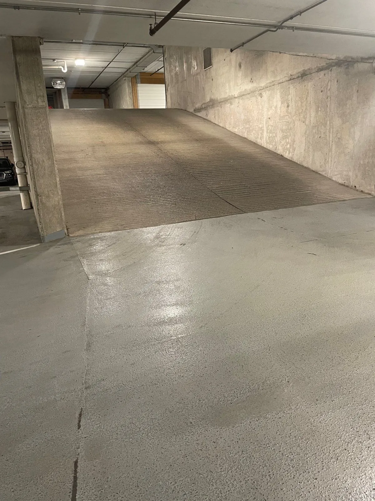

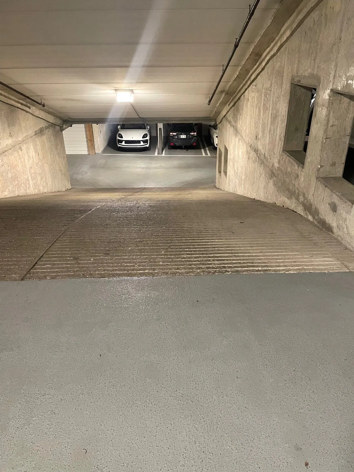

:unsure: the slope is not all the same angle, there is a gradient ant the beginning and at the end, this may help the passage. I didn't find the emira so down on the ground!
Thanks, yes, it has an unusual grade. I've been okay with my current M2, prior TT RS, and 14 C4S. I tried getting a Porsche with the sport design front end down once, and it was a no go. The front end of the Emira extends pretty far, and it's just hard to tell if I could make it down that ramp.

I inquired about this subject months ago with Lotus USA and this is the response I received then. That 9-degree number provided is different than the 7.9-degree spec found in other Lotus documentation.
"Paul:
I have been told by my colleagues in the UK that the Emira approach angle is approximately 9 deg for Federal vehicles. I hope this helps."

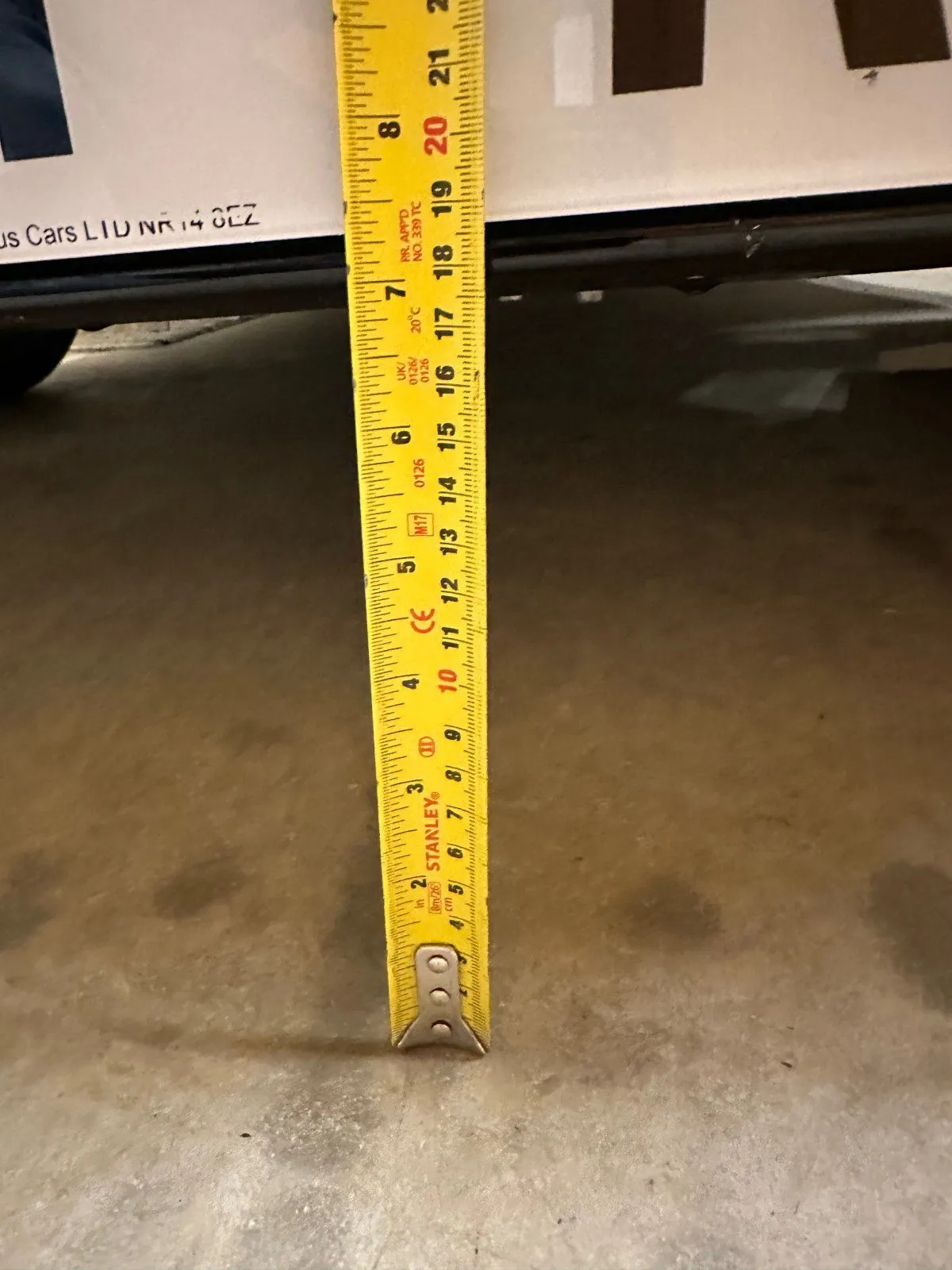

I just measured, to the bottom of the small plastic rubbing blocks is about 132mm as calculated, to the base of the front lip was around 150mm. This is on sport suspension with around 850miles in case suspension settling plays a part. For reference a similar spot on my GT86 (plastic under tray about the same distance in) was around 110mm from the ground, and a Jaguar XF was about 180mm. Since the Emira has a flat underbody as well it seems like there's loads of ground clearance!

Thanks for the response. I'm still concerned about making it down the incline to my garage, but I locked in an order today for an FE 2.0 so no turning back now. I'm hopeful if I take it at an angle, it will be okay.

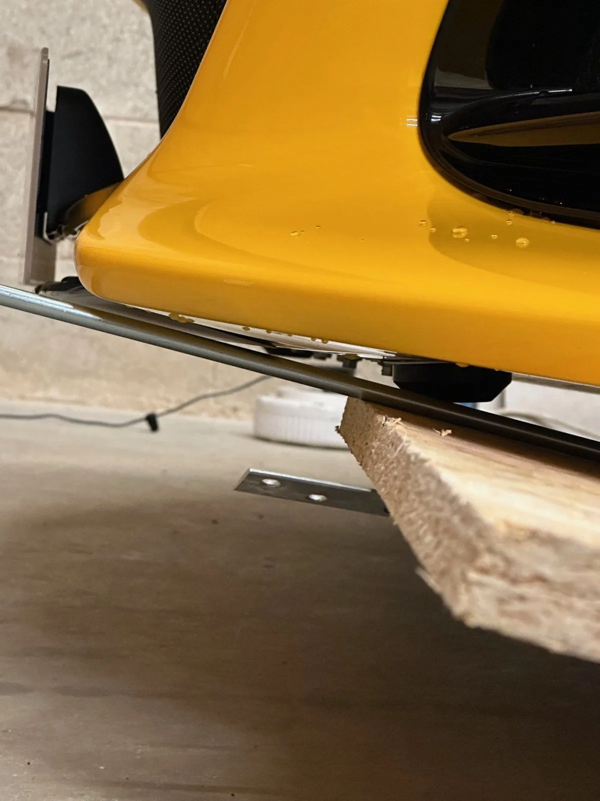

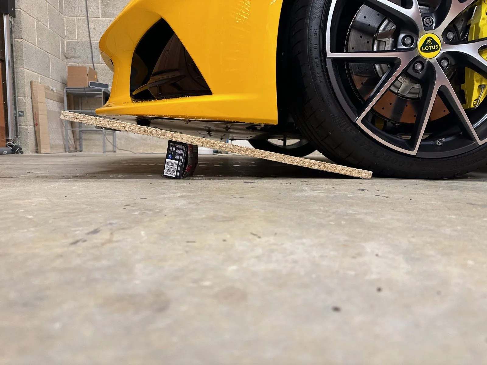

I had a mess about last night. its about as unscientific as I could make it with a steel loft ladder key and an off cut of OSB.
Mine is on tour and nearly up to 2000miles
Static clearance at the very front of the splitter is 170mm.
Taking a line roughly past the sacrificial bobbins (which are a hard ally by the way I thought they were plastic then steel but the magnet confirmed - metal but not steel) the angle is about 10 degrees.
Exige is a mare over road humps so do the same taking them at as big an angle as i can get away with.
Obviously descending on brakes with a load on board will make it a bit 'worse'.
