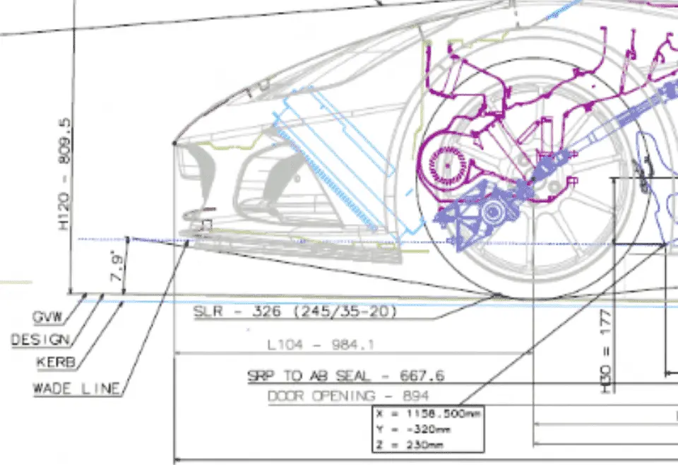

I believe I read it had a better approach angle than a Boxster. Its pretty good, I went over stuff I would have scraped on with my other cars, and it didn't.

That spec sheet is old. The approach angle is close to 9 degrees. The car does not have the rubber lip shown on that picture.

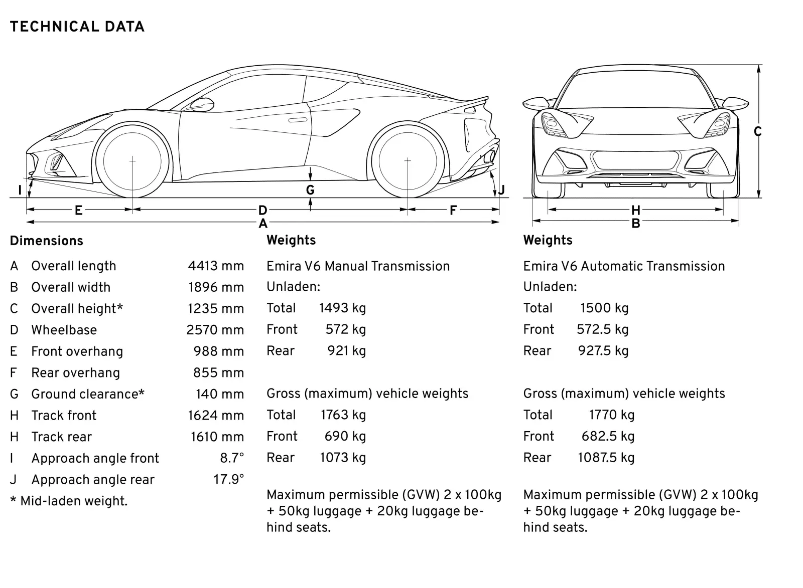

Guessing since you didn't include one that you're not aware of an updated spec sheet that's available somewhere?

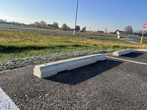

I guess the one caution I'll add for USA/CAD owners is about concrete parking blocks. One of the local Emira owners told me he miscalculated and scraped on one of these. Evidently some are the exact perfect height to scrape the front before those alloy bumpers which are located a few inches in. Something about putting the car in neutral on approach turned off or reset the parking sensors so they didn't detect it. Hope this helps someone avoid a problem.
I had trouble uploading another version prior. This is from the UK owner's manual. When I searched a while back, I did find multiple versions of this. The approach angle in this is more accurate than the one above. Looks like it is due to removing that rubber piece that is shown in the prior versions, and also on the configurator views.
