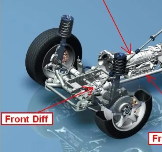

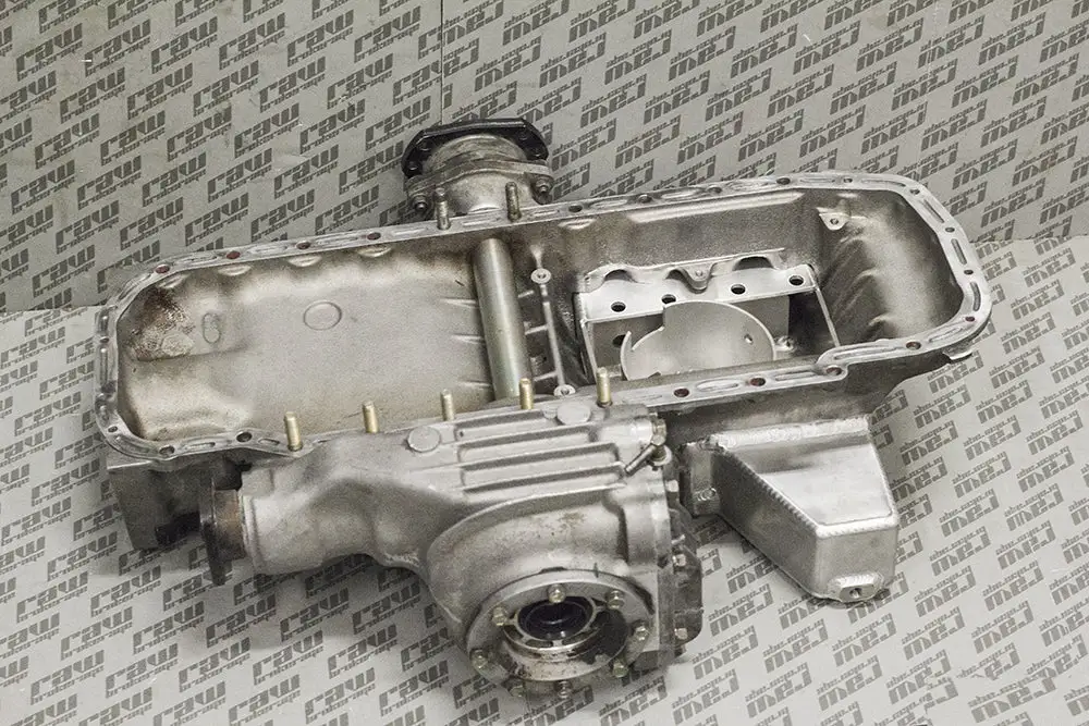

Probably not what you're thinking of since this is a longitudinal example, but the E53 BMW 6-cyl design was able to lower the engine height by mounting the front diff to the side of the sump and running one of the half-shafts through the sump to the other wheel. I shelled out the front diff on my 2001 and this design made the replacement far more complicated. Glad the Emira has both shafts outside of the trans/engine!
