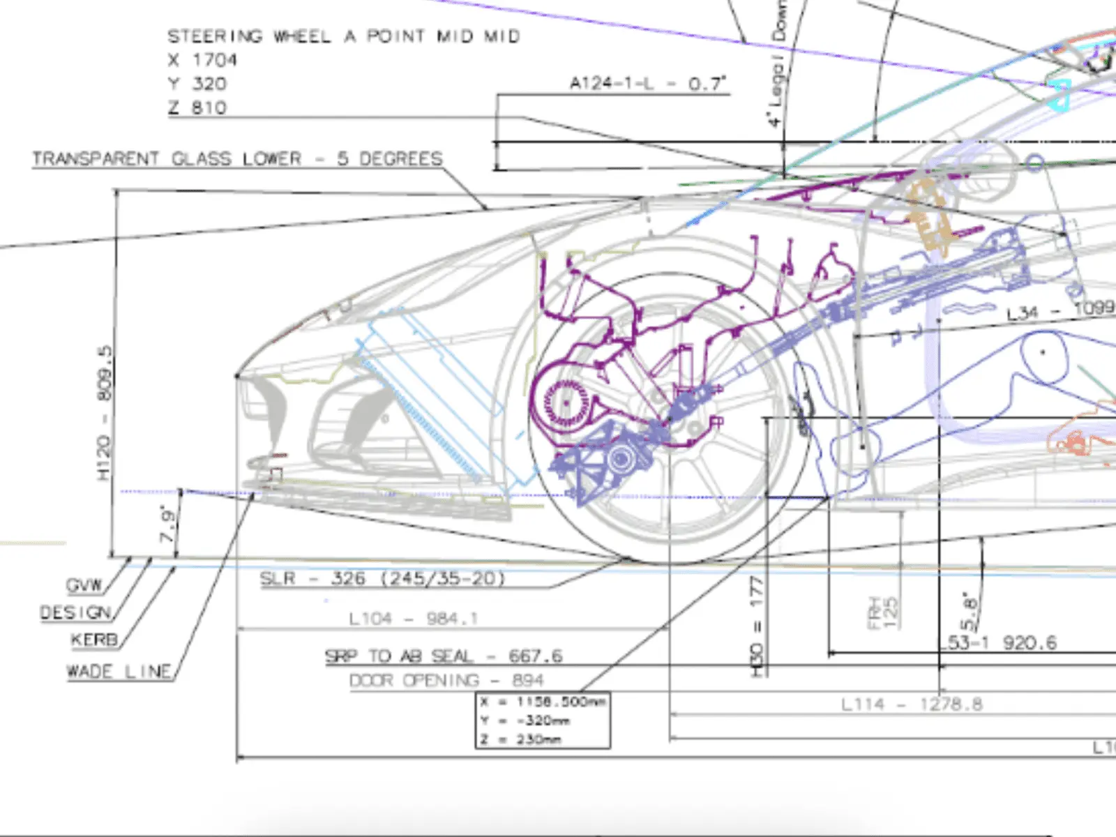

Official front approach angle is 7.9 degrees, if that helps.
Thank you, but unfortunately, this diagram is a bit inaccurate. I don't believe any of the cars built have that rubber molding mounted under the front end. I also believe there may be slight difference between tour and sport either due to small difference in the components, and/or the tire height. I'm also suspecting that the U.S. cars will be slightly higher based on an interaction I had with Lotus a long time ago. Hopefully they will build some cars for this market, and we'll be able to confirm if there are any differences.

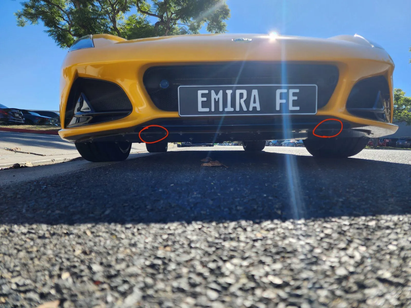

There are two what I can only describe as hockey pucks under the nose that would act as first point of contact if you were to ground the nose. I was told by someone that Evora was the same although I don’t remember mine having them. Perhaps only the later 400 series had them.
From the pictures @Balboa posted - could these (red circles) be the "hockey pucks" of which you speak? They seem to close to the nose to be jack points.. Harder to see in the full frontal photo, but they are visible..

Wait, what front rubber splitter? My car doesn't have anything under the nose except the sacrificial impact pucks.

It sounds awful when it happens but inspecting the car there's no damage to the plastic lip nor the undertray, no signs of any scraping at all - the lip still feels smooth to the touch with no scoring. There are two soft plastic stops about an inch or so deep on the front of the car that I assume hit the road surface first rather than the lip or the undertray. But it still sounds like you are wrecking the car when you hit them.
I scraped mine twice when I was in France, both times over speed bumps. It sounded horrendous, but when checking under the car it’s the two sacrificial round pucks that have touched down. I was surprised how little they were scored as it sounded a lot worse.
Done same several times in mine sounds catastrophic but only minimal damage to the pucks.

No, it was't too hard, and also, someone posted it here earlier: the front lip has underneath these two "hockey pucks" that are there to take the brunt of it in case you scrape. Honestly, compared to other cars (McLarens, GT3, Ferraris), which can be a pain, they managed to maintain that supercar low nose look, without the hassle of the nose lift. You still have to take care. I slow down a lot more for speed bumps, than with my RS5, for example. But it's not like my friend with the 600LT who uses Google maps everytime he goes somewhere to trace the road and see what awaits him :).
