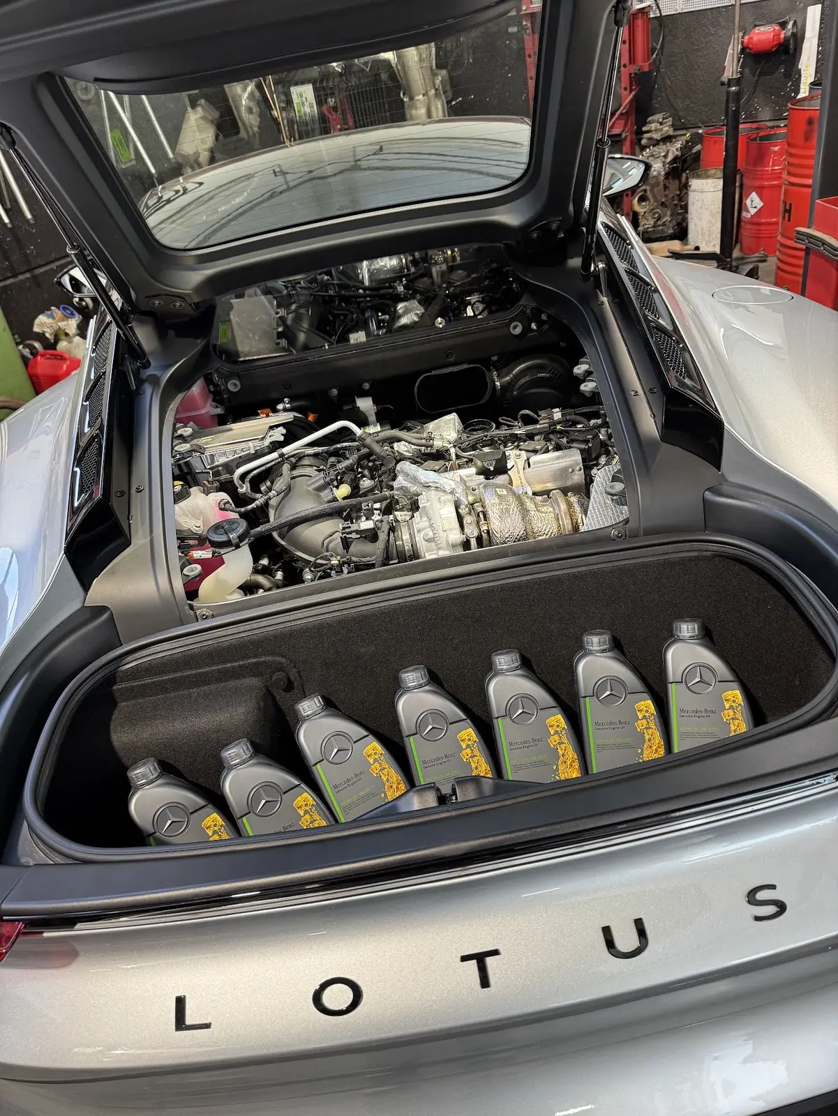

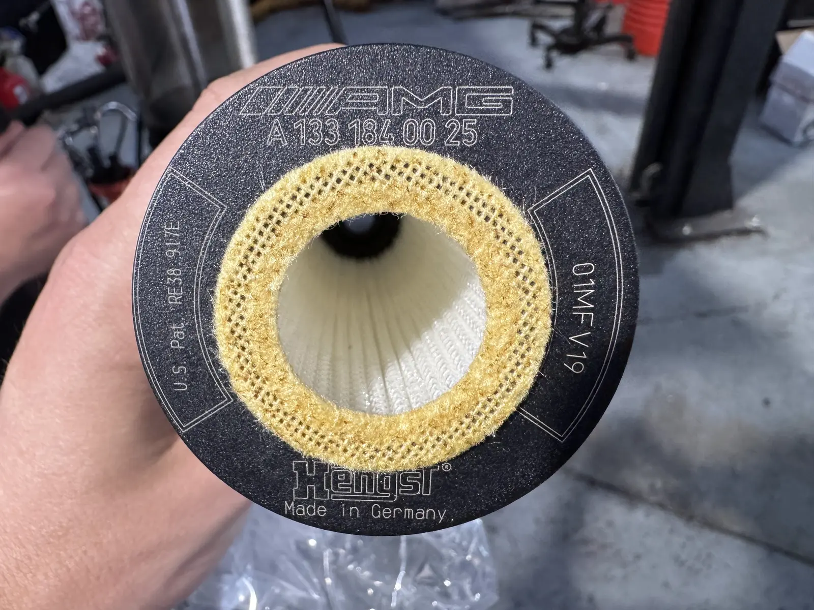

I recently ordered (from Mercedes) everything needed for the first oil change on my i4 M139, and here’s what I got:
  • A176 180 08 00 – OEM Oil Filter (A45S AMG)
  • N007603 014106 – Drain plug with washer
  • A000989340911ABAW – Mercedes-Benz Engine Oil SAE 0W-20 MB 229.71 – 7 liters
Everything is OEM and fully compliant with Mercedes-AMG specifications. The oil meets the MB 229.71 standard, which is required for the M139 engine. I went with 7L to be safe — the engine takes around 6,5L with filter but on service usually only 6L are required.
