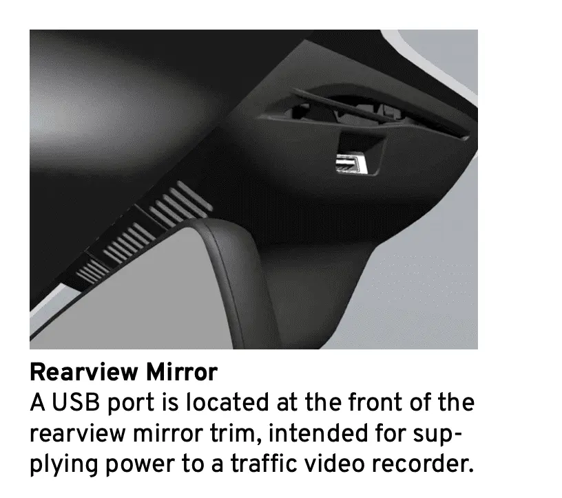

What it doesn't say (that I saw) is if that's an always on port so that you can do parking mode on the dash cams that support it, I'm guessing it's not and turns off with the ignition 🤔

It says the 12V accessory socket powers down with the ignition, so I assume all the USB ports do too.

There is a section that states how this works, and it's somewhat tied to when the car gets locked. The USB ports power off when the car gets locked (and ignition is off). If the car is not locked, they stay powered for 7 minutes after the ignition is turned off. I believe that the 12v accessory socket follows the same logic, but I'm not 100% sure, can't remember.

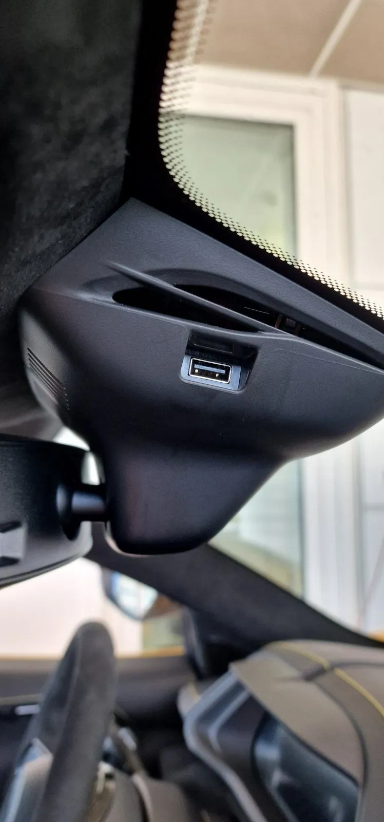

I gotta give lotus some credit for putting a usb-A port in the rear view mirror just for that purpose! Thats an amazing idea and shows they’re trying to go the extra mile with the emira (had an M2, 992, 718, 8Y RS3 and more expensive cars and that’s a first for me), found it in the owners manual.
I would also have liked to install a rear dashcam but with a mid engined car I never seemed to find a solution, if anyone has an idea that would be great haha.
I would also have liked to install a rear dashcam but with a mid engined car I never seemed to find a solution, if anyone has an idea that would be great haha.View attachment 10588

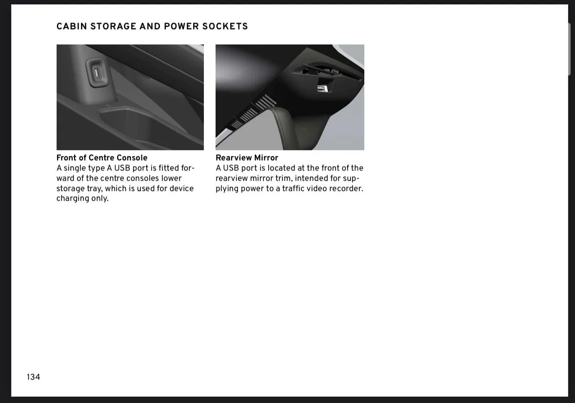

The show car had a USB C in the roof panel - hope they kept that....
There is one located on the rearview pod, specifically for traffic video recorders. (from the most current Emira handbook)

Did anyone ever work out if this dash cam USB port is always on or switches off with the ignition?
