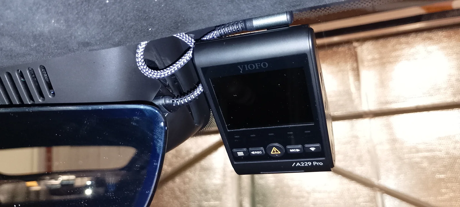

It's mounted on the UK driver's side of the rear view mirror.
It's as high and to the left as I could get it.
This makes it easy to press the Save button (the ! in the triangle) when you want to save the current recording segment.
It doesn't get in the way of my view and as I usually drive with the sunblinds down practically invisible anyway - and the Save button is still in sight.
I used this short cable to connect it to the USB outlet:
Amazon - AINOPE 2-Pack 0.5ft USB C Cable
I did start off with the Viofo 128GB SDcard but found this was too small for longer journeys as I like to review my trips for the interesting scenery or incidents if I don't press the Save button.
I got a SanDisk 512GB Extreme microSDXC card from Amazon which works well. This does my trips to Scotland and back and just about my trip Ipswich>Portsmouth>Cherbourg>Le Mans>Forges Les Eaux>Saint Omer>Calais>Folkstone>Ipswich.
I've now got 3 of these for the Monaco trip next year.
I set the recording segment time length to 10 minutes (the maximum) because I find it easier and there's less likelihood of saving the wrong segment if, for example, you press the button because something has just happened but it changes to the next segment before you press the button - this happened to me when it was set to 5 minutes and I missed something important and was another reason for going to the 512GB card.
I haven't got the rear camera for this because I had just got my car and wasn't sure where I would route or store that very long 6m cable they supply for the rear camera. I still might do this if I can figure out where to hide the cable.
Incidently the Trim Removable Tool they supply with the camera is ideal for removing the small covers on the 3 screws when you want to open the front bonnet.

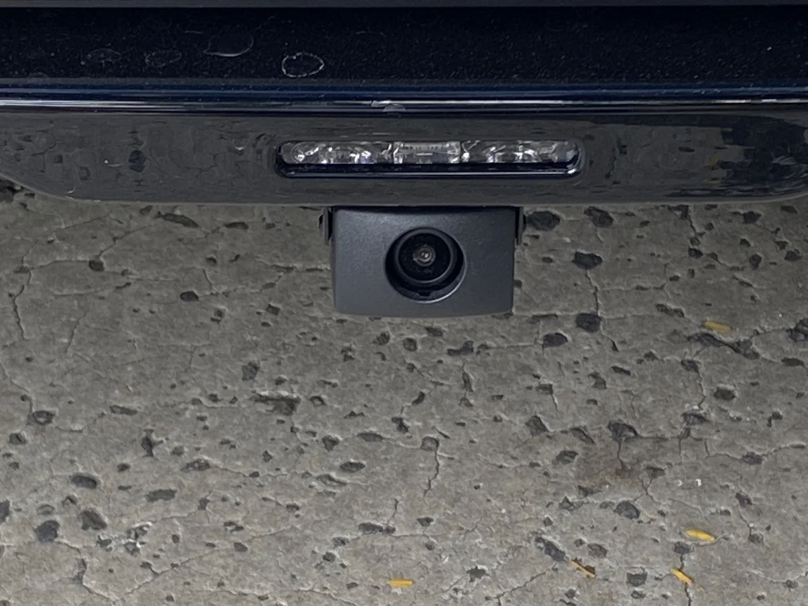

To Embedded Media, the video you have showed of a digital rear view mirror displaying front and rear looks very interesting.
Where is the rear view camera mounted ?
Are you UK based ?
Are you UK based ?
Under the rear diffuser.

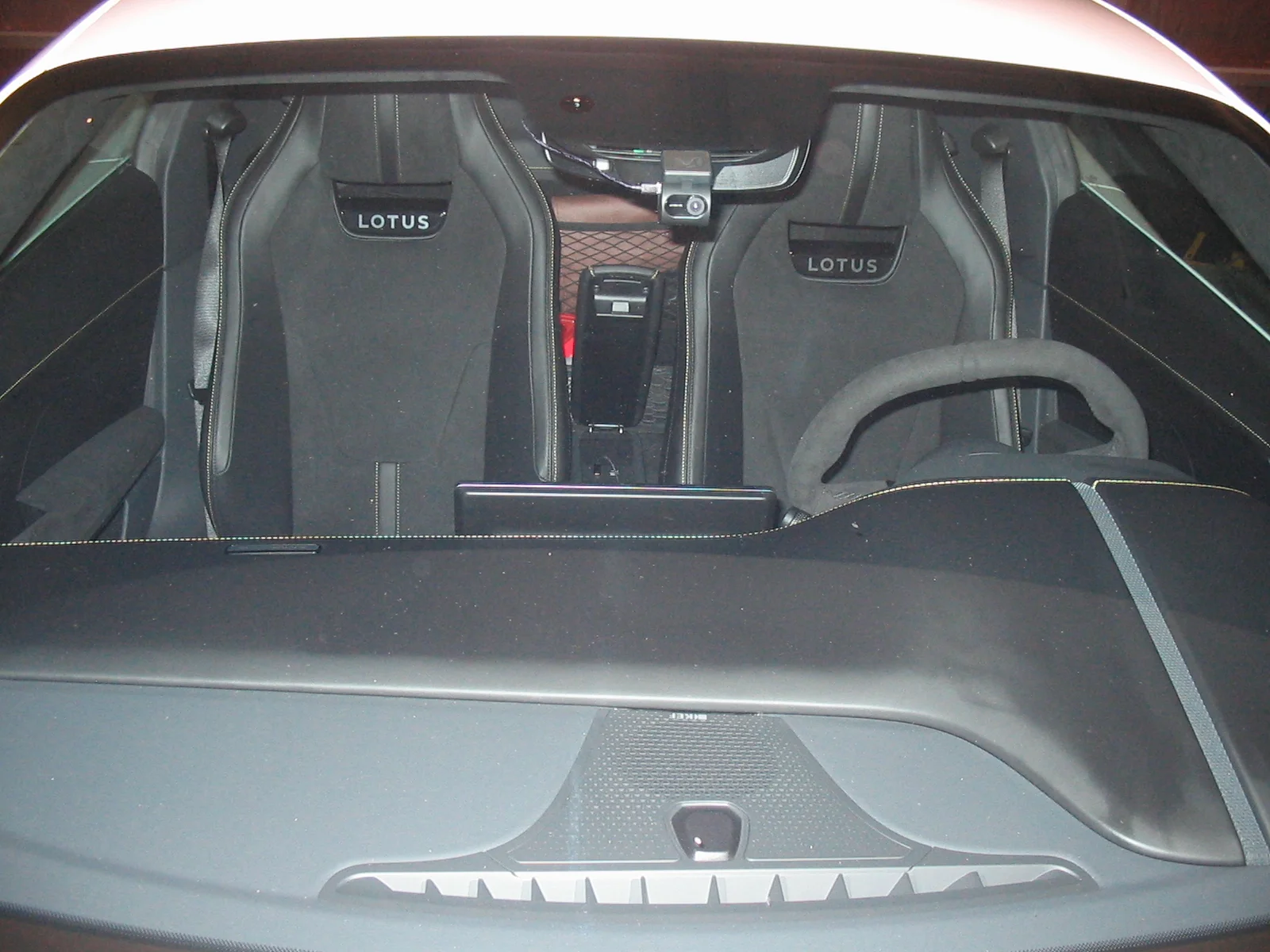

Is it possible to have the rear camera installed on the internal rear glass?
It is possible, but the routing of the fiber optic wire might not be as neat as running through the rear wheel arch to the cabin. Also installing under the diffusor got you a very nice view and coverage of the rear car when you go mountain drive with your buddy or during a track event.

I went with a 70mai Omni dashcam with LTE connectivity. I have the rear camera affixed to the internal cabin rear glass but as you’d expect it only really records a very narrow focused area, I’m not sure how useful it would be if actually needed for some sort of road incident.

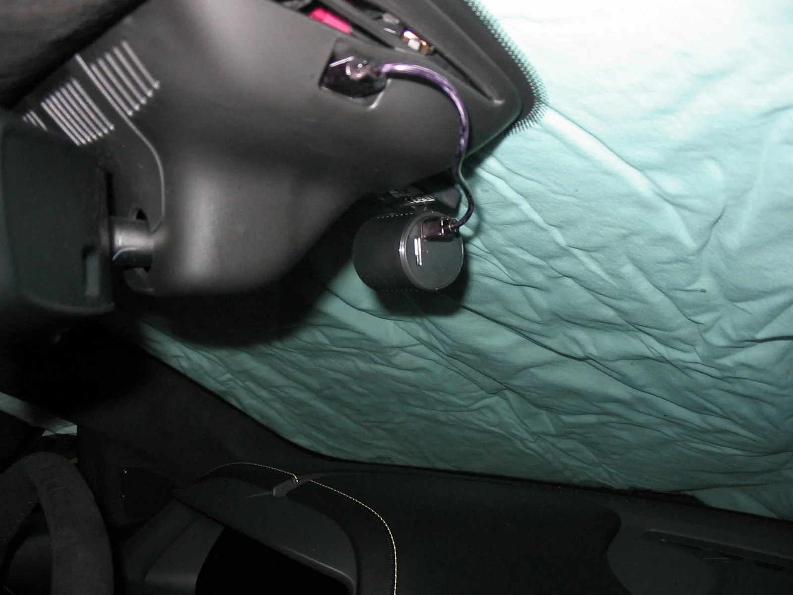

Like IANC3631 in post #273 I chose a KAWA dashcam, but the KAWA Mini 3 Gen2. I didn't need the the versatility of the Mini Orb because the dashcam is mounted between the windshield and rearview mirror. The only view the camera has is forward through the windshield.
The goals were to mount the dashcam (a) in the center of the windshield for a symmetric camera image, and (b) out of my sight while driving. Since I can't normally see the dashcam, the fancy indicator panel of the PRO versions is superfluous. But I did want the improved camera sensor of the Gen 2 versions. So of the four versions of the Mini 3 available, I chose the Mini 3 Gen2.
Power measurements indicate that the KAWA Mini 3 Gen2 draws less than 0.4A from the USB port while recording with the WiFi off. The only indication of operation is a small tri-color LED on its left side. So a RHD car would be better off with the PRO version and its indicator panel.
Image quality is on par to what I'm used to seeing with the Corvette C8's built-in PDR. I do miss the basic data capture, e.g. mileage, speed, and gear, that could be overlayed with the PDR.
