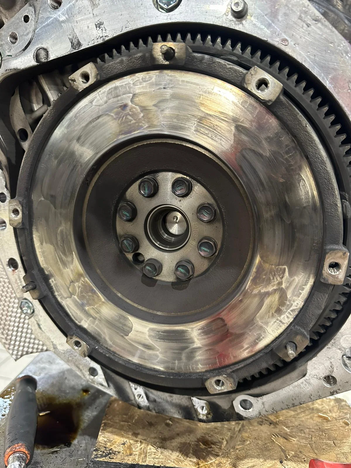

only just seen this thread, I had a new clutch after 18 months and 25k miles in November 24. The labour is by far the biggest part of the bill. I reckon half the problem was the sticking handbrake U used to experience where on occasions I had to unstick it by adding more power...

Do you think you were hard on the clutch?
25K is not a lot of mileage for a clutch.

The answer is in the pic. The rectangular ellipse shapes you see all around are essentially repeated high-rpm clutch drops. This goes back to what many have said through-out this thread. These are not "defective" or "weak" clutch parts. Instead, these failures are a by-product of flat-out abuse or in the case of an inexperienced driver, someone who is just learning to drive a manual. In either case, not the cars fault and the "bill" is 100% on the owner.

Hmm. Maybe 10% of that mileage was very enthusiast. Much of it was motorway. Only time it has ever been tracked was 5 gentle Nürburgring laps and a playful figure of 8 day with the lads at Curborough. Rarely bothered with a full bore launch, I do have some mechanical sympathy.
To be 100% fair here - some of that wear could have been caused due to the clutch plates failing and slipping. It depends how much it was driven after the clutch started going bad, although you would/should feel that.
