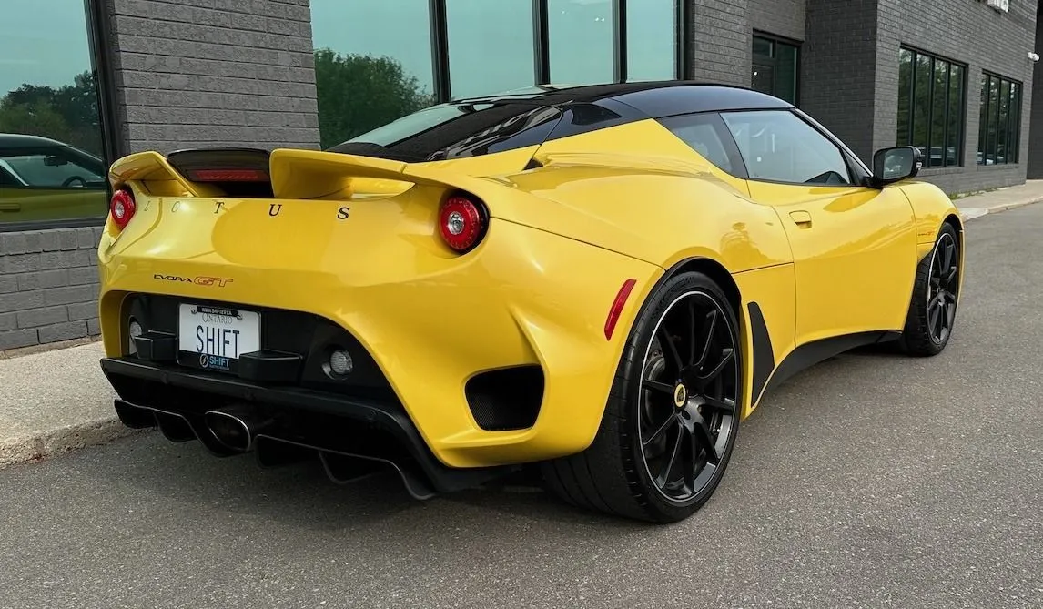

There's a yellow Evora GT currently for sale in Canada, and given all the positive experiences that you've shared with yours on this forum I'm sooooo tempted to just jump on that car instead and be done with this crazy train (but then still log in every day to read Emira updates! ๐Ÿ˜†). But one of the things that bugs me in the yellow example is this (IMO) goofy-looking split rear wing:

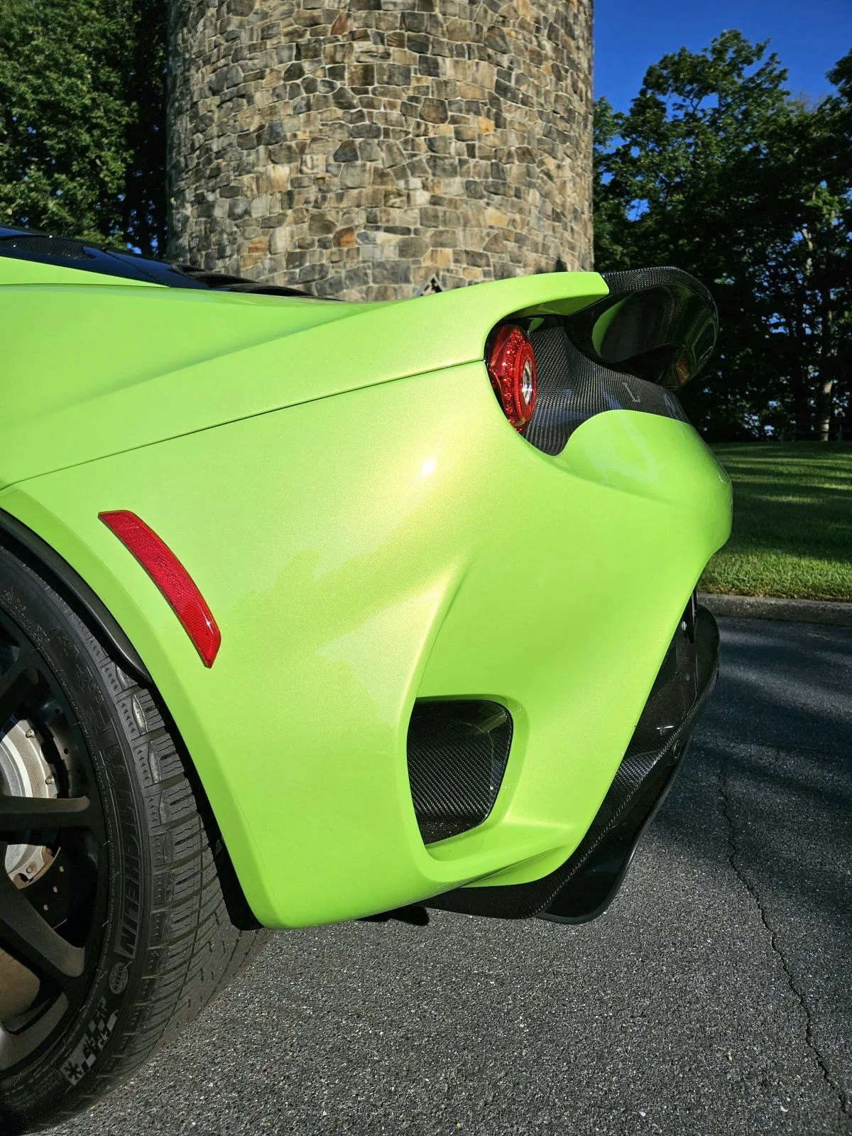

I see that yours has a different (IMO much better-looking) rear wing that's integrated with the rear deck lid? Was this only available via the "carbon pack" option when ordering the car?
Correct. That was part of the carbon pack, which also includes the roof and front access panel. The rear bumper is also all carbon with exposed parts (without paint) on the carbon pack GTs. I'm not sure if the rear bumpers are full carbon and just painted on all GTs or not.
Aerie sells an oem look carbon hatch, but it's not cheap! There may be other options out there too. You can always get that and then wrap the roof and front access panel in carbon look ppf. I hear the little cutout fender piece behind the front wheel and a pillars are also carbon from factory but fully painted.
Gotcha, thanks for clarifying that. So that explains why your car looks so much cooler. Haha. What a difference those pieces make! And what great fortune that your 1-of-1 car had that option already! ๐Ÿ˜ƒ

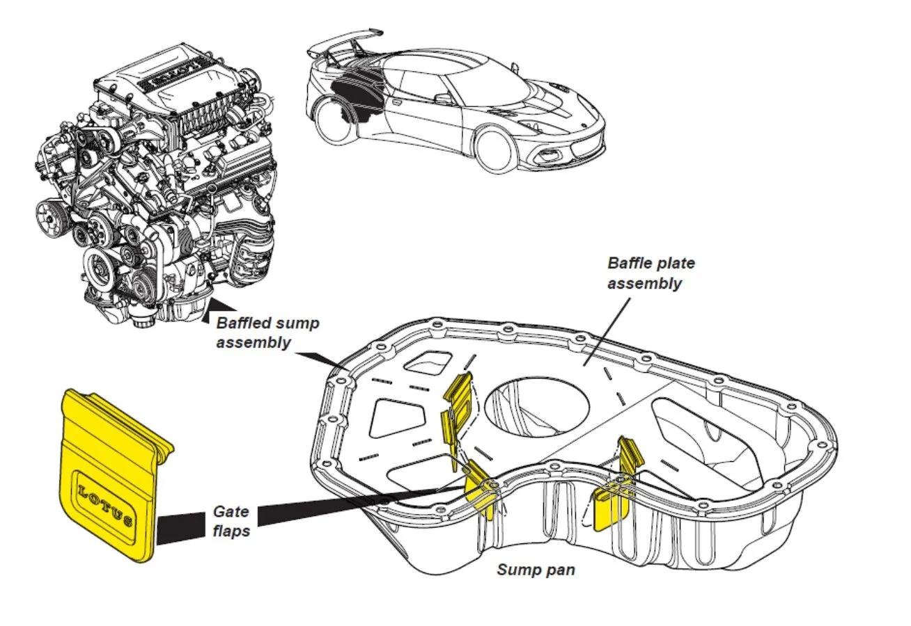

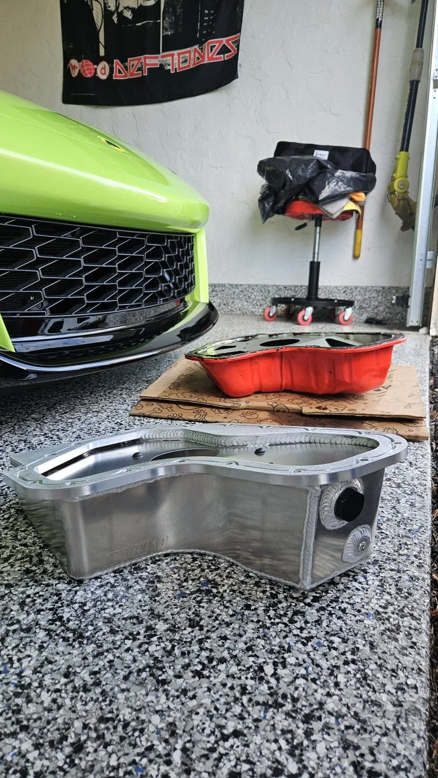

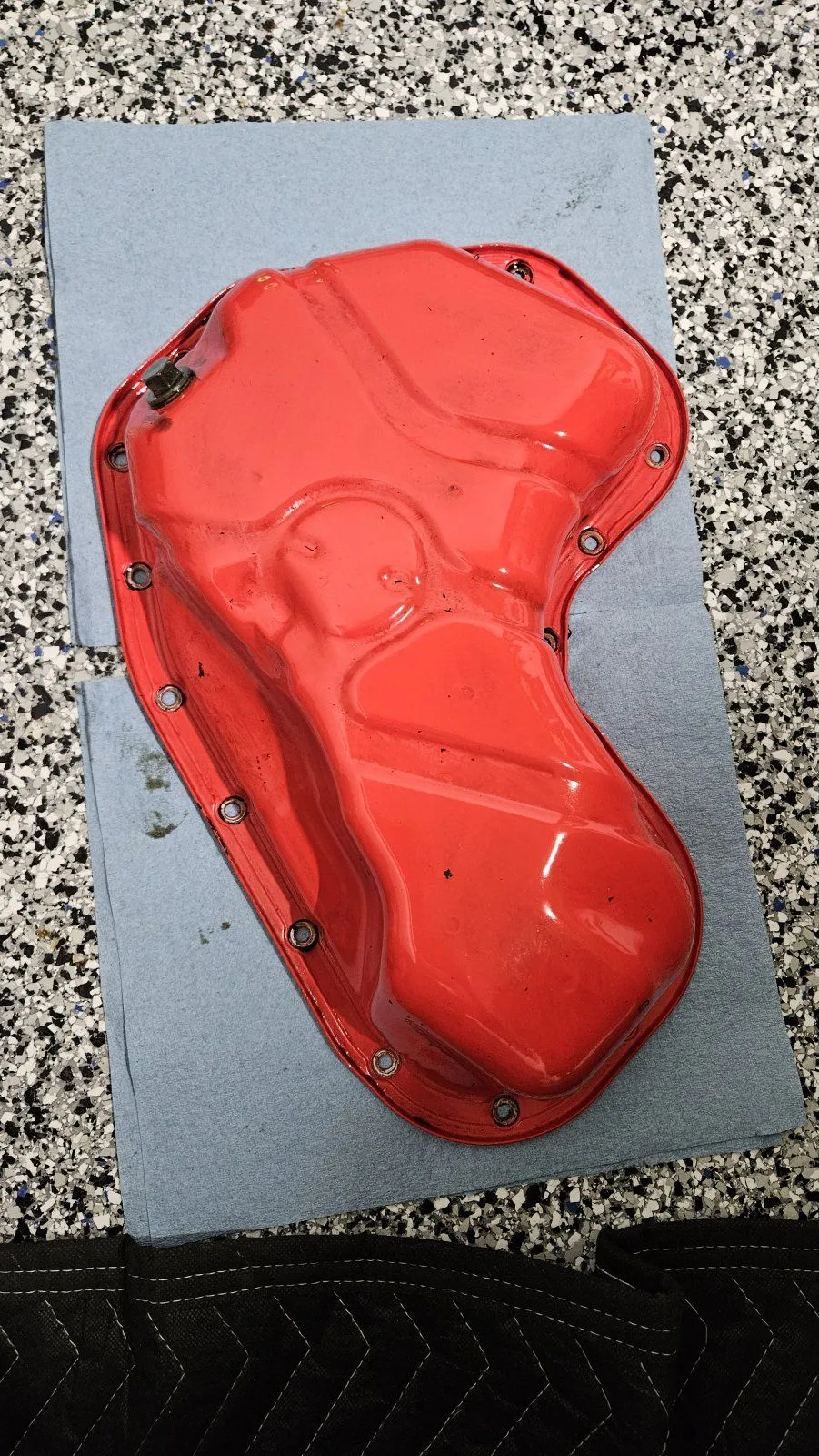

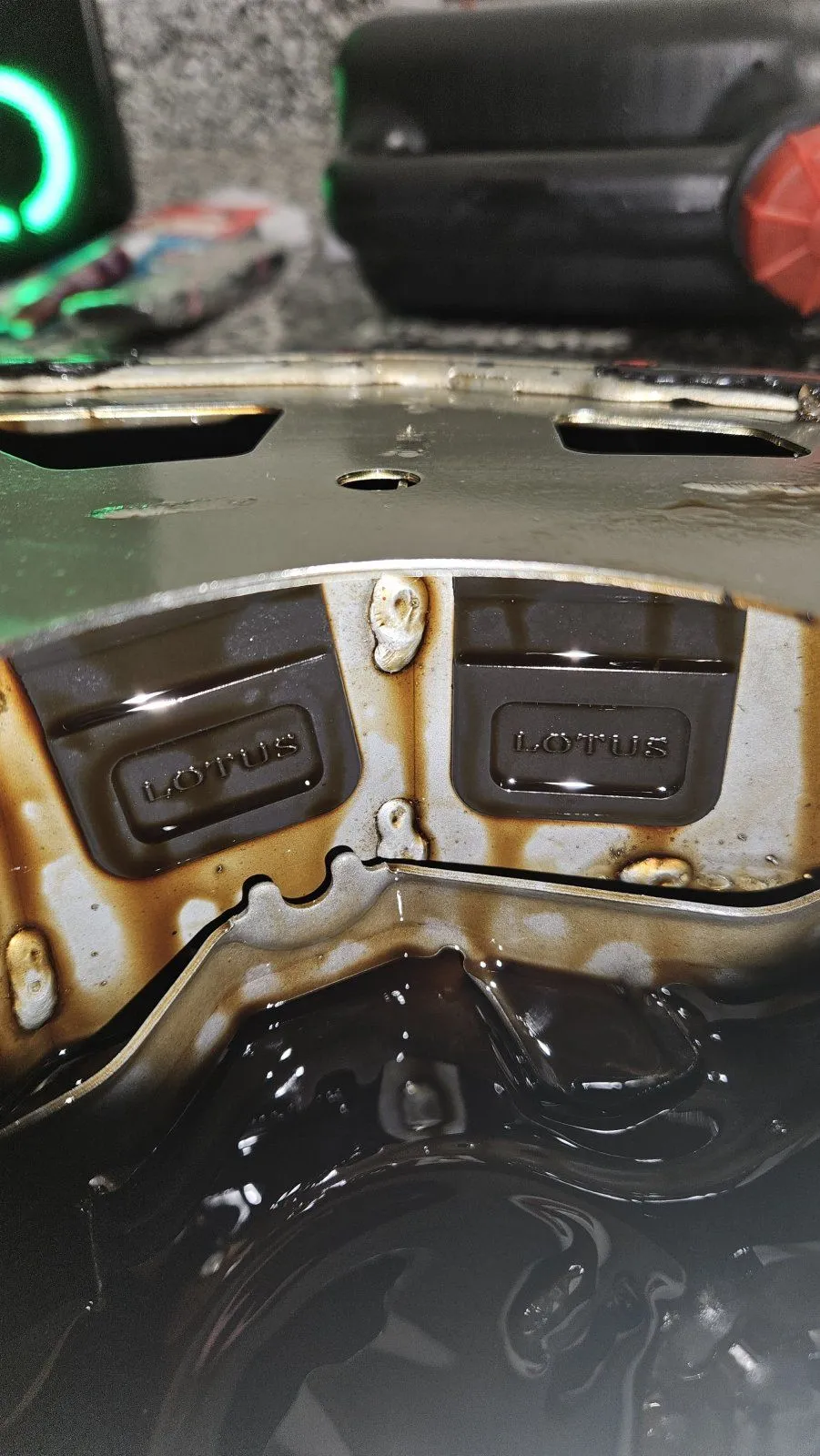

Today's project background: The OEM Evora GT oil pan is baffled and has 5 rubber gates, which require replacement every 2 years (per the official Lotus service manual). The gates keep oil in the center of the pan (around the oil pickup), which is essential during long high G turns where oil can shift to the far side and away from the pickup. Cool design and all, but overkill for a street car and a major PITA to replace the rubber flaps every 2 years. Dropping the pan means unbolting the exhaust Y Pipe and prying off the Toyota FIPG (RTV) and potentially damaging both the pan and block. Your options are to either replace every 2 years, ignore them (and hope they don't become brittle, break off, and clog the pickup), or go aftermarket.

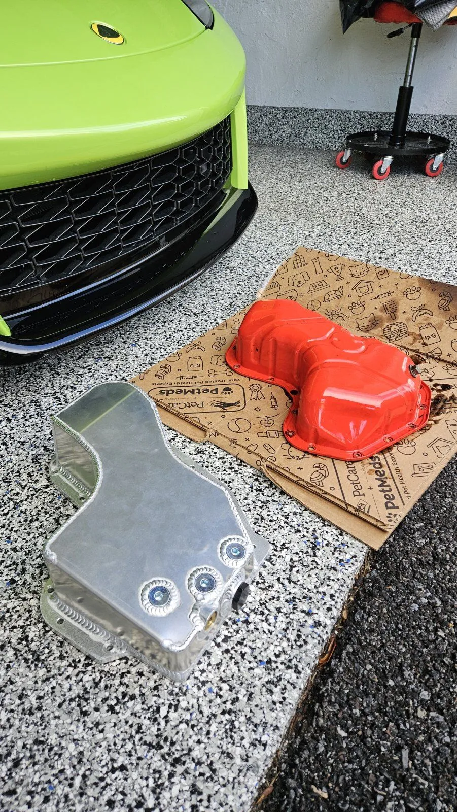

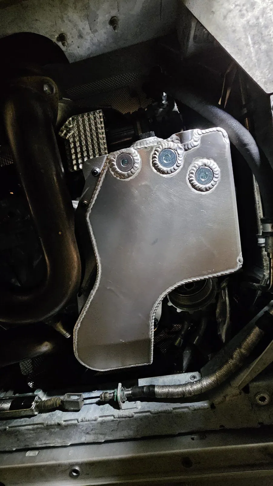

Since this is my dream car, I opted for the ultra fancy (and expensive) aftermarket option from Moroso. It's all aluminum and features metal hinged gates that don't require any maintenance. The pan also increases oil capacity to 6.25qts (better cooling) and has fittings predrilled for temp sensors and oil feed/return lines.
Pulling the stock pan was a bit of a struggle (especially on my back in my tiny garage), but it's finally off and tomorrow morning I plan to install the Moroso pan. The OEM rubber gate flaps looked fine (just over 10k miles total on my GT). And no worries, the Emira First and Base edition pan is not gated like this! I expect a future GT or R Emira will be though. Anyway, here are some pics... :alien:

Looks like a nice piece of kit! I especially like the maintenance free aspect. For those watching, what part number is this? I wonder if it will work on the the Emira ๐Ÿค”
Wow is the factory pan a gasket PLUS a whole mess of RTV? That's wild.
No gasket. Just RTV. I believe they actually used Toyota's FIPG (formed in place gasket) on the GT pans (Emira pans are sealed from Toyota and left untouched by Lotus). I actually used the o ring that came with the Moroso pan plus a small bead of FIPG when installing the new one. I spent a lot of time cleaning the mounting surface first.

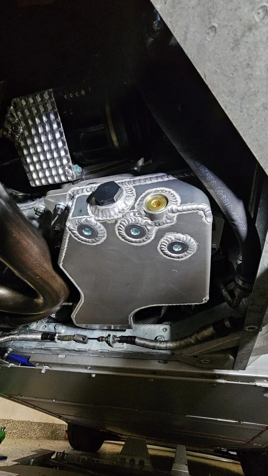

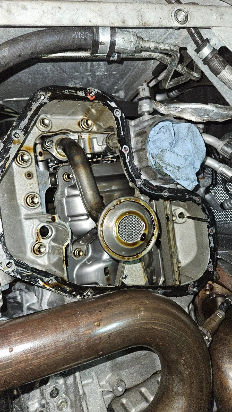

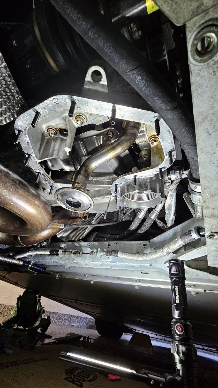

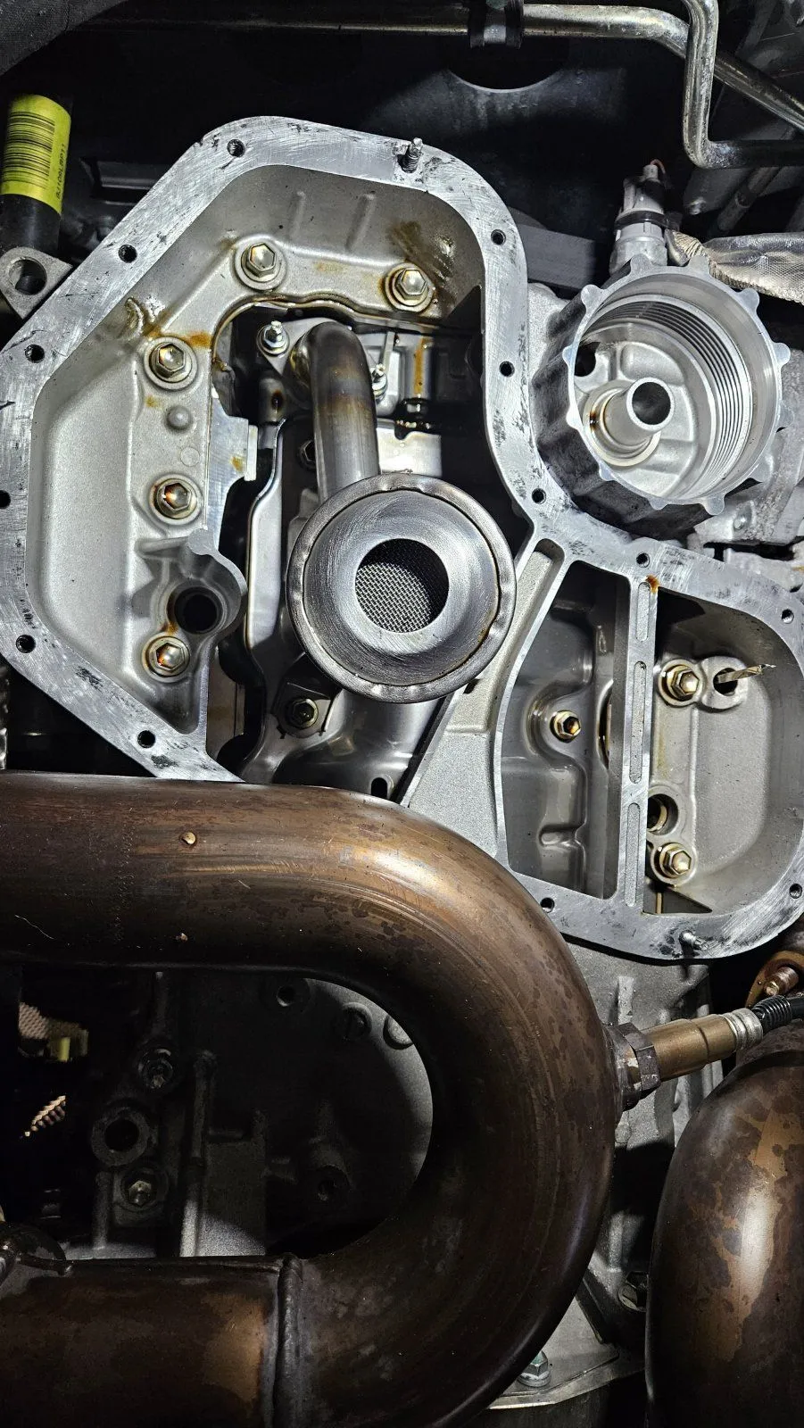

The pan ended up being a much tougher job than I expected, but it's finally on. The toughest part was threading on 3 of the tiny 10mm nuts onto offset studs inside the pan (you can see the 3 access bolts on the bottom of the pan). That was especially nerve-racking knowing I had just rtv'd the pan up and it'd be a total nightmare scenario if one of the nuts fell inside.
Anyway, here are some progress and final installed pics before reinstalling the aero tray.

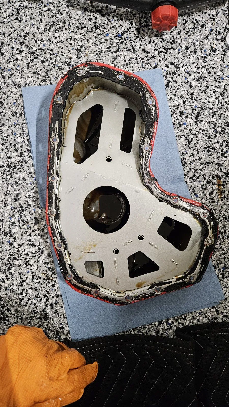

Mounting surface cleaned and before extracting the 2 factory studs. Both came out easy with small vice grips. This pic shows how the exhaust Y Pipe is in the way of dropping the stock pan. The pickup tube sits inside the pan in a way that requires the pan to tilt more than it can with the Y Pipe installed tightly. I had to remove 2 lower 15mm bolts and 2 upper 15mm nuts and that gave me enough flex to get the pan out.

Moroso pan mounted (18 nuts torqued to 10nm):

Part # 20971. It should work on the Emira, but there's a chance the Y Pipe might be a little different than the Evora.
How did you remove all the rtv?
Started with a razor and brake clean.. After an hour struggling with that method I switched to a little polishing wheel attachment on my drill. Worked like a charm and took everything off in less than 10 minutes without damaging the mounting surface. They came in a kit for ~$10 from Harbor Freight.

It'd be much easier with a lift and climate controlled garage (and my write up ๐Ÿ˜Ž). Loosening the Y pipe should be cake on a new Emira. Just be prepared for those 3 offset nuts. Me and a friend had to get creative with a spring to get them threaded on. It'll be easier if you have an extremely short 10mm socket.
FYI, the dealer wanted ~$900 to do it with me supplying the pan and oil.
