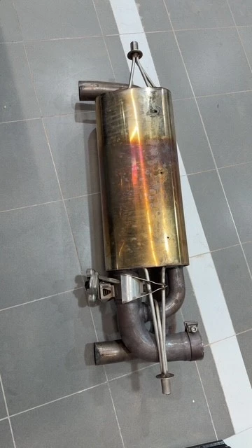

The first 1000 mile was not that smooth as I have encountered immediately a check engine that was caused by the exhaust valve (p1018).
The dealer suggested to bring it in, and thankfully they had a new exhaust assembly ready which they installed and did an oil/filter as well, problem solved.

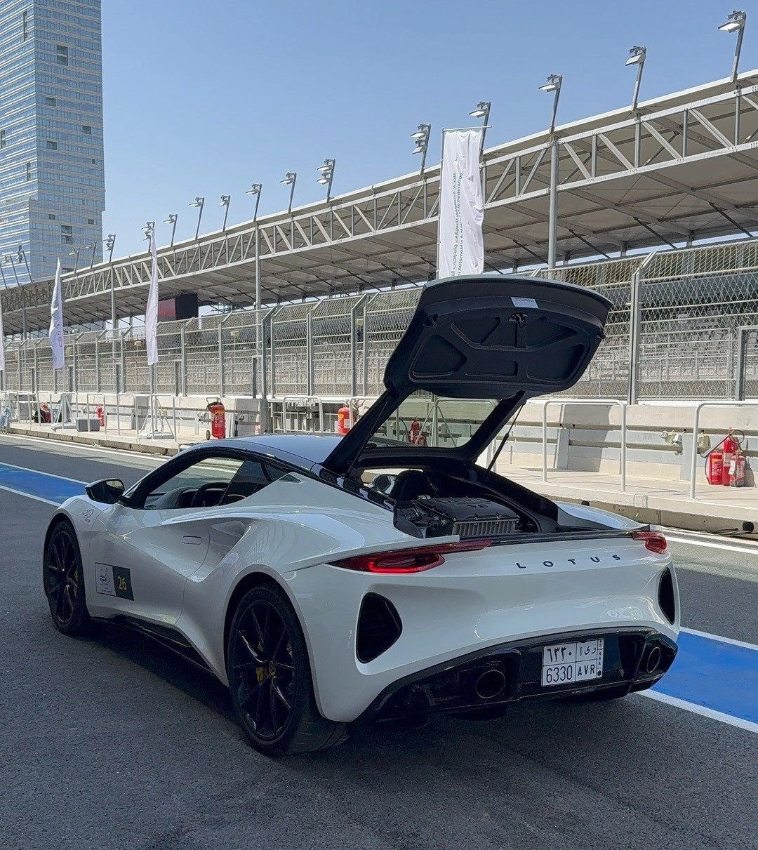

First Track feedback:
I was surprised how the car handled really well out of the factory, mind you it was the first time I even switched it to Track Mode.
The sound of the exhaust is really good to the point where you wish you can keep it that way forever.
Steering was responsive, as I started to push the car further and further, it was capable to rotate just fine.
The sound of the supercharger was noticeable, not loud just enough to enjoy it.
Shifting was the worst part of this experience.
The travel distance between gears was clearly long, and for some reason I have a mis shift going from 2-3 while accelerating on the straight line. It didn't always mis shift, but it was like hit and miss.
The brakes performed good for two laps, with the hot climate here it was obvious to have some brake fade, which I anticipated but didn't have the time to change it prior.
Power delivery was good, not great. Again, something I saw other members mentioned.
Tires were also good, not great. I had the Michelin Cup2 dated 2023 from factory which were good to use.
I have clocked 1:36 in my local racetrack (the shorter track layout) which was a very good start.
To compare, the BMW M2 was also 1:36 and the Supra was around 1:33 along with a Porsche Carrera who had also 1:33.

Great write-ups (thanks!). Nice to get the comparison between the Emira and your M2/Supra/Carrera.
I'm assuming the track car #26 on its side, is a stick-on. I didn't go that fancy: my first time out I used painter's tape, to create my numbers...yours certainly look far more professional/appealing. I didn't think I could use magnetic numbering, for the Emira, which is why I mention yours likely being "stick-on". LMK what it is and LMK as well, if you get more than one use out of it and if it tends to fray on the front edges, due to wind, or if you reinforce the front edge somehow to prevent that. Any advice on track numbering would be appreciated.
Thanks, and those were not my cars (M2/Supra/Carrera) just some other drivers with us on the same event I mentioned as a reference. Maybe I wasn't clear on that one.
The stickers belong to the event organizers; we had two on each side and two orange stickers front and back for the car number.
These are one time use stick-on as you mentioned, and I do remove them immediately after each event. Here is a close up picture:

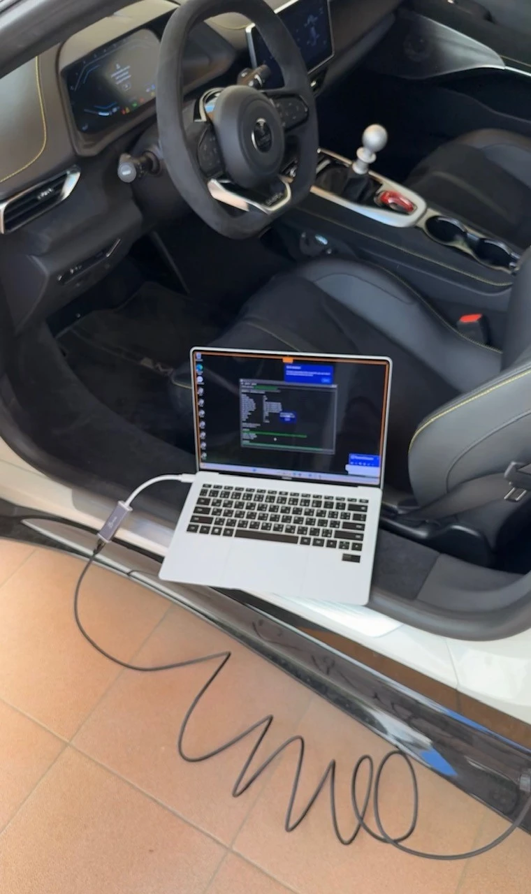

Second Mod list:
- JUBU460 kit
- JUBU cooling kit
Installing feedback :
Before ordering I was in touch with JUBU team to discuss what is needed and expected for my application. Remember I like to track this car and participate in some track days and Time Attack completions here in my area.
We both came to agree that the hot weather we have here is a big challenge. Imagine pushing the car in a hot day with around 40 Celsius. I was really worried.
Thus, we decided to go with the JUBU460 instead of just JUBU440 as I have explained earlier for less boost and better heat management with the cooling kit (selected the ultimate race 69 thermostat).
After many struggles with UPS and customs to clear the JUBU shipment, I was lucky to have it delivered to my door.
This also includes the front splitter and the roll bar kit which I haven't install yet.
The JUBU460 kit have few options when ordering, which includes the headers, extension cables and gaskets.
Additionally, I have added the Y-pipe, and I have gone with the De-CAT pipe instead of the HJS 200 sports cat and they were all have heat insulation.
Installing the parts was rather straight forward, nothing too complicated with the exhaust itself. The ECU was reached and changed as well easily. The cooling kit took some time to get done right. I would say for fairly competent technician this can be all done in one day.
Now since I have seen the previous post ( https://www.emiraforum.com/threads/jubu-group-buy-15-discount.4571/ ) and the small issues faced by some of the members here and there I was a bit worried that I might get some of it. So, I was extremely happy when we fired up the car and all was in order!
We drove test the car with few spirited drives, and it sounded much better with no issues at all. for the next few days, I had drove the car on different driving mods just to get more confident with it and since everything seemed normal, I have decided to go to the third time to the same track to really test this.
Feedback after installing:

A remote session with JUBU team was set to check the issue that I have encountered. Setting the connection was easy and straight forward. But I had two major concerns:
1- To simulate the issue again as it does not always happen in the car
2- To have a clear road to do some spirited driving for testing
Both points were not needed. I was really surprised when I discovered that the track data was available and accessible through the ECU. During the remote session, Rene was checking exactly what happened and was checking all available parameters and readings. That shows the great capability of the installed JUBU ECU.
It was no surprise when he told me that the temperature was high, which caused the issue to happen. As I mentioned above it was around 40c outside and pushing the car on the track looks like was too much, I did experience similar situation with supercharged engine before, so I can relate to that.
Anyway, he did his magic by updating few things and all was good. The issue now should be gone, I will do some road tests, but the next real test will be at our next event a Hill climb in a week so we will see how things go.
