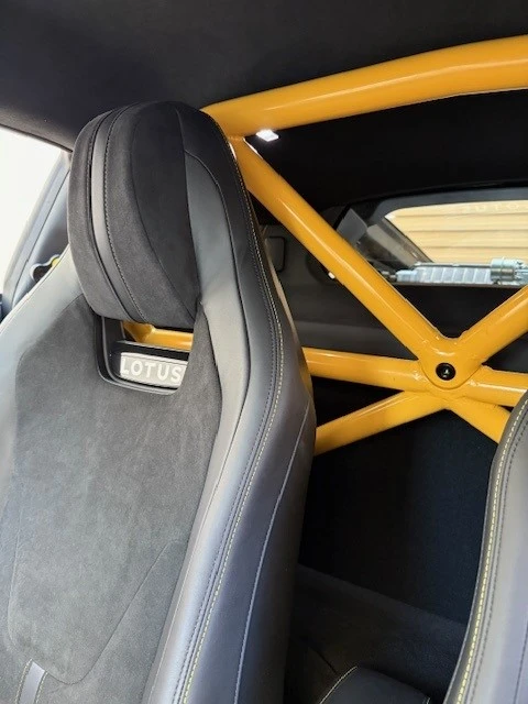

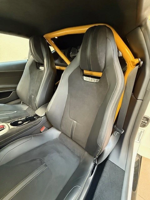

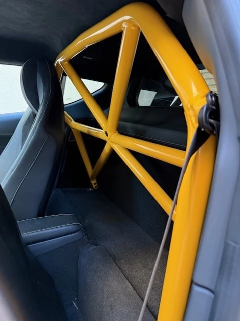

Installing the Rollbar:
- JUBU Rollbar
The installation of the JUBU Rollbar was a bit challenging. They have supplied all the materials needed with the instructions, I wish they had more pictures though to go through some of the steps.
We did the installation without removing the seats. It would have been easier, but we had tight timing. stripping the inside carpets and interior materials to get where we need to have clear sights of the fixing locations was not a pleasant scene haha but if you work on cars, you wouldn't mind it.
The drilling was smooth; we have the mockup to drill exactly where you need so it went all well. During installing the Rollbar somehow, we had a small gap on the driver side with around 5-6mm. I couldn't tell if it was installation issue or the rollbar was a bit shorter than it should. So, we dismantle the whole thing and re-install it and this time it was a fit.
Feedback:
I have chosen the yellow color to match the rest of the yellow inserts in the car, and I believe it was the right decision.
The car looks amazing from inside and outside as you can see it from far away. It gives the Lotus Emira a new personality.
For sure the space behind the seats is gone. I have also noticed the Rollbar will minimize the seats going all the way back a little bit. So be careful before installing it. on how far you usually sit.
I am 170 cm tall, so I don't really take the seats all the way back, so I'm fine. As you can see, you can still put a small bag in there if you want.
The visibility is not affected at all, and since this is Lotus, so the weight is an important factor. I did not have the time to weight it myself, but on JUBU site it should be around 7 Kg which I believe is close enough.
The best option moving forward is to have racing seats like Tillet so they would fit and look even better, but this is not on the list as of now.
Hope this give some insights on this kit.

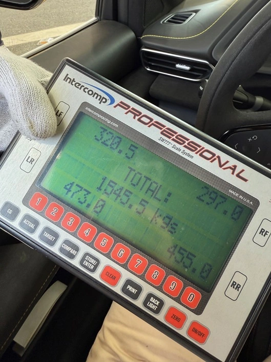

The Race weight of the EMIRA:
To my surprise, this car was heavier than I anticipated!
Below is the race weight which includes me as a driver with my racing gear:
This is with almost a full tank of Fuel (Around 50L). My weight is 67KG so if you take that out with let's say around 3KG of racing gear, you will end up with a total weight of 1475 KG. That's heavy.
You can also see that the left side have more weight than the right side as I'm sitting inside the car. We can improve that as well.
I have seen some members here who have done a great job in reducing weight, where I think this should be my next target.

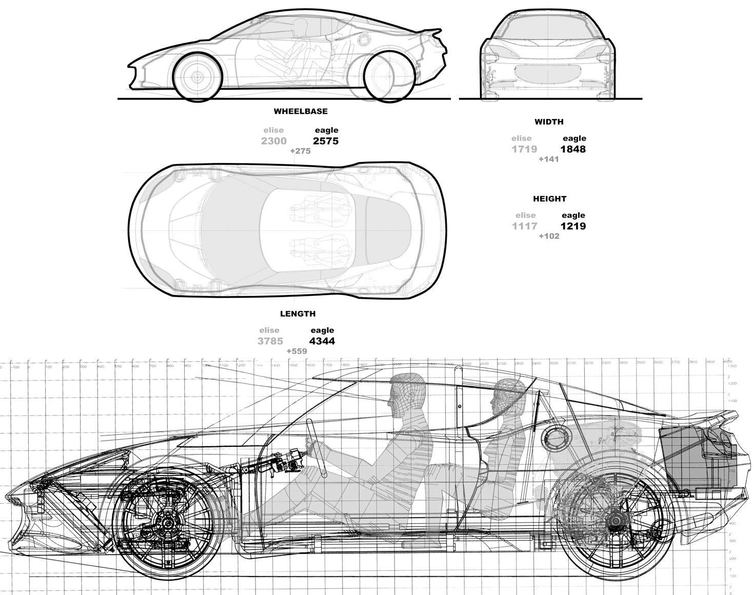

It might be difficult to see from this cut away drawing, but the main roll hoop is behind the driver and in front of the rear passenger. It loops from one side sill, over the top, and down into the other sill. The secondary roll hoop is behind the rear passengers. The two hoops are anchored together on each side at the top with a tubular steel section. The rear hoop is triangulated again down to the chassis at the upper rear suspension point with another tubular steel section. Meets all world wide roll over crash standards.
That image is labeled "Evora". I know the Emira chassis is very similar to the Evora, but I wouldn't assume that's a rollbar. All passenger cars have to meet rollover standards, but rollbars are usually in addition to the stock car's rollover protection.
Very true. Motorsports roll bars are in addition to any existing roll bars or roll over protection. What makes the Evora/Emira unique is that they don’t utilize a monocoque chassis, so there is no inherent roll over protection. They add a roll bar at the factory. You can add another roll bar or two, but I believe you are well protected with the factory equipment.
Thanks everyone for the positive comments on the roll bar.
As it was a mandatory by our Motorsport federation, I had to do it, regardless, to compete in our local hill climb competition.
Now that it is done, I have removed the roll bar.

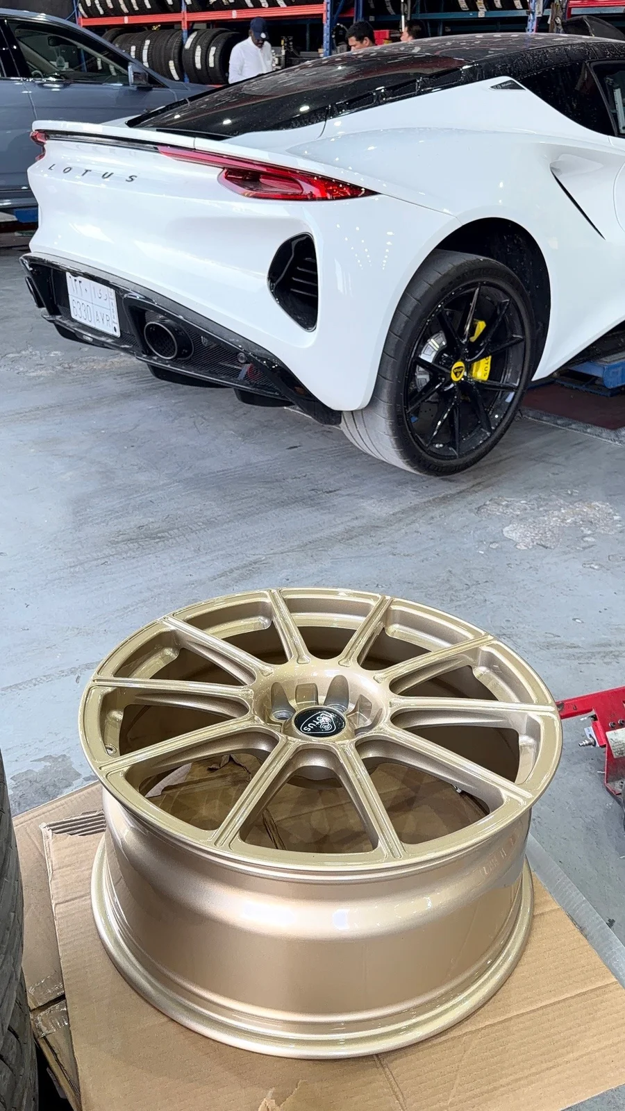

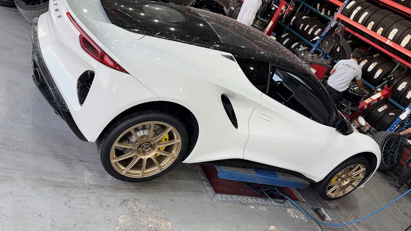

Moving forward, I finally had the time to install my new JUBU forged magnesium wheels with some fresh tires from Nankang.
I have ordered them back in April-end, and they were received by mid-July.
Since I was planning to use them on road and track, I went with the wider option which is:
9x20" & 11x20" (0.5" wider front and rear).
This choice of size would allow me to add a bit wider tire if I needed in the future.
However, I have installed the same factory tire size front and rear to test this first.

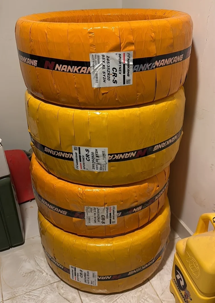

Initially I wanted to try the Perilli Trofeo RS which I heard a lot of positive feedback on, but there was none in stock anywhere I looked.
I was lucky to find a ready to ship set of Nankang CR-S, which have been a popular choice here in our region for street/track use.

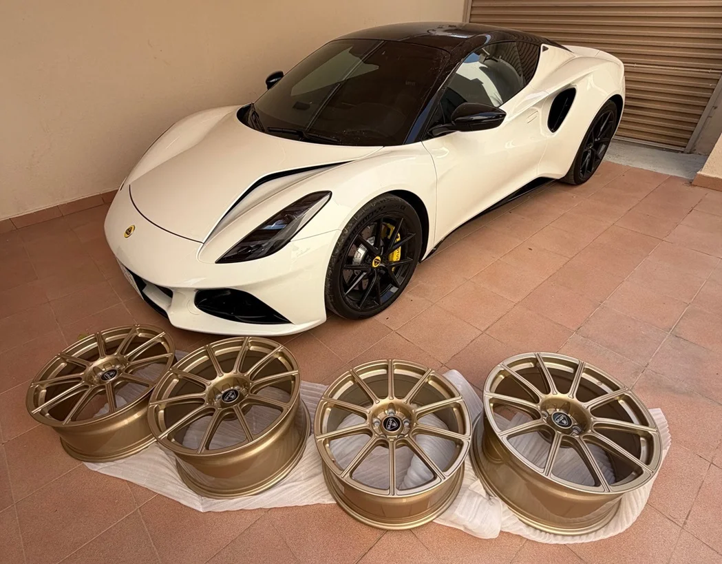

Then comes the color choice .. I'm not a big fan of the white color body of my Emira so there are thoughts of changing the car color in the future, which made things more challenging to choose. But since I have a thing for gold-colored wheels, I just went for one:
A decent way to change how the car looks and at the same time, give it that feeling of Racing wheels look.
This Gold color is a bit darker than the Gold bright, which make me feel that they are a bit mor classy in a way.
Here is the wheel on different lightning exposure:
Fitment was smooth, no funny issues.
But the drive ! I mean I have done many aftermarket wheels back in the days, but with this one ! the driving felt so agile and light.
As per JUBU website, the total weight saving with this size would be 18.2 Kg. I didn't weight them myself, but I'm sure they will be close enough to that number.
This made me wonder why Lotus have such a heavy wheel to begin with, or even at least offer a lightweight wheel option when buying a new Emira.
Because this has improved the driving experience by a big time.
I have a feeling, even the forged aluminum wheels will make a decent positive impact as well.
Anyway, happy to have such a great experience with the wheels.
I also have a weak spot for gold wheels! Please share more photos of these wheels, especially on the road. :)
Lotus don't have a heavy wheel, the OEM wheels on the Emira are pretty light for aluminium alloy wheels. As you have done you have to spend a lot more for magnesium/carbon wheels. But I agree, they should offer a extra light-weight option as it would probably make a significant improvement to the handling but it would be expensive.
Emira OEM wheels (source) are Front: 11.5 kg Rear: 13.5 kg **Total:** 50 kg
Jubu wheels design 1 - front axle: 8.5Jx20" (9.6 kg/rim), rear axle: 10.5Jx20" (10.6kg/rim) ** Total 40.4 KG - £4K
Jubu wheels design 2 - : front axle: 8.5Jx20“ (7.45 kg/rim), rear axle: 10.5Jx20” (8.2kg/rim) ** Total 31.3 KG - £8K

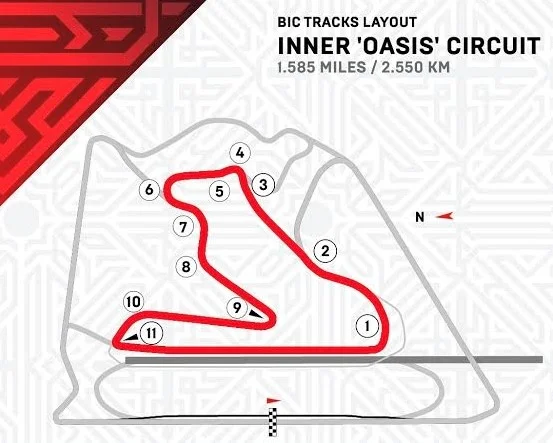

Next, I had a track event at Bah international circuit.
We did the shorter layout called (Inner layout) which is 2.55 KM long with 11 corners.
It is a technical layout, easy on brakes and tires.
The weather was still hot here which was around 35 C during the night.
I know this has an effect on the power delivery of the Emira, but so is everybody else on track that day.
