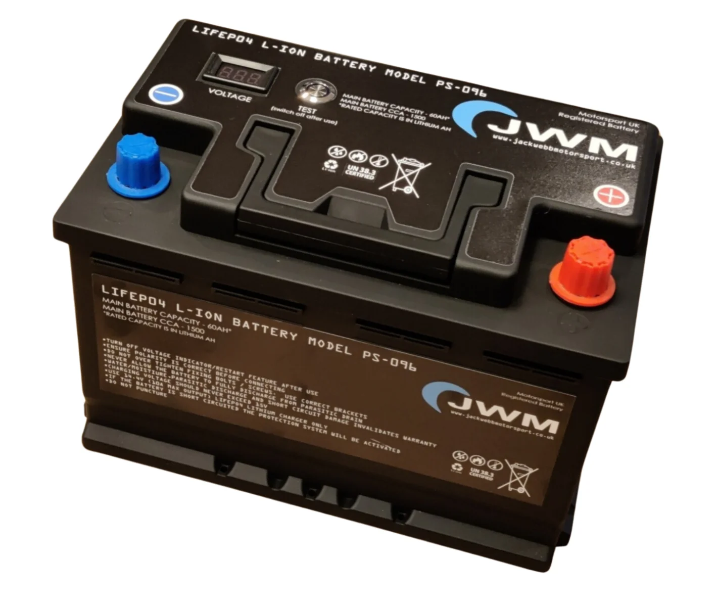

So fitted a Jack Webb Motorsport Li-Ion battery this morning……10.1kg saved. Also thought the battery bracket was a bit over engineered so trimmed that down a bit. Not sure how much weight that saved, but I felt better after doing it!
Can u show the picture please for reference. Thanks

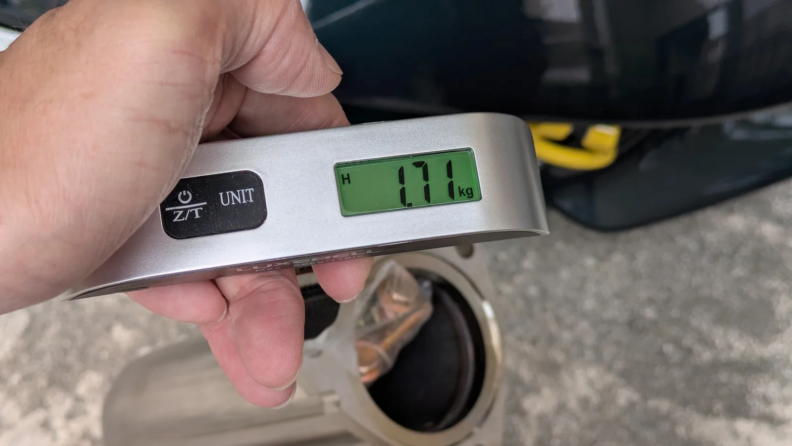

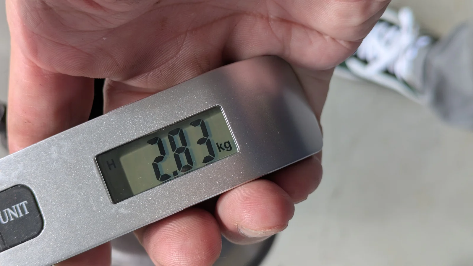

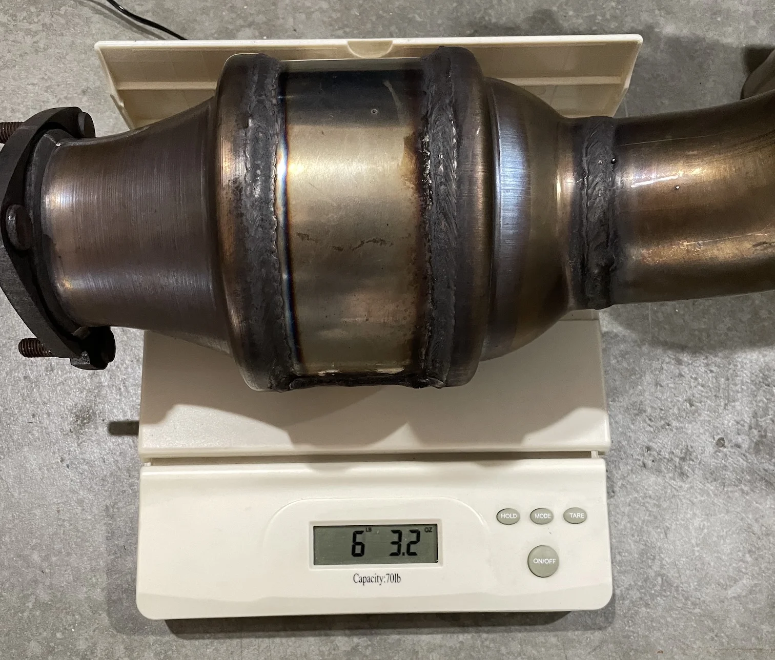

Not sure if you have these numbers, so I will post them just in case:
OEM third cat with hardware = 2.83kg
GRP de-cat pipe with hardware = 1.71kg
Net 1.12kg reduction including hardware.

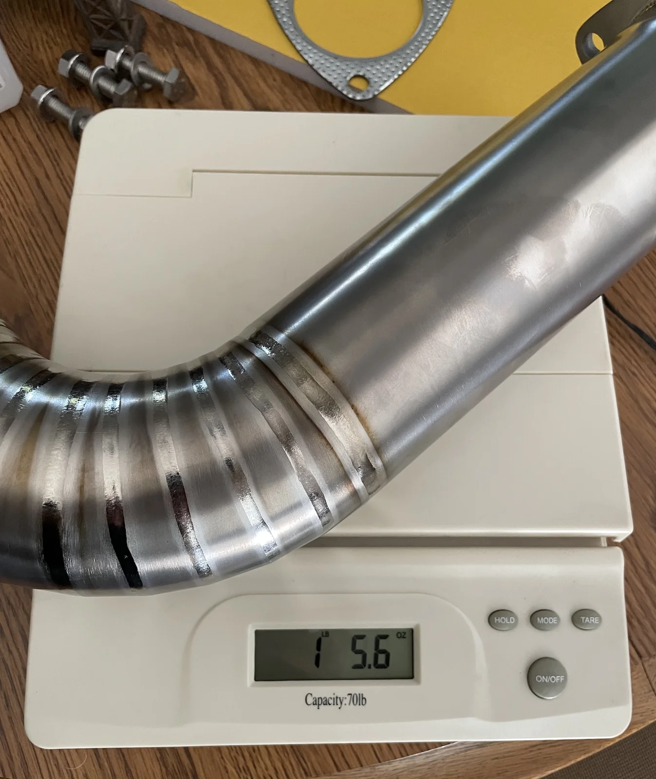

I finally got the ti delete pipe from @Aerie after 3 updated delivery times from UPS (not a delay from Aerie, they shipped it quickly) and it's a beautiful thing to behold. The welding and forming is really impressive. It's 4.76 lbs lighter than the 3rd cat.

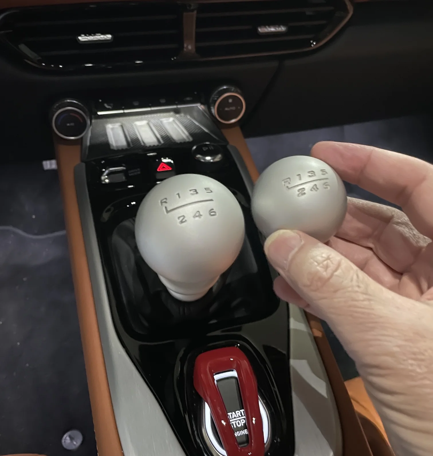

Got the larger shift knob from @mr.suntorytime which is 51mm vs the factory 46mm. In addition to the larger size, it has a little more heft to it, and the extra weight helps when shifting. I used a .5 lead mechanical pencil to add a little contrast in the bottom of the lettering.

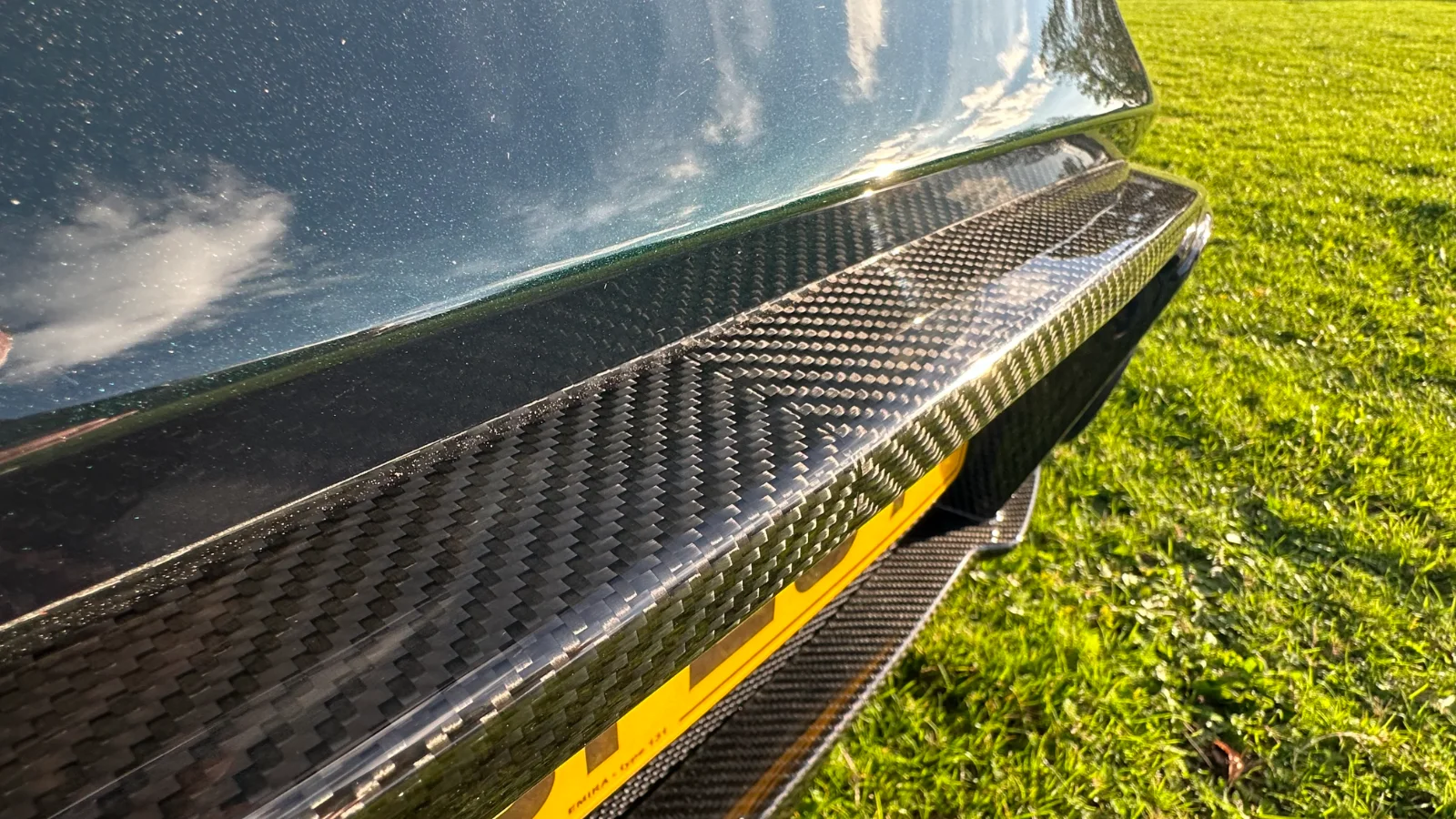

Thinking about ordering this from Aerie, has anyone considered or done this mod?

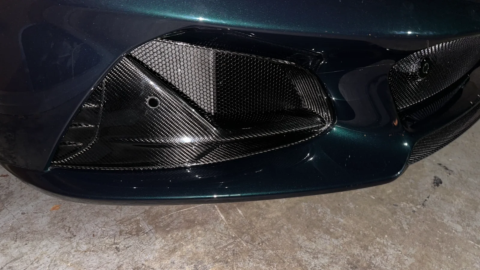

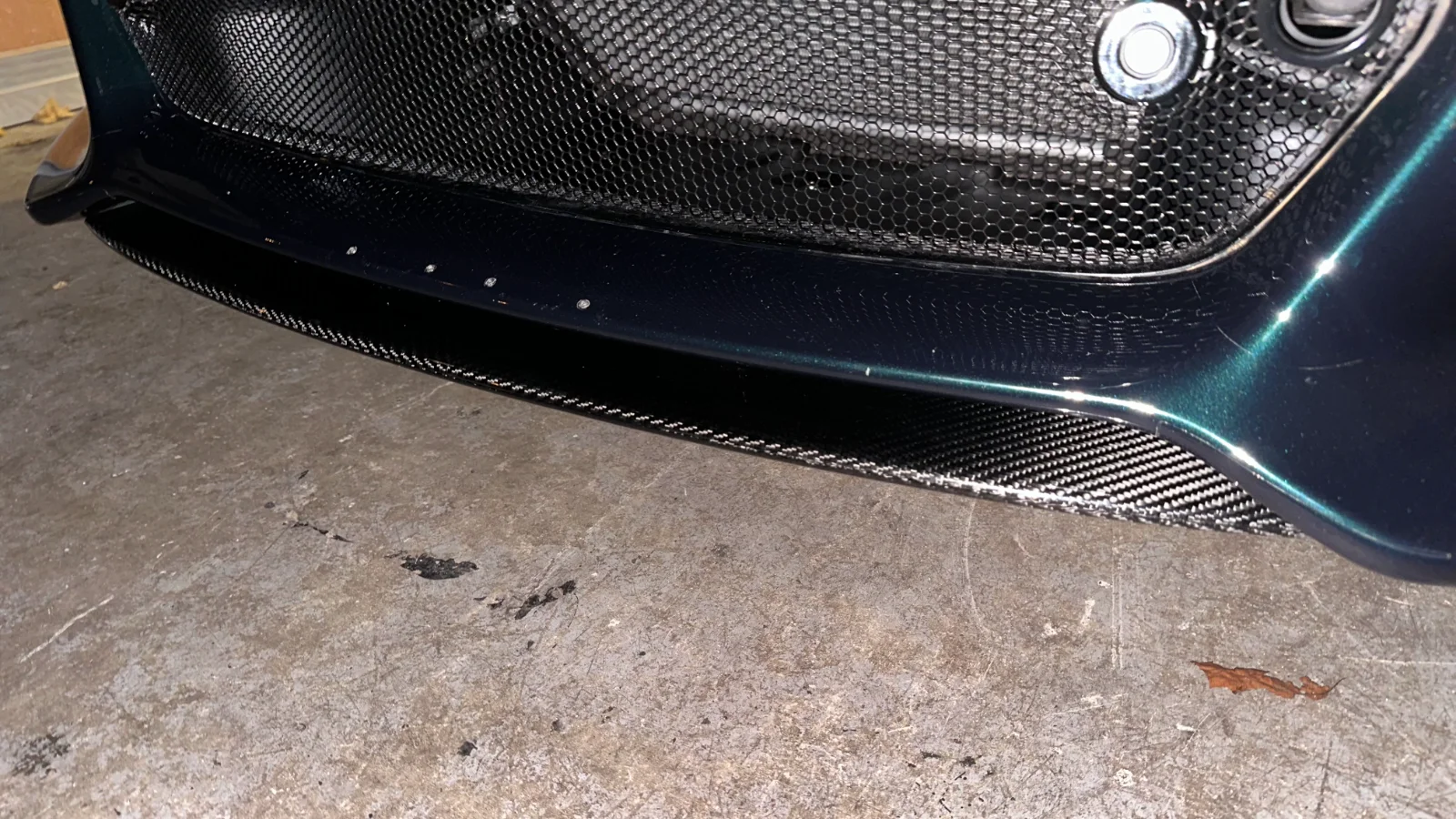

Ive got that, along with sills, front, side & rear vents, rear diffuser etc.
Be aware, you have to remove the entire front nose section to fit it.

I have ordered this but it has not been delivered yet. When you say "removing front nose" do you mean the piece it replaces has to be removed or did you have to actually remove the front bumper? Sorry. Just looking for clarification on what you mean.
To get at the retaining screws for that lower splitter, you have to remove the entire front bumper assy..
I had hoped that removing the alloy front undertray would give access, but it doesn't, the radiator ducting is still in the way.
It's a fiddly job, but the only difficult bit is releasing the integrated plastic clips that attached the bumper, to the wing (fender). It's not clear which direction you need to pull, and of course you're scared to break anything.
