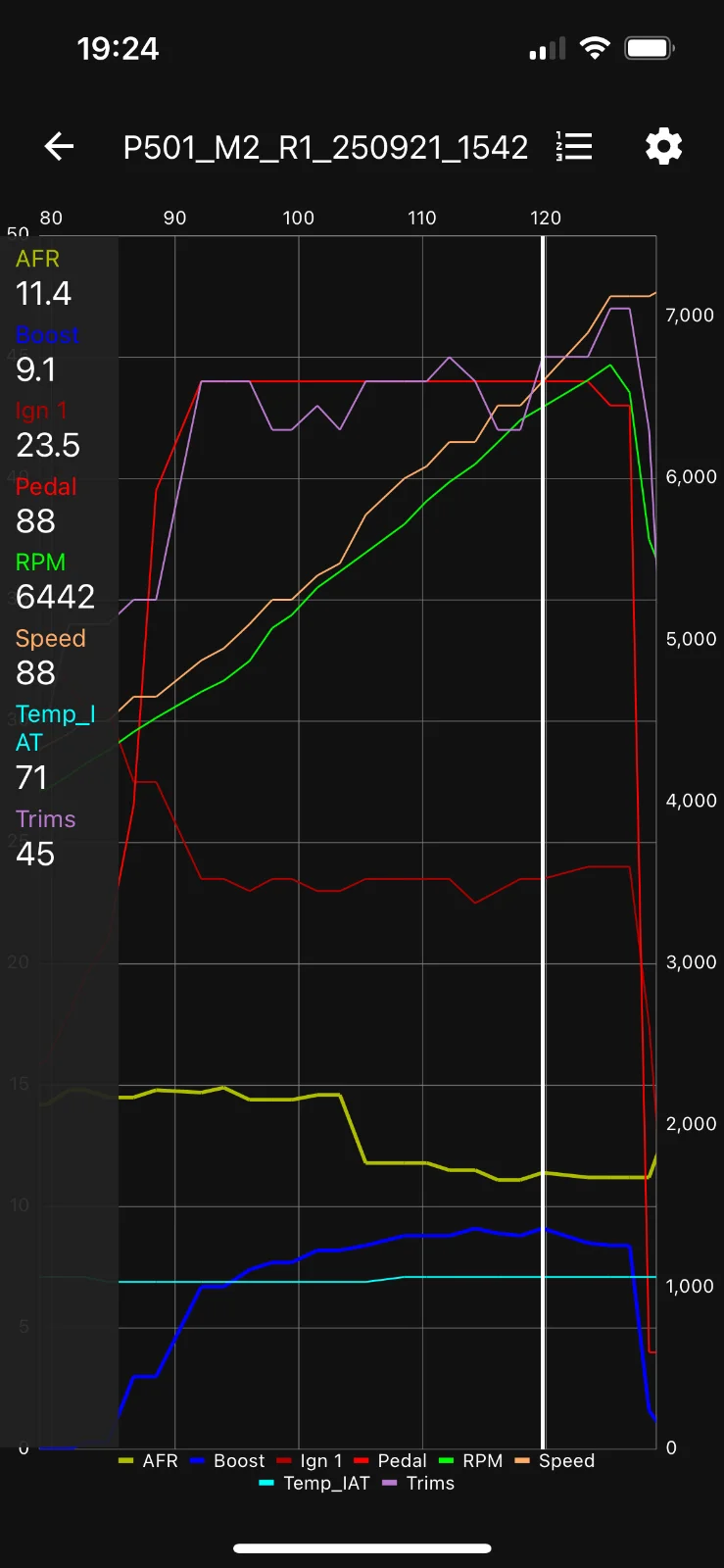

Very nice summary Eagle - so high level; if I'm reading correctly you picked up 30 wheel HP. With Cat delete, Intake mod , exhaust rework, and JB4?
If you want analysis on a daily basis you can email yourself logs out of JB4 app and throw it into ChatGPT or whatever AI you use, it does a great job of reading the tables and telling you specific things that are going on...specifically in terms of knock and timing advance or pull related to bad batch of gas for example. There is so much variance tank to tank that the effects on a high output system like we have can swing a lot depending on the gas. There was one tank my car really didn't like from the same station and pump number that it was pulling timing a lot.
Yes and 24 FtlLbs of torque.
Do you know how much boost your car was pushing ?
Mine between 5300 and 6800 RPM is 8.4 9.1 psi of boost.
Do you live at high altitude ?
What was the outside temperature that Day ?
I always found +95hp was too good to be true. +50-75HP is what I was looking for but your result is a cold shower.

I'm wondering if Eagle7 received a defective controller. There are some that have been shipped back and replaced. It's definitely worth sharing the logs with Burger to see what he thinks. The results just don't match what we've seen from other installs.

Boost was 8.8 max
Altitude is 2,800 ft
Outside temp was 60's
The results for Map 1 are actually pretty good, all things considered. Map 2 not being much if any difference just means I need better gas. I'm going to contact a few of the local stations near me, and see if I can get one of them to add real 93 to one of their pumps. There are enough performance cars in the valley now, that I think I can make a case that it would be profitable to be the only true 93 station around, especially once the word gets out.

Hadn't thought of that, although the car has been running great with the JB4 Map 1. Better than stock actually.

I sent the log to Burger and he got back to me. He said he could see the timing corrections and it was definitely the gas. What he saw was not what was supposed to happen on Map 2 with 93 octane. He recommended I add 2 gallons of E85 to boost the octane, and that would give much better results.

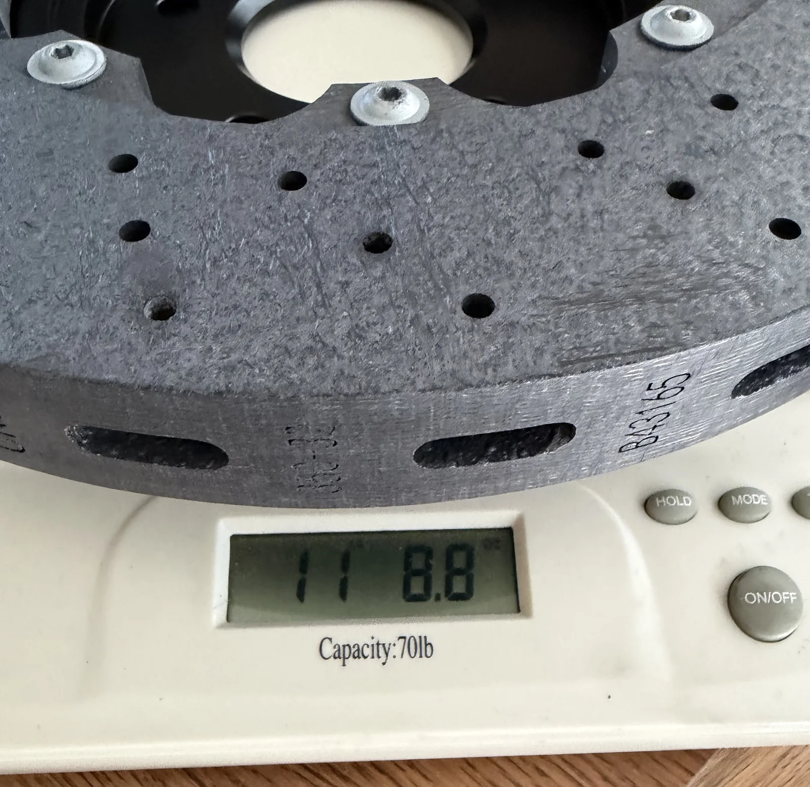

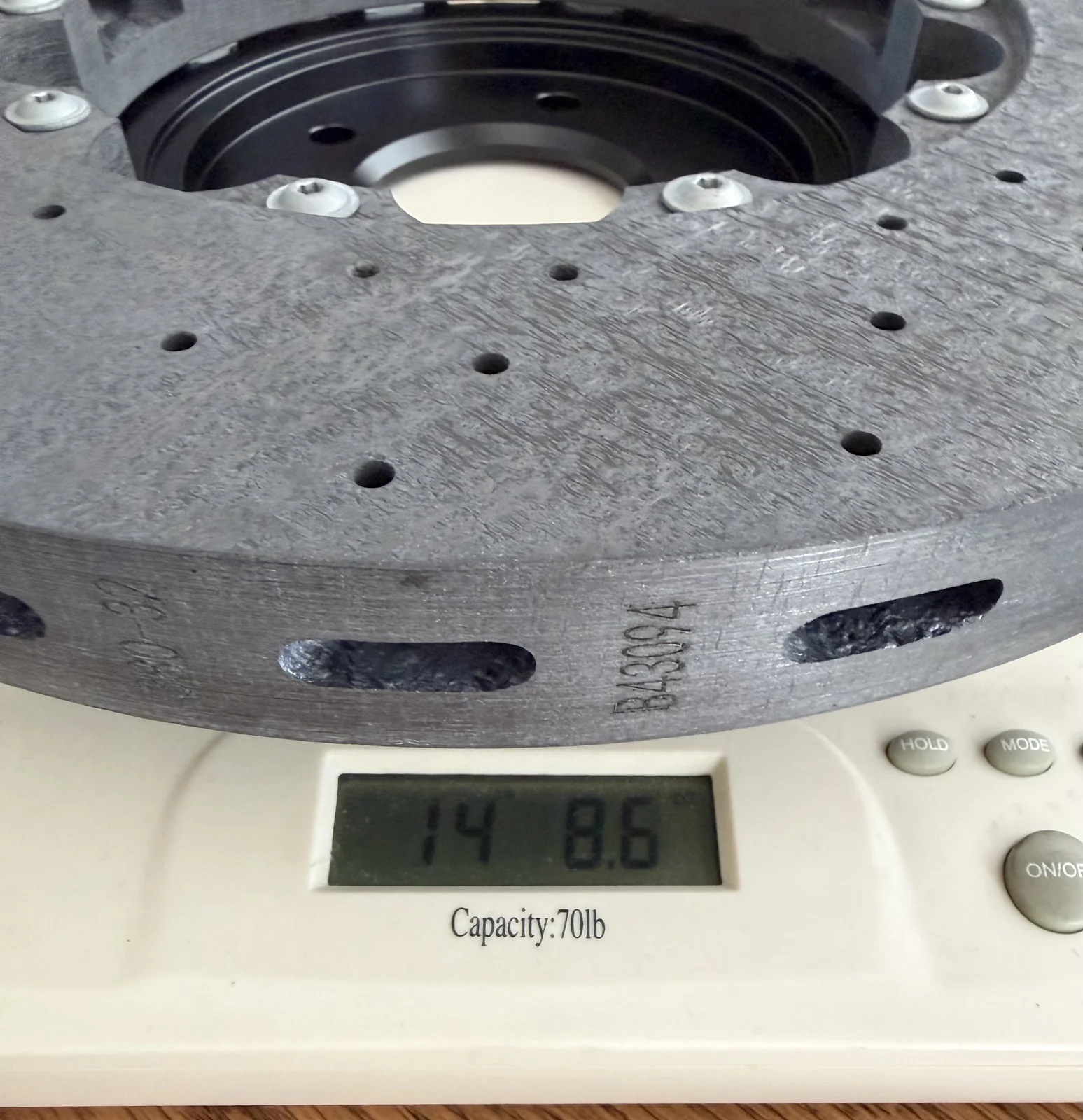

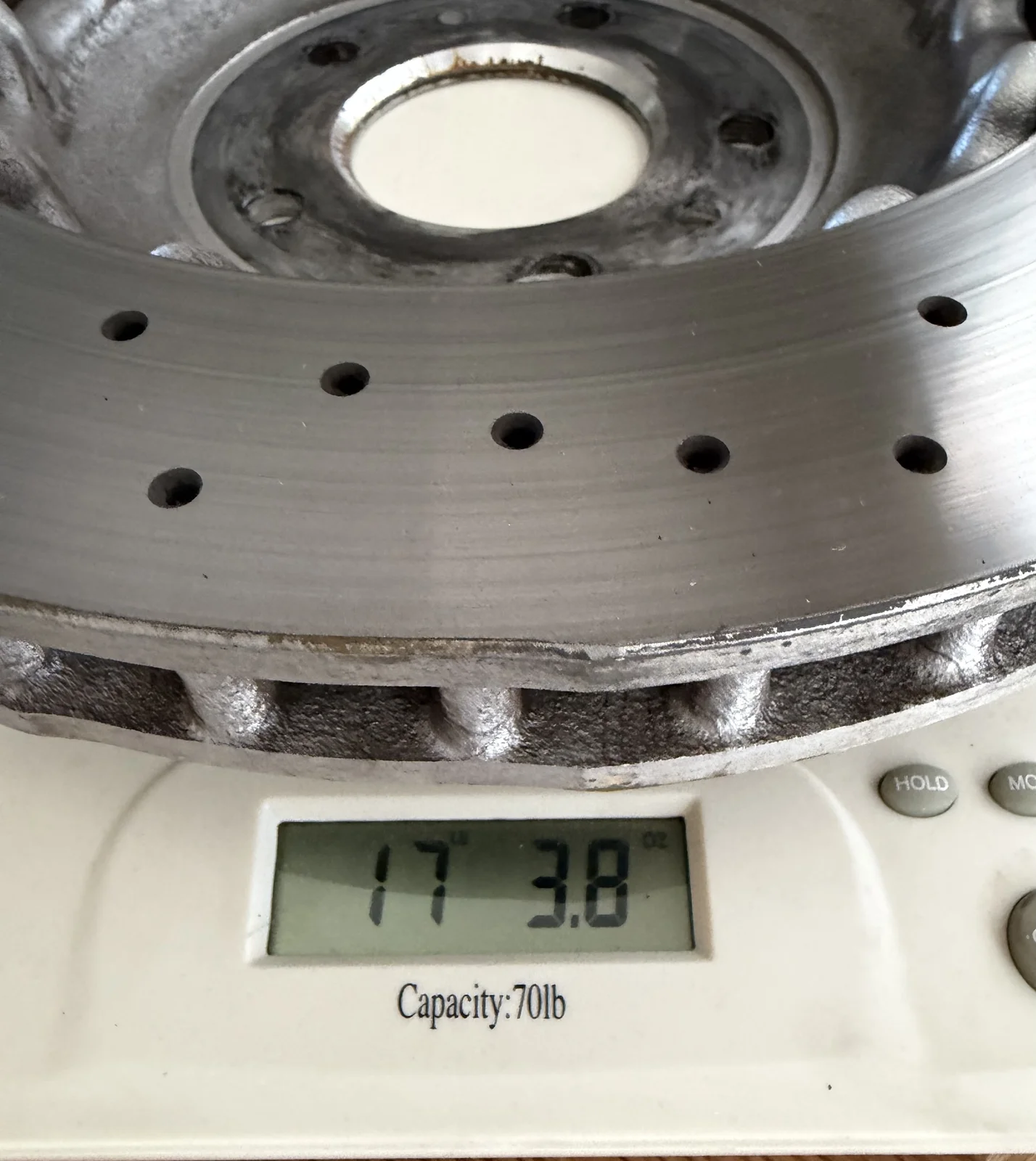

Got a few things done on the car. Finally installed the RacingBrake CCB rotors, which give the car a more exotic appearance I think.
One of our forum members has already done an excellent how-to for the install, so rather than duplicate his efforts here's a link to his install:

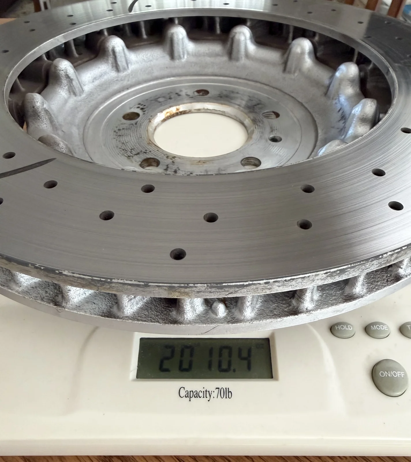

The factory front rotors weigh 20 lbs 10.4 oz, and the RB CCB fronts weigh 14 lbs 8.6 oz for a weight savings of 6 lbs
The factory rear rotors weigh 17 lbs 3.8 oz, and the RC CCB rotors weigh 11 lbs 8.8 oz for a weight savings of just under 6 lbs.

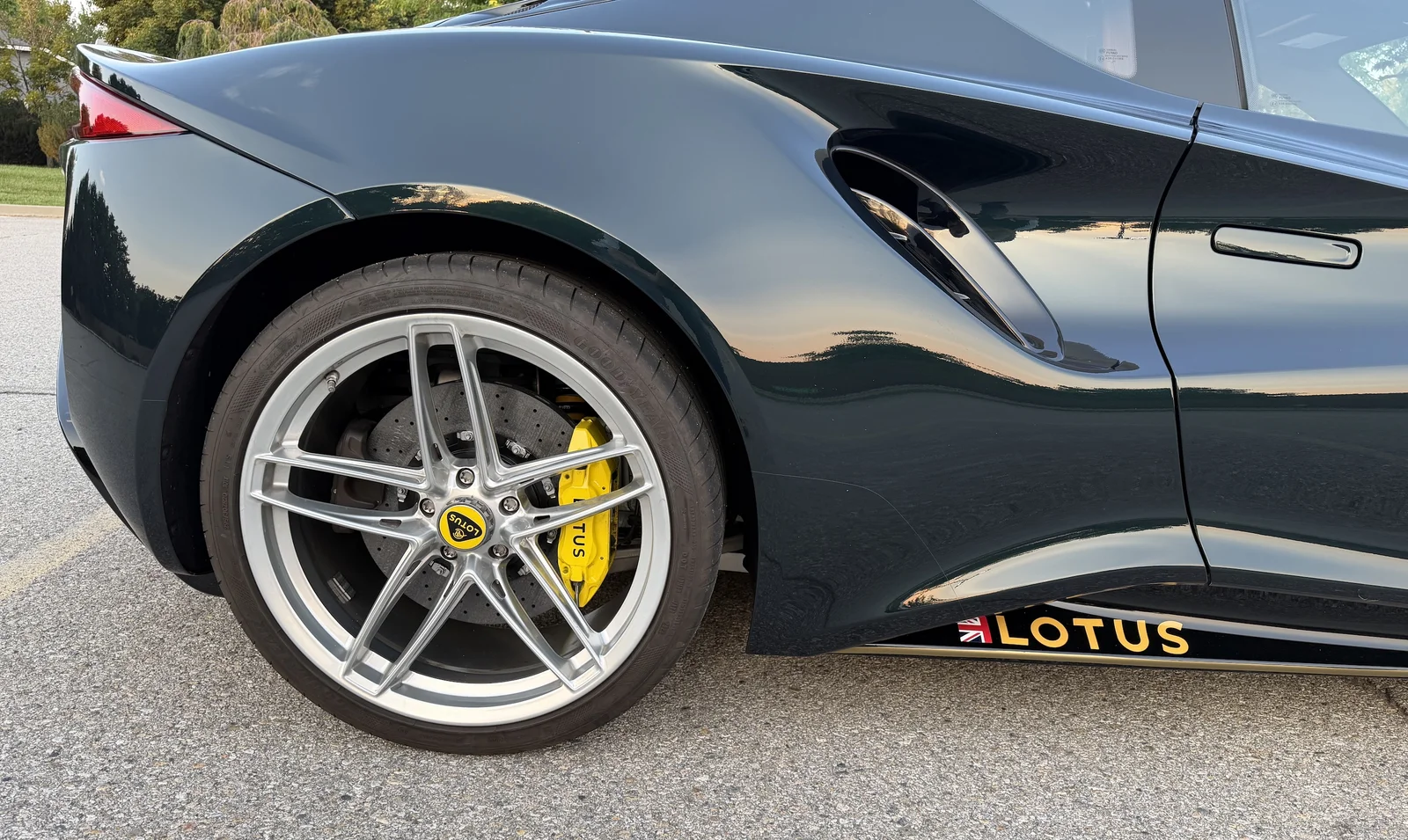

Driving Impression:
Car steers easier, especially for left-right-left-right type of manuevers. Feels just a bit lighter on its feet; picks up speed quickly, especially once you reach 3k rpm. Braking is very smooth and linear, there's no sudden grab like the factory brakes have. This allows for very precise application of the brakes. No squeaking. I completely cleaned the wheels inside and out before putting them back on the car, and in the picture above, that's how clean they still are after the rotor/pad bedding in process, and driving around a few hours with them. With the factory brakes, the wheels are dusty by the time I reach the end of the street. Very happy with them. At my age, these are lifetime brakes. I'll never need to do a pad change again.

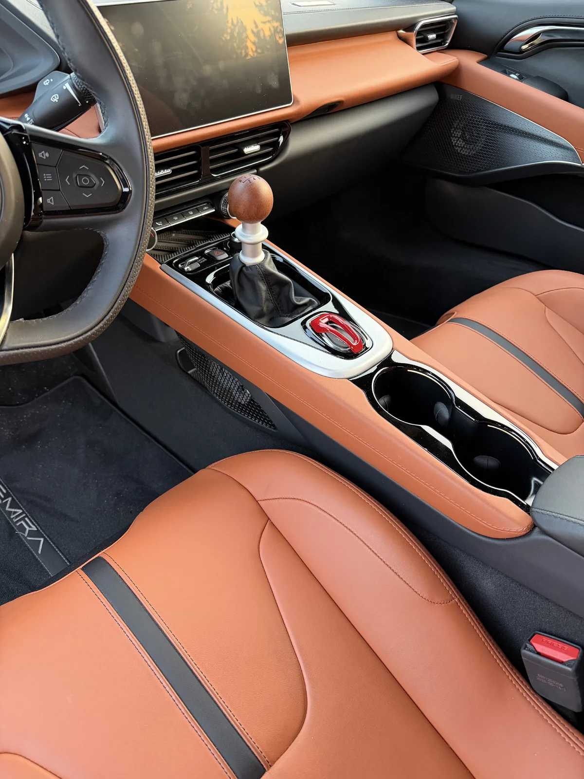

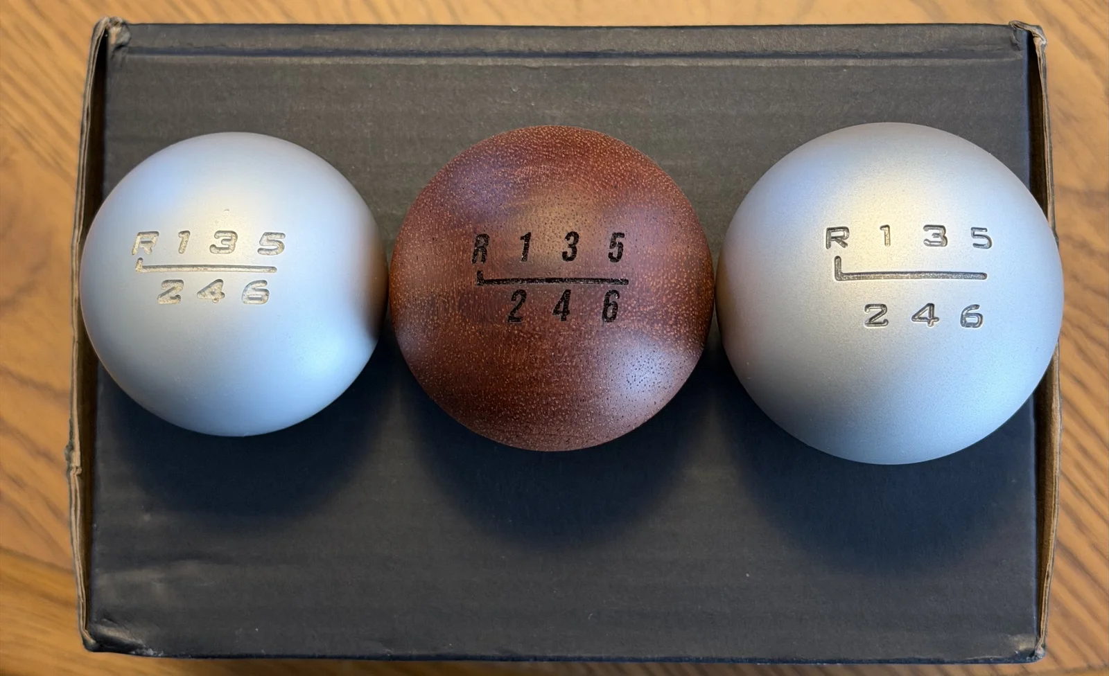

I also bought and installed a very nice wooden shift knob. It's one-piece mahogany, and 49mm in size. Here's a picture of the factory knob on the left which is 47mm, the wood one at 49mm, and a 51mm metal one on the right. The wooden one is the perfect size for me and feels great in the hand. It just feels more natural than the metal ones do.
Looks good with the tan leather interior.
