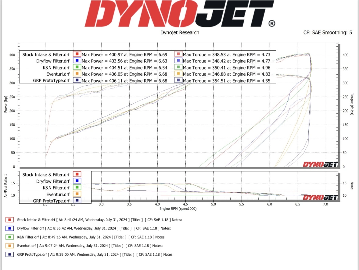

Did you see the dyno chart from the intake shootout that @GRP did? It shows hardly any gain, and all 4 aftermarket intakes within 3 hp of each other, which is almost the margin of error for a dynojet. For his test they put their car on the dyno and did a baseline pull, then switched from intake to intake to intake one right after the other, doing a dyno pull for each one. All of this within hours the same day. There was literally no time for the ECU to adjust to the changes, and as you can see, there hardly were any.

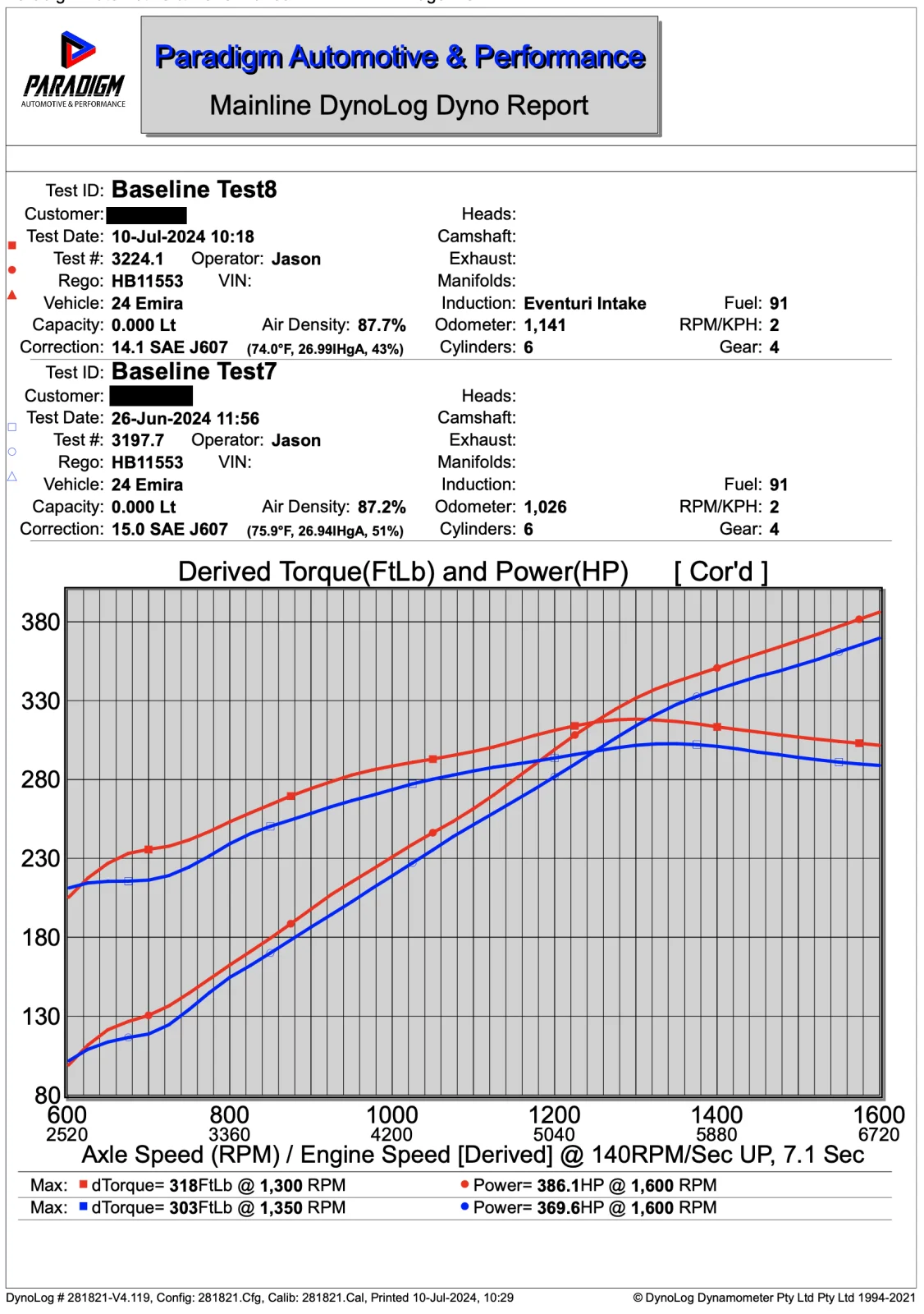

Compare that to my Eventuri chart from July 10 last year, which shows an increase of 16.5 hp and 15 ft lbs over stock, and that was done after I'd put about 100 miles on the car after installing the Eventuri. I've done several additional dyno runs for various things since then, and every one of them shows the same lift in performance from the Eventuri, so it wasn't a fluke. So why are the results from GRP's test so different? The only thing that's different is there was no time for the ECU to adjust for his tests, while there was time for it to adjust on mine. That's sufficient evidence for me that the ECU does learn and makes engine performance adjustments over time. I think the fact that connecting the JB4 into the OBD port so it can read and coordinate what it's doing with what the ECU is doing is one of the reasons why it works so well. These new cars with all their computerized systems are something else.

The one thing I've noticed and realized, is that with every dyno run I've done since installing the Eventuri, every chart shows the same thing happening once the rpms reach about 4,800. All the chart lines clamp together the rest of the way to redline, regardless of whatever change was made. I'm guessing the restrictions of the exhaust system just won't allow any more upper rpm performance. I still have the 3rd cat installed (never deleted it) so I've now ordered a titanium 3rd cat delete from @Aerie (they're on sale right now; hopefully it won't take months to get) so I can see how much difference it makes. I know from installing their cat-back titanium muffler, that there was a slight increase in torque at lower rpms, so I'm hoping the delete pipe will open more of that up.
