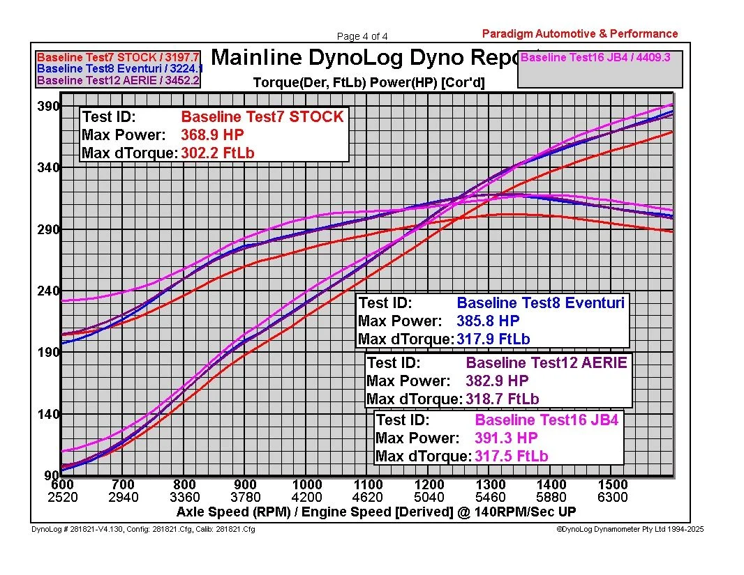

Well just got back from the dyno, and here's the image I know people want to see, so I'll post it up now. Other stuff will come later.
As you can see from the dyno (this is on a hub dyno), the hp increase was modest, about 6 hp compared to the dyno run after the Eventuri install, but the biggest gain which is what I feel, is the torque increase, especially at the lower rpms. I still have the 3rd cat (didn't delete it), and this is on Map 1 with 91 octane Shell V-Power gas.
As far as gains go, for all the things I've done, the Eventuri actually delivered the best improvement for hp and torque. However the JB4 has definitely improved things, especially the torque up to about 4,700 rpm. The amount of torque stock at 2,520 rpm was about 205 lb ft, but as you can see the JB4 has increased that by about 30 lb ft at 2,520, which is what I felt the first time I used Map 1. (The line that says Aerie was for the titanium muffler which only added a modest amount of torque at low rpms, but nothing extra at the higher range.)
Overall, between the Eventuri and the JB4, I have 22 more hp compared to stock, and a lot more torque at the lower rpms. Using the stock drivetrain loss factor of 7.6%, in order to get 391.3 hp to the rear wheels the engine has to be delivering 423 hp at the crank. Again, this is on 91 octane. People who have 93 available report much better numbers. I asked the guy at the dyno shop if there was any place that had 93 and he said no. All the guys there, and all the builds they tune for are using flex fuel E85 ethanol. There are two places that have E85, and Burger has an E30 flex fuel upgrade option which I might look into. Right now I want to get the CCB brakes installed as my next thing to do.
Something else that doesn't show on the dyno is the sound. I've noticed, especially the last few days as the ECU has adjusted to the JB4 tune, the car is really starting to sound great. The exhaust tone has changed from a boomy roar, to a snarling growl which I REALLY like. The car sounds much more exotic now.

Cool, thanks for doing it. Good to know your butt dyno says positive things. I wouldn't put too much weight into the numbers on different conditions on different days. But, it is probably a bit less than 60 hp.
Did you run Map 0 and Map 1 on the same day to see the difference or did you only run Map 1 and compare against results from prior dyno? Thanks for running it!
No. I've been running Map 1 exclusively since I got it activated. The ECU doesn't instantly switch modes, so I only did the test with Map 1. The comparison is to previous dyno runs there (same guy, same dyno) to give a relative comparison. Today was hot and humid, so not the best weather but at least I have a visual chart to show what I first felt when started using Map 1.

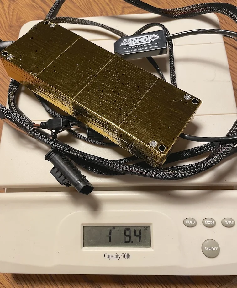

When I first saw pictures of the JB4 unit, for some reason I just assumed the housing was plastic, but it's not. It's high-quality machined aluminum. Because of where it sits (I used the bracket from @mr.suntorytime ) which is in the heat flow pattern of engine bay heat rising up through the vents on the side of the rear window, I decided to wrap the unit in heat reflect foil.
The whole unit including cables weighs 1.5 lbs. The Eventuri weighed 1.5 lbs less than the factory air box, so the JB4 unit puts it right back lol.

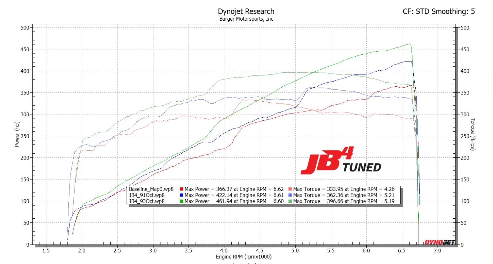

When you compare what @Payam@BMS got on his dyno with the test car, I got nowhere near those results. I believe the test car had deleted the 3rd cat, which could possibly explain the big difference above 5k rpm, where every run I've had all the performance graph lines are pretty much the same, while his shows a big jump in performance above 5k. Both our baseline runs are about the same for hp, except his car had 30 lb ft more torque than my baseline did. His Map 1 results though are much higher than mine.
Was his Map 1 test actually using 91 octane, or was it the 91 tune but with 93 actually in the car? It's just surprising there would be a 30hp and 45 lb ft difference between his dyno run and mine.

yeah my car which was the mule has cat delete and blue filter(grp)
I appreciate that you believe there's some sort of learning going on over time. I'm not totally sure how that would work with the fact that people go in and get tunes on the dyno, and the idea is that they are leaving with a map that is fully functional. Maybe there are some tiny things still getting adjusted, but I believe them to be at the margins.
If you have the chance to go back, I would highly recommend starting with map 1 and doing back to back switching to map 0. I think that would be a much more valid experiment.
