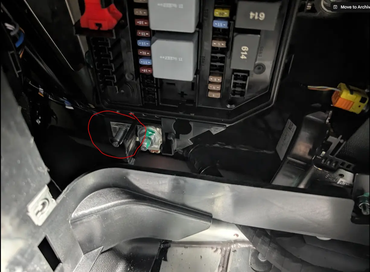

Thanks for all the info from this thread and crestima's guide. Made my install very quick. I also installed the Kicker HS10 sub setup in the back similar to crestima.
I elected to power the sub by runnung the power wire to an unused power lug that was open on the left hand fuse box. This made things alot tidier in my opinion.
This provides 12V power from the battery and it's unused. I just found an m8 nut and secured the ring terminal there.

Great find that one of the rear fuse box unused power line. I wish I had known about that to have avoided snaking a dedicated line all the way to the battery. Nevertheless, for anyone else doing this mod, it will be a lot easier to connect the power wire there instead. The Kicker installation instruction, as is the case with generally all powered subs, recommends a direct line connection to the car's battery. From the look of that fuse box panel, one of the two bolts at the bottom seems to be securing a hot wire presumably coming directly from the car's battery and it's not fused, so it makes a lot of sense to use that as your power source as long as you continue to use the in-line fuse that comes with the Kicker kit.
Yea, I was really trying to avoid running the power all the way to the battery if at all possible. So I was studying the fuse box locations and seeing if they had battery powered lugs like that and miraculously there was. Even unused to boot. I mean it's no biggie to share that with the battery powered lug, but that just made things even easier.

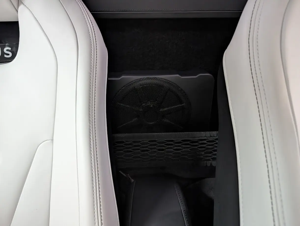

So everyone that did the kicker left the factory sub in place? I figured I'd take that out. I'm thinking that when I kick out song with a lot of bass, If I go overboard, it does make complaining sounds. Why not just get rid of that?
Yes, I agree. It's generally not recommended to mix different subwoofers. By leaving both in place, there may be excessive midbass since the stock subwoofer has low end extension limits and has audible compression at high playback volumes.
I unplugged the OEM subwoofer as the woofer basket would rattle at anything beyond mid volume or higher. Plus it didn't sound like it contributed to the system after the kicker sub install to my ears. I will be removing it once I finalize the system.
You can simply unplug the grey multi-pin wire connector which is attached to the OEM Sub (where the speaker wires are tapped), so you'll have only the Kicker linked.

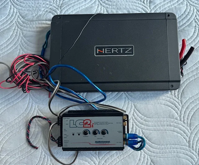

My original plan was to use a 1,000 watt amp I have from my old car. Then buy a JL 10 or 12. That is overkill, and the JL subs are $750-800ish. I have a nice audioquest processor too. So I could tune the bass a lot more.
I'm torn.
I did hear the Kicker today. Thanks @cestima It sounds good. The system with the tweeter mod and the kicker is solid. It's crazy we can't pair my phone to your car though.
This is the amp I have. For sure overkill, but i have it. The LC2i let's me tune up the cure of the bass. If I remember correctly, when you kick it out, it changes the curve. So it sounds better over all volumes. I was thinking of a JLAudio 10 or 12. They make such good stuff.

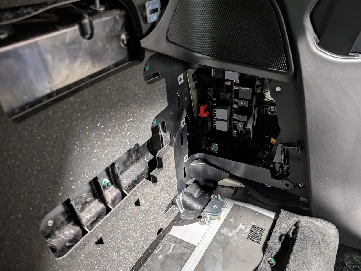

Wanted to use the method running the power to that spare bolt under the Rear Left fuse box rather than drill into the rear hatch to the battery as it seems less messy.
But I cannot remove the fuse box panel!
Tried for ages and it just won’t budge, worried I’ll snap it.
There’s a catch on the left and on the right and I think I can feel one underneath but no matter how much I wiggle it, it won’t come free.
Can anyone help?

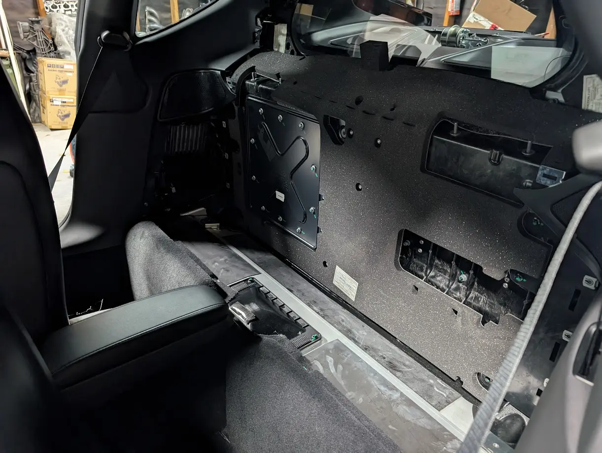

I’m trying to remove it with only the rear quarter panel off, does it only come off with the whole rear panel removed also?
