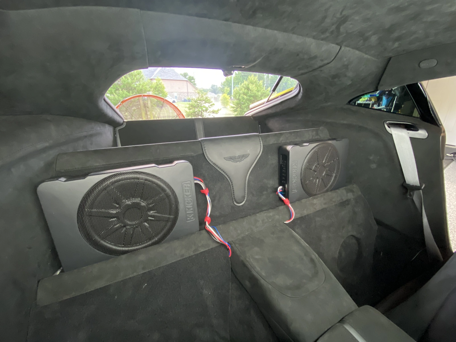

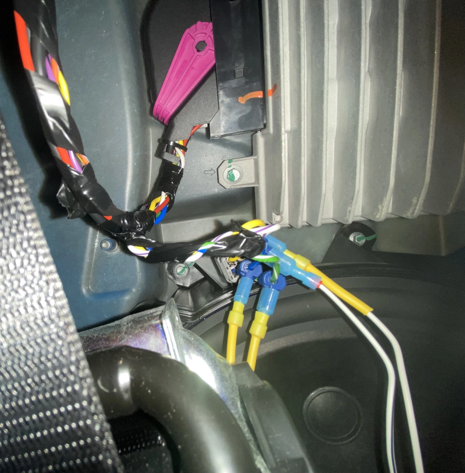

It’s on the US passenger side. The wires are directly connected to the sub. I forgot to take pictures when I was in there. But they are pretty easy to spot.

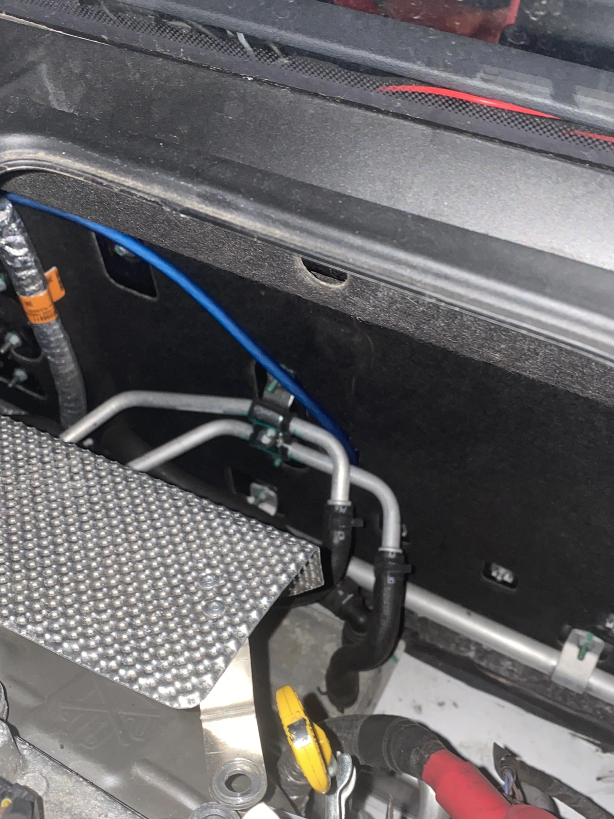

Okay. Took a few pictures. Sorry. Don’t have time to take apart the car right now and I forgot to take them when I initially did it. Also noticed I forgot to heat shrink one of them. Ugh. And need to tie up the power cable a bit more.
Ran power through bulkhead.
Grounded under carpet on shelf to one of the bolts. I did a grounding test to make sure it was viable.
And I tapped into wires prior to subwoofer.
Sorry again for crappy pictures.
