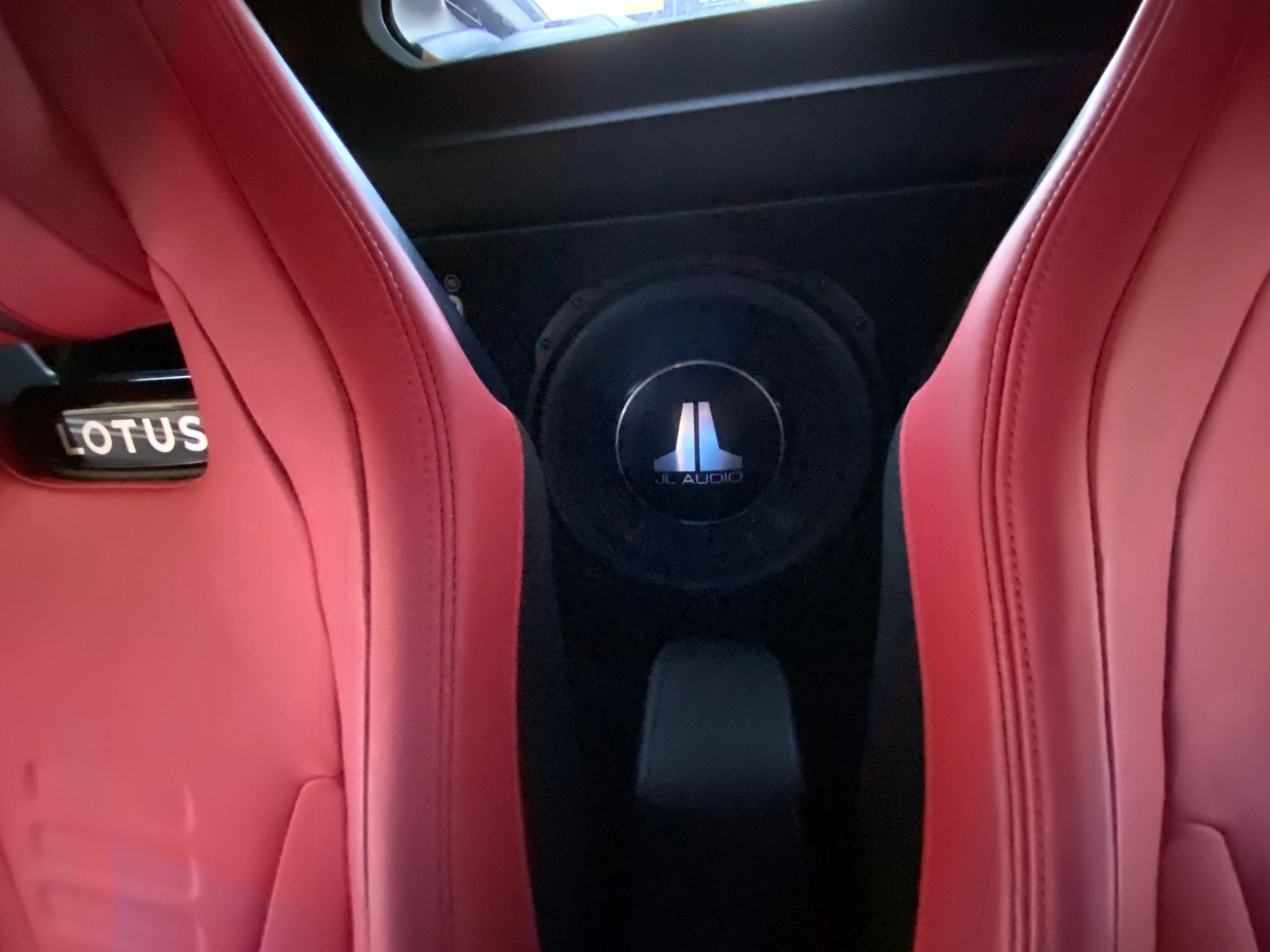

Geezus, you are not effing around. A 12" sub in something as small as the Emira is going to pressurize nicely.
I'm in the process of replacing the audio system as it is terrible IMO for this level of car. What they call a sub is hilarious and weighs like a pound :-) I am buying the kit from kjwemira to install some proper speakers ... separate tweeter, 6.5', 5", low profile sub, and an amp. I can't give up the entire bench for a large sub so just adding a better quality sub along with the better speakers and sound dampening will improve the interior immensely.
