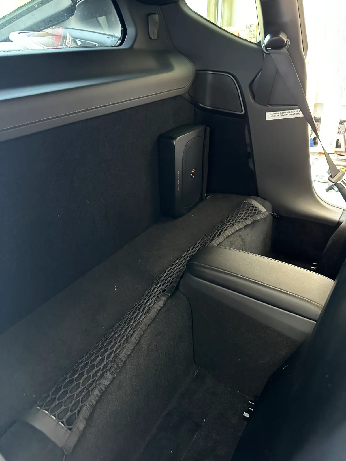

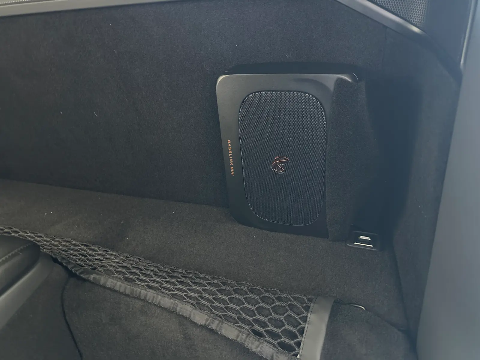

Huge shoutout to all those who contributed photos and how-tos on this thread. It made this an efficient project. I’ve left many how tos and helpers on Lotustalk from my old Evora many years ago and appreciate the time that goes into them.
I wanted to share another option for some of you-Infinity bass link mini. It’s an 8x10 driver so a bit more piston area, long throw, compact enclosure. Harman puts out some decent products and I wanted something small to round out the bottom end, but to minimize the impact to the parcel shelf space since it’s not huge and the trunk is all but useless due to the heat for most things. This one does a perfect job (I’ve totally disconnected the factory driver) and can blend a bit higher into the mid bass than a 10” which is nice, which the factory crossover settings seem to be feeding to the stock driver. Won’t blow your ears out like a REL or something, but well placed and a huge improvement from stock. 12 pounds too. I used a bit of Velcro and automotive fabric to hide the harness.

Updating for posterity, I would not recommend the
updating for posterity.
I would not recommend the basslink mini. While it has more volume in certain frequencies for sure, the cabin gain is rough with this enclosure and the frequency response worse than factory. You’re better off turning bass +1 for some more volume and a decently even response down to 40ish hz, where as this one peaks then tapers hard. I was hoping break in and some tuning would help; but after my initial impressions with only a few hours of listening, more time on it has me back to stock and planning to switch to a better tuned and custom setup in the next 6 months.
Makes sense. The bass link mini is only a 6x8 driver. I recommend a 10 inch driver for measurable improvements.

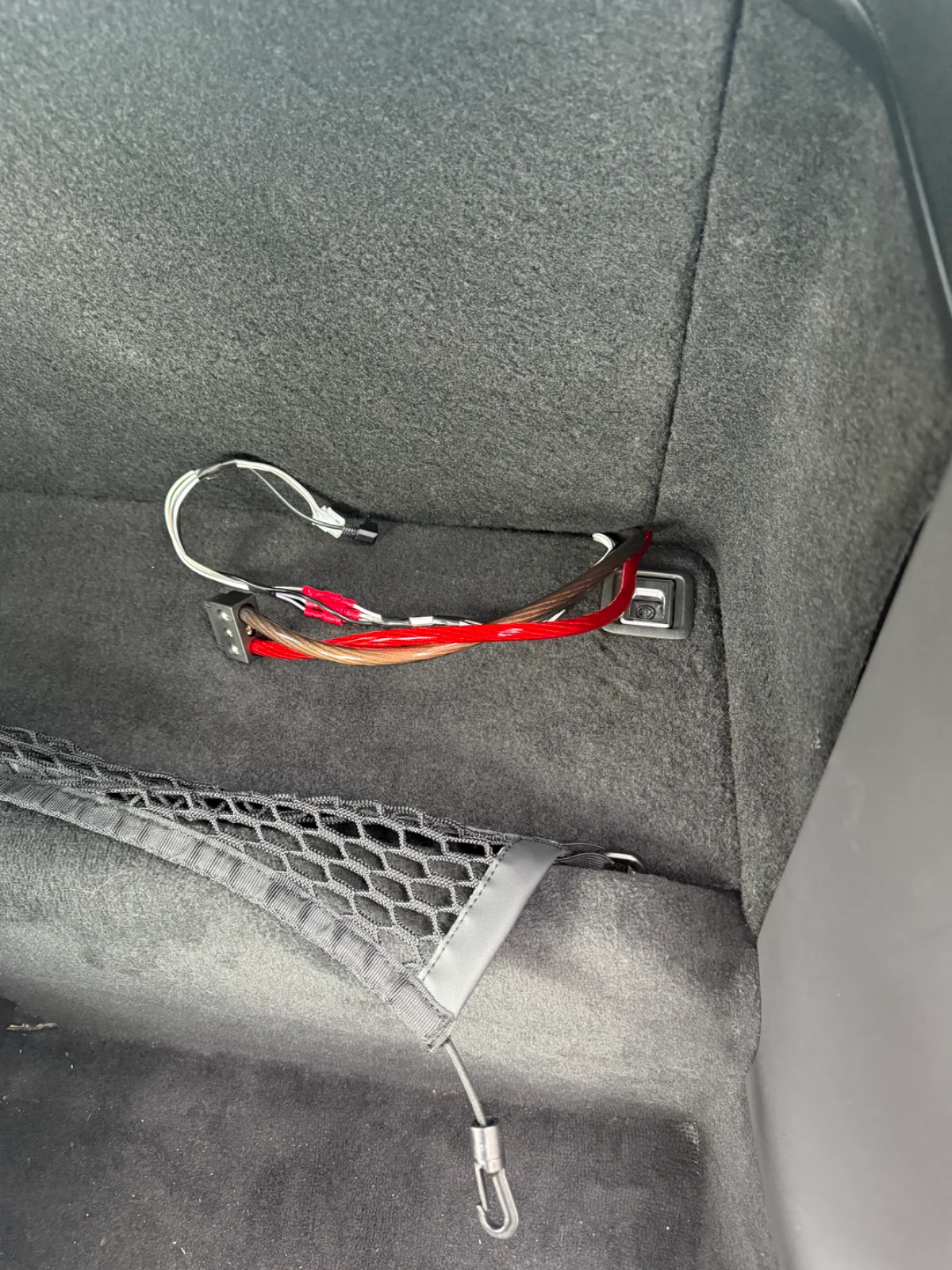

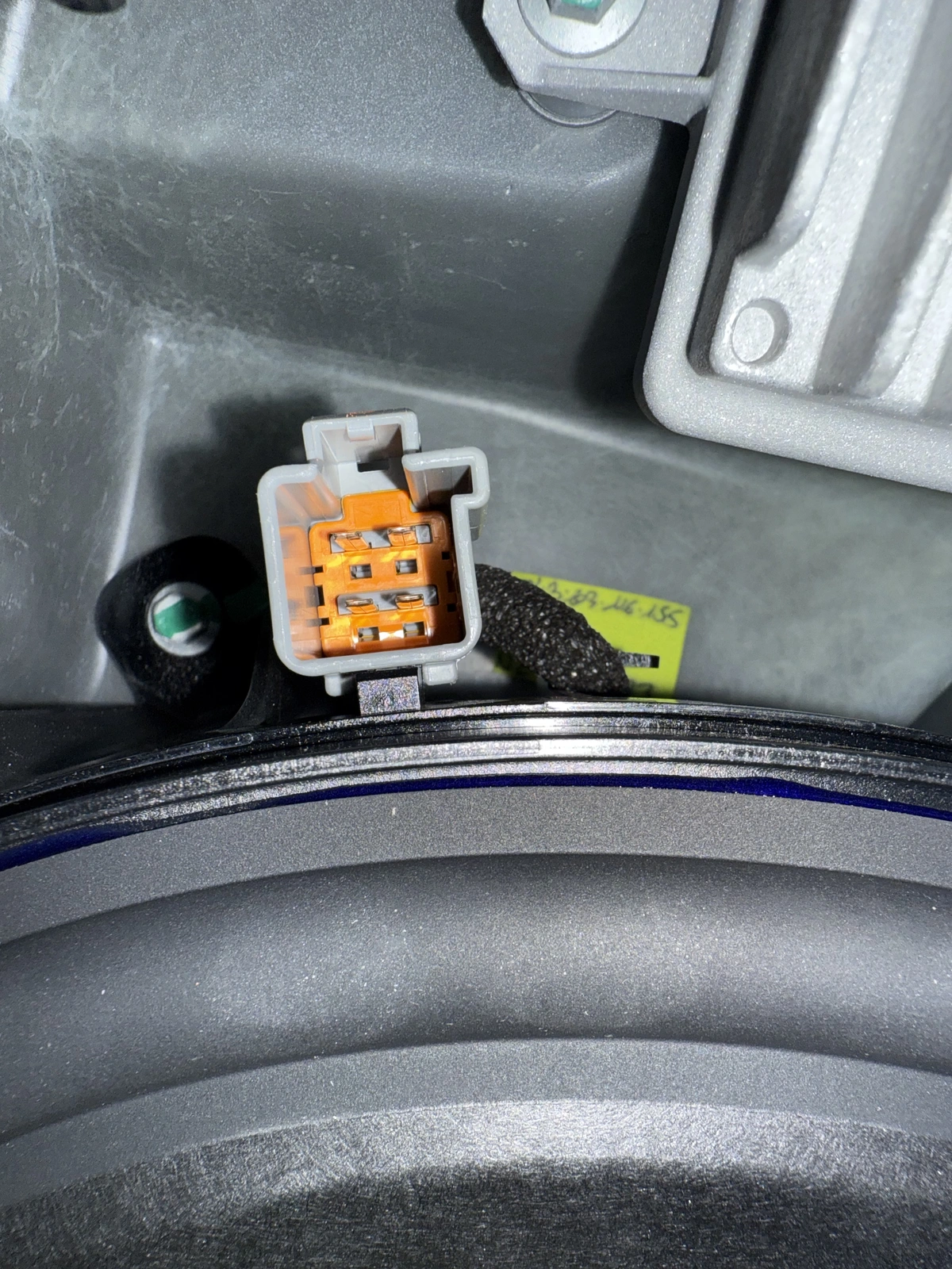

Hi Everyone,
Firstly thanks to everyone here who has done the hard work, to make the install an easier process.
Does any one know what the make model of this connection is? Would like to make a harness for easy removal without damaging the main cables. To avoid any warranty issues.
Any help is appreciated.

Yup I feel you, usually piston size is the easier solve for displacement than anything else. My hope here was extra throw and a comparable piston size would net gains; it did. If you like reggaeton or dance primarily the basslink easily wins for volume without a struggle. The challenge is it’s an uphill battle in a tiny sealed enclosure vs a free air installation (plus whatever stock DSP the KEF system is doing to optimize for the stock driver) and it just didn’t go very low well at all, which as you’re right is often a driver issue. Free air offers some of the best low end extension but usually at the cost of volume/ power with the low suspension damping. My experience with these two certainly jives with that in the stock ins. My opinion, but I also think there is some decent amounts of DSP going on behind the scenes for the stock setup based on the peakiness I got, that seemed beyond cabin gain+enclosure tuning on the basslink. Nothing wrong with it, just need an aftermarket DSp and some tuning/monitoring to really flatten the response in anything plugged in after the OE sub. Another project for another day at this point.
I’ll note that overall the kef drivers due seem to benefit from some break in and +1 or 2 in the midrange. After 2500 miles mine really started to sound better.

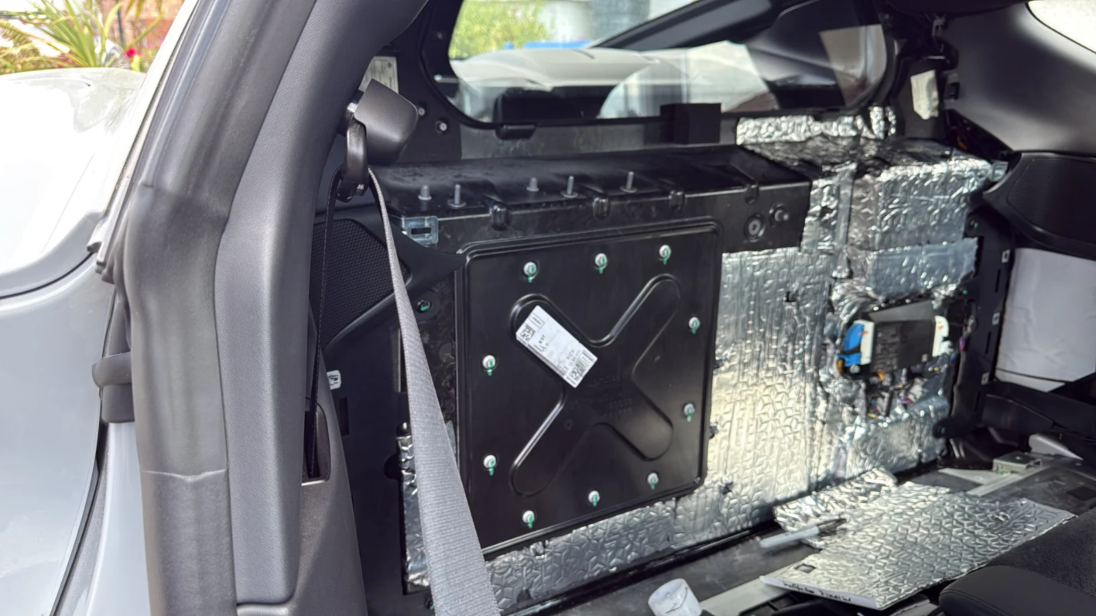

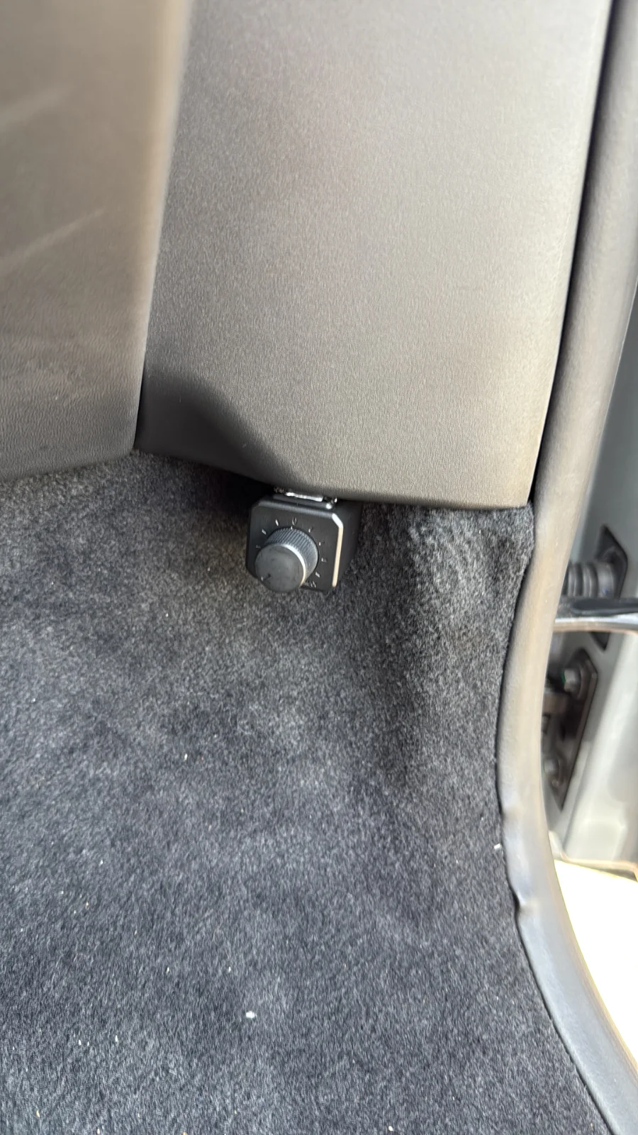

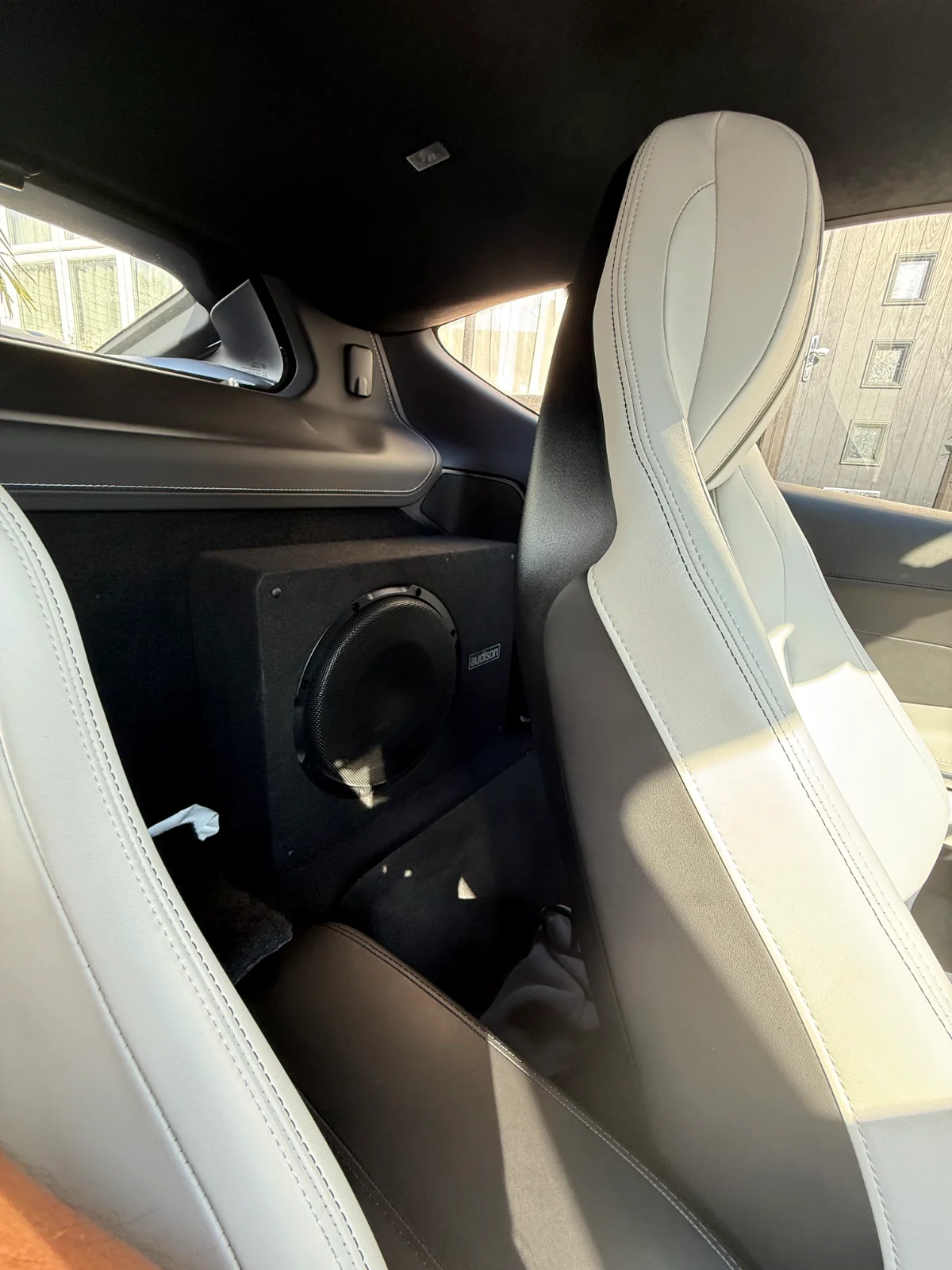

Hi, I recently did the sound deadening and added the Audison prima 10” active subwoofer. Wow that a massive improvement.

How much of the interior did you sound deaden to get that improvement?
I’m planning on getting the doors and rear shelf area done - is this sufficient amount or did you go further than that?
several of us have only done the doors and the complete rear firewall area (including the wrap around area up the doors) and it's a very noticeable difference in overall noise - you will never get rid of all the tire noise coming through the floor, wheel wells, roof, front dash area, etc. but I could tell immediately it's easier to have a conversation with the person next to you in the car than before, and up to highway speeds much easier to actually hear the music
HI Mikeee,
I did the rear firewall and rear shelf area only used about 9 sheets. As Kaz mentioned if you do the other areas it will only improve the over all experience. I may look to do my doors once I get my car back from Lotus.
HI Mikeee,
You won't regret doing the doors and having already done the rear area and knowing what to do, I'd say you'd regret NOT doing the doors. Like the rear area, the door job has its own "quirks" (a few more challenges actually) so looking at the Forum threads that deal with this, provides really helpful advice. One thing you'll experience with the doors being done, unlike what you have so far, is the satisfaction you get when you knock on the outer side of the door: the "dead" sound which tells you that you've made a huge difference preventing sound transfer.
And if you're really keen and while doing the doors, consider adding the 1" Alpine tweeters in the A-pillars, since you've already installed an aftermarket subwoofer (lol; it never ends...). Good luck with whatever you choose to do!
Hi Everyone,
With you on this idea - would be nice to wire up to be more "OEM". Looks like this is on the stock sub (from the picture), so I wonder if the connection, being post stock amp, would have an issue with a powered sub and cause issues. Thinking, head unit-->stock sub-->powered amp sub--> speaker, but I am not by any means an audio expert..
Hi, I ended up buying a sub from eBay from a car which was scraped then cut the adapter off and wired it to the new sub. I could not find this plug adapter anywhere.
