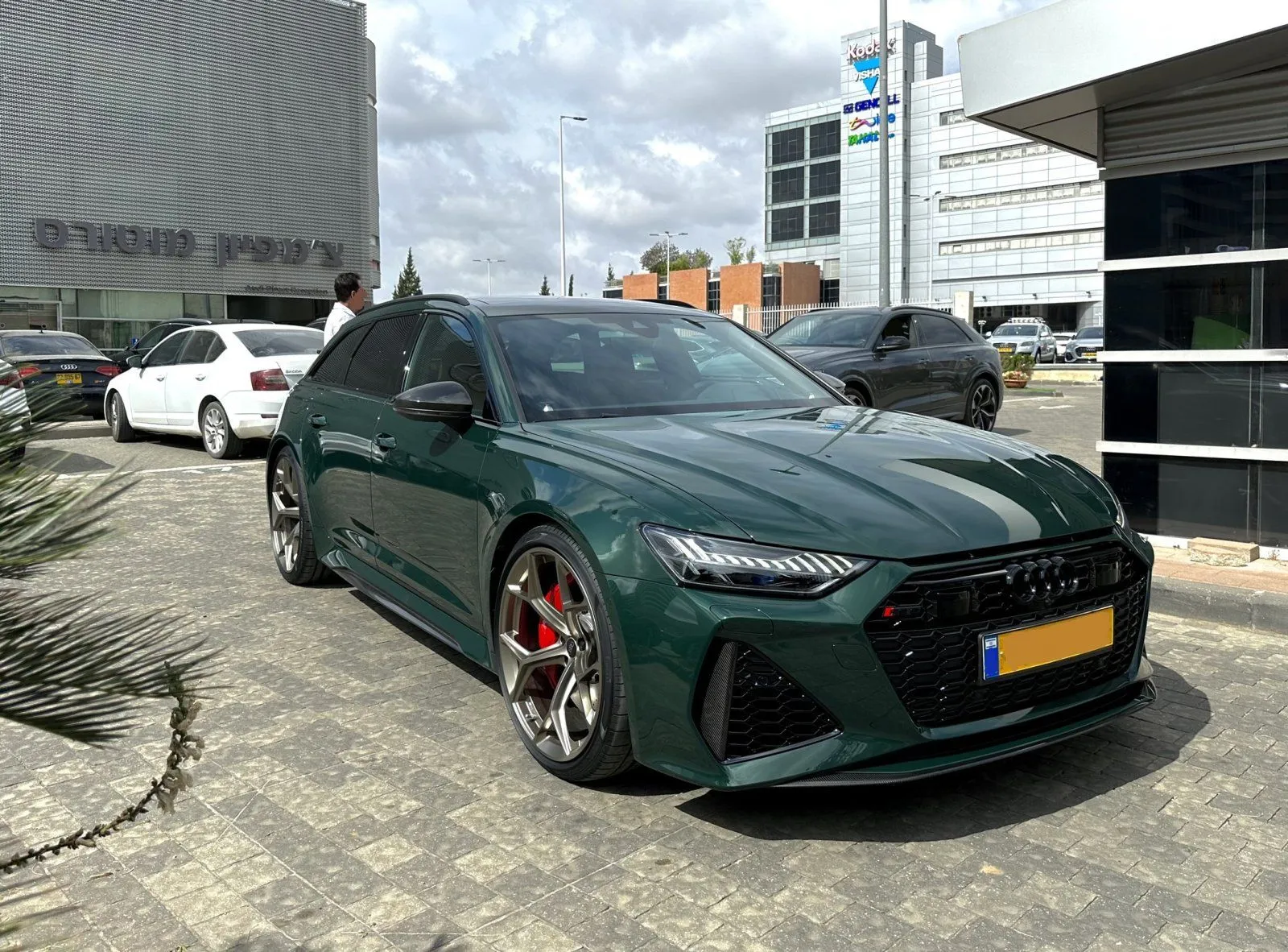

Sorry to hear about your experience really hope things turn out for the better for you! Most things should be solved with a software update imo.
Regarding the heating issue I would also advise to check what @kitkat already stated.
And about the KEF, after receiving my RS6 Perf 2 weeks ago I realized what a true high end sound system sounds like (22K$ option), and IMO the KEF system delivers an amazing quality when it comes to clarity! The only (minor) drawback is the subwoofer, if you're (or anyone else) is the type of guy (I’m as well) who likes the sub sound style it would let you down a bit, but other than that the sound system is high end without a doubt!
(Had to add a pic I’m just in love with that car and the those rims 🤤)
