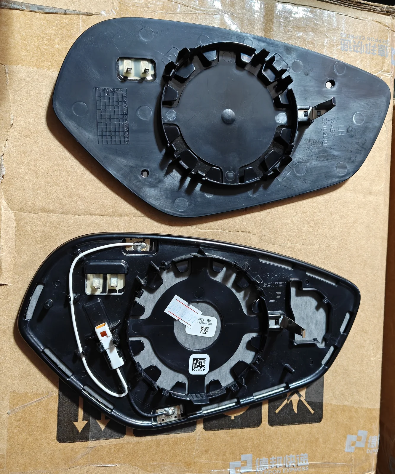

Ok, latest update to this scientific experiment. After some very detailed research by myself and my Parts Manager, we found the part for the LH convex mirror that is used in the EU. There are a couple versions, one with autodimming which is expensive at around $432 USD and one without autodimming, in the $25 range.

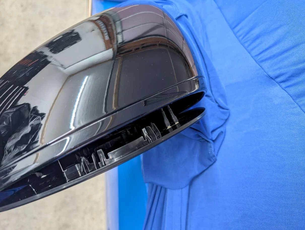

Went to pick up the mirror yesterday, installed it and the convexity view on the US driver’s side is quite nice. i wont be able to tell how it is on the road yet since its below freezing and snowing here.
Installation was super simple, tilt mirror up, use a plastic pry tool to disengage clips, disconnect defroster wire pins and disconnect autodimming harness. Take new mirror, reconnect defroster wire pins and snap mirror on via clips.
More part number information to follow.

I'm curious what the 2 powered wires are for the mirror?
Have you by chance tested if heating element is present?
