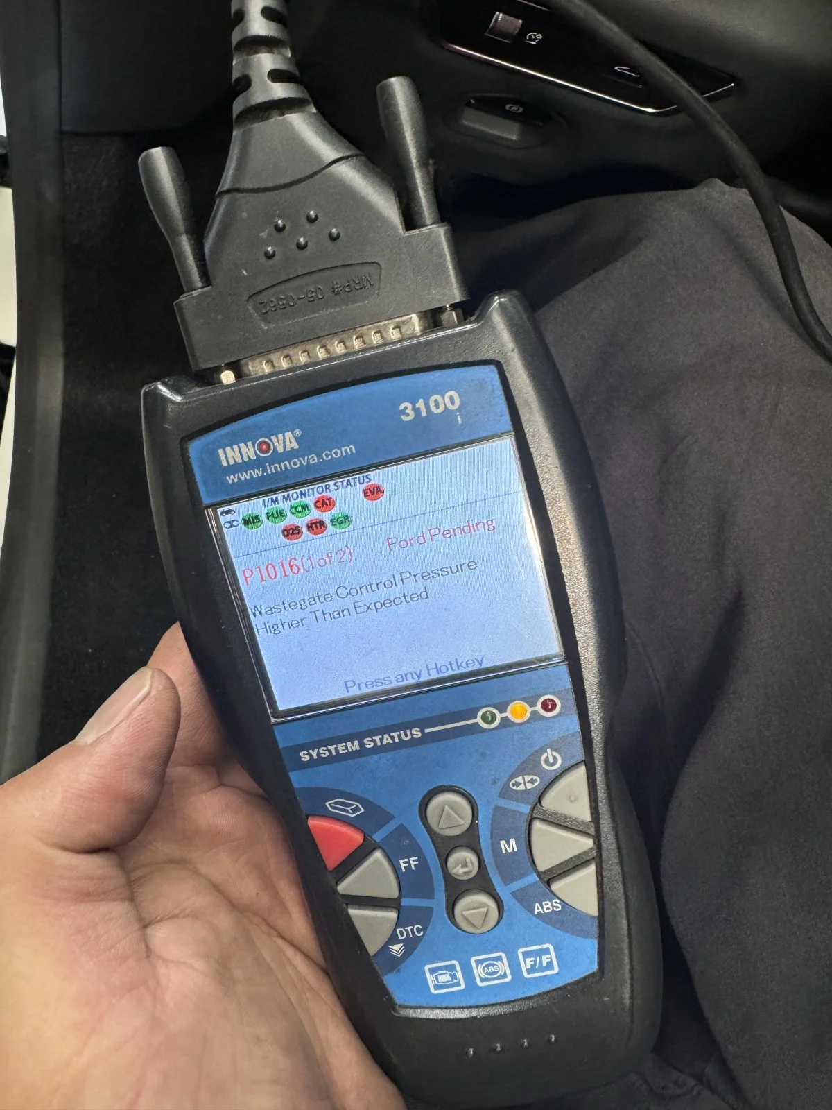

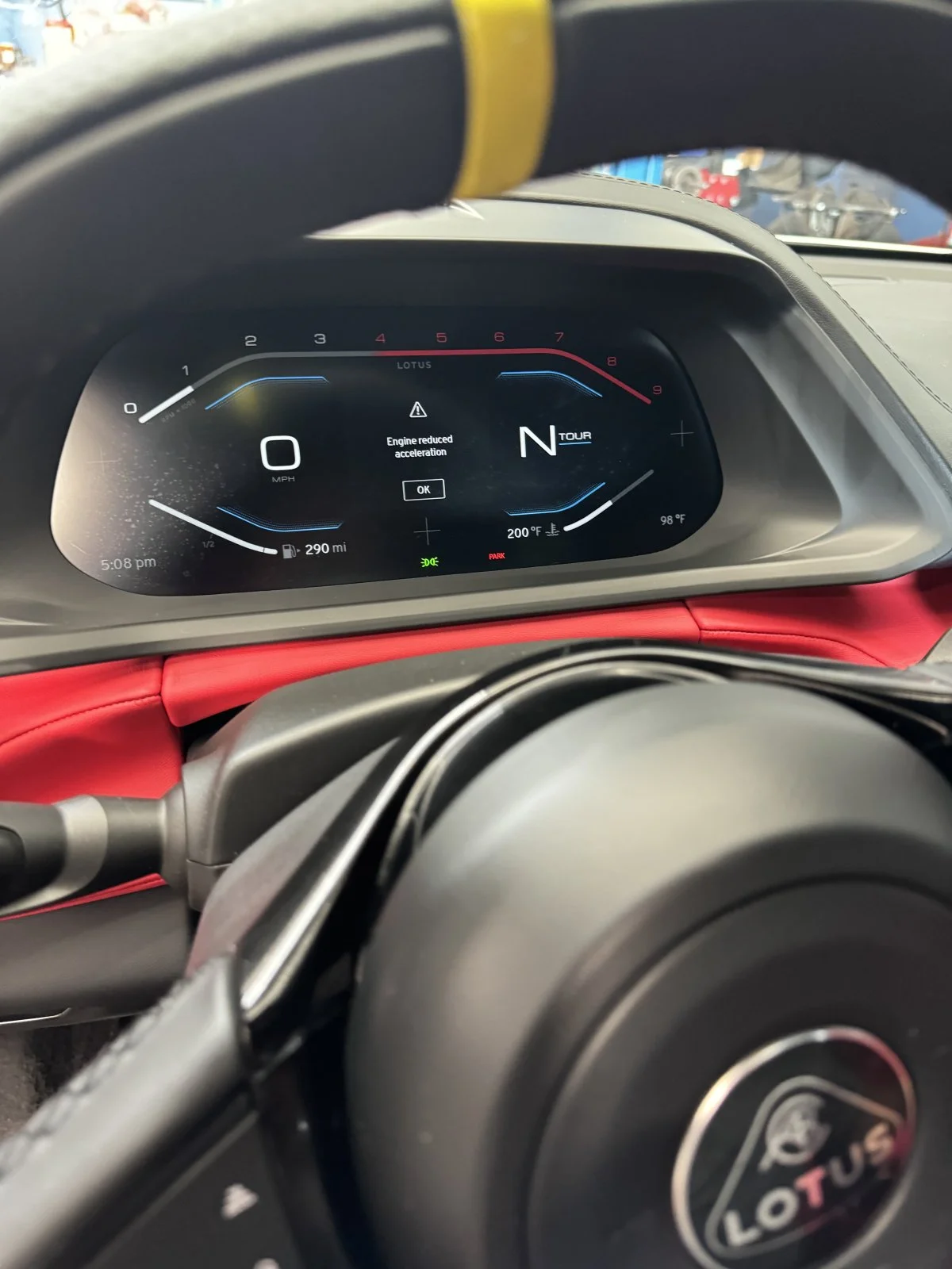

Anyone has issues with installing the Miltek controller? Installed Greg’s cat delete but when the miltek controller is plugged in, it goes into limp mode . I ended up removing the miltek controller and keeping the decats and the code went away.
were you running the valve force closed?
I tried both fully open and OEM, button 1 and 3.
Very strange then. First I've heard of this particular problem with the valve controller. A few people have received modules with incorrect wiring which has caused the buttons to correspond to different settings, but havent seen any other errors reported anywhere and havent had any problems myself.
Does it happen immediately upon starting the car or only after driving for a while? Any particular triggers? (hard pull in sport mode for example).
It triggered about 1 minutes after installing. Then I tried clearing it and it would pop back up within a few seconds while idle.
If the valves were closed, would it give this error? In case the wires were wired incorrectly from Miltek.
The module is supposed to return an OK signal for "valve reached commanded position" to bypass P1018. P1016 is a different code but not sure of the lotus definition for that particular PID. Chances are its related though.
My gut feeling is you have a faulty controller from Milltek.
