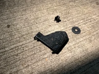

The clip holds the diffuser end to the black glossy trim piece that runs the length of the bumper found between the bumper and diffuser. The boot/L shaped plastic item is a cap of the previously mentioned black glossy trim piece found on each end. Specifically, it goes right behind your rear tire. Look under there and you should see one side is covered and the other one is not (because you have it in the pic). I only know because mine fell off as well. I crazy glued it back on.
As far as the washer, good luck they are all over the place on diffuser and under tray.

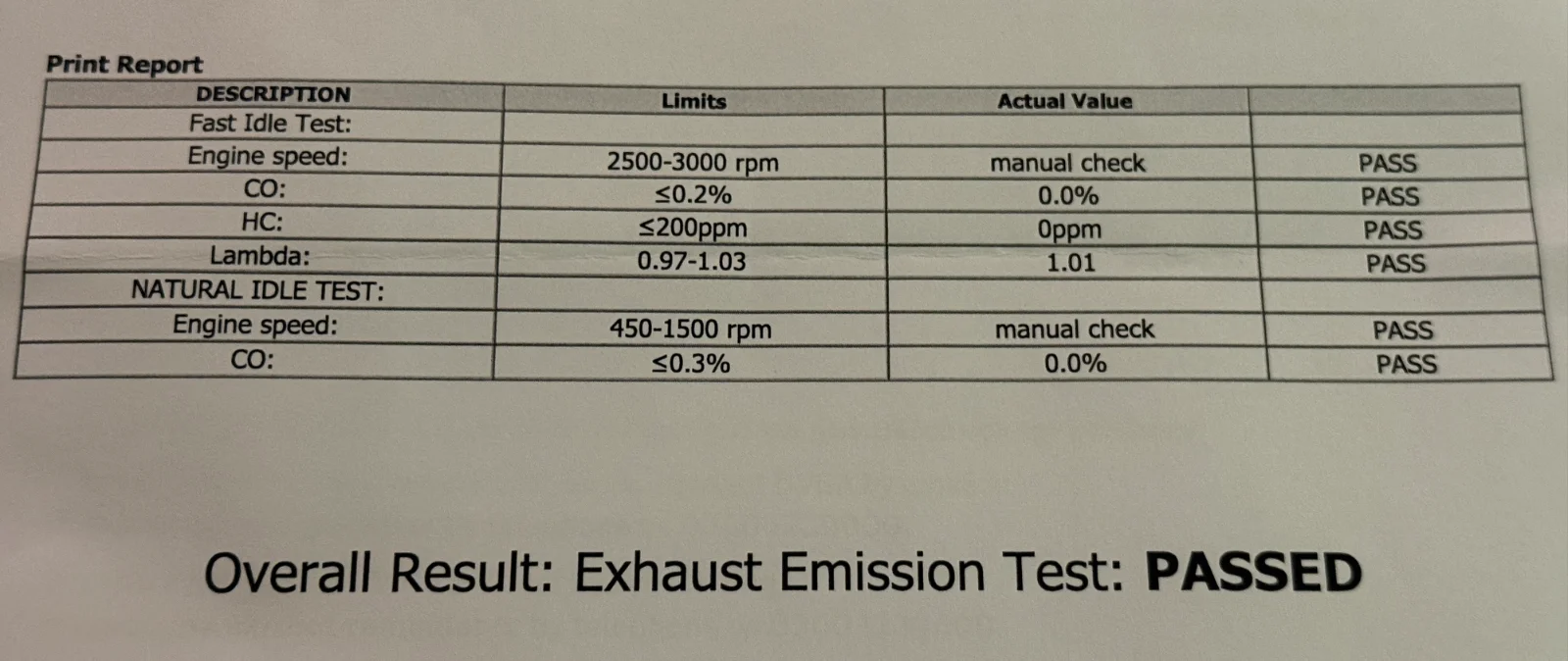

For anyone worried about passing an MOT with the 3rd cat delete, don’t be.
This was mine today:
As clean as an electric car somehow.
