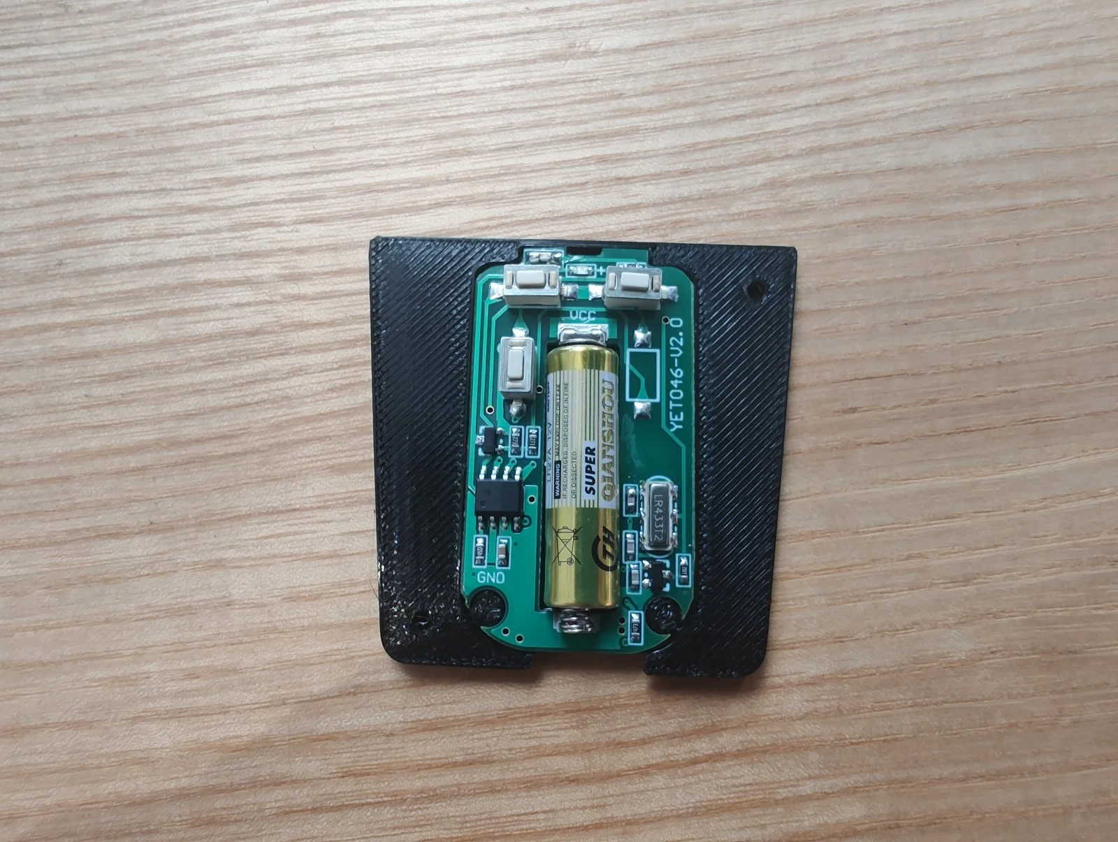

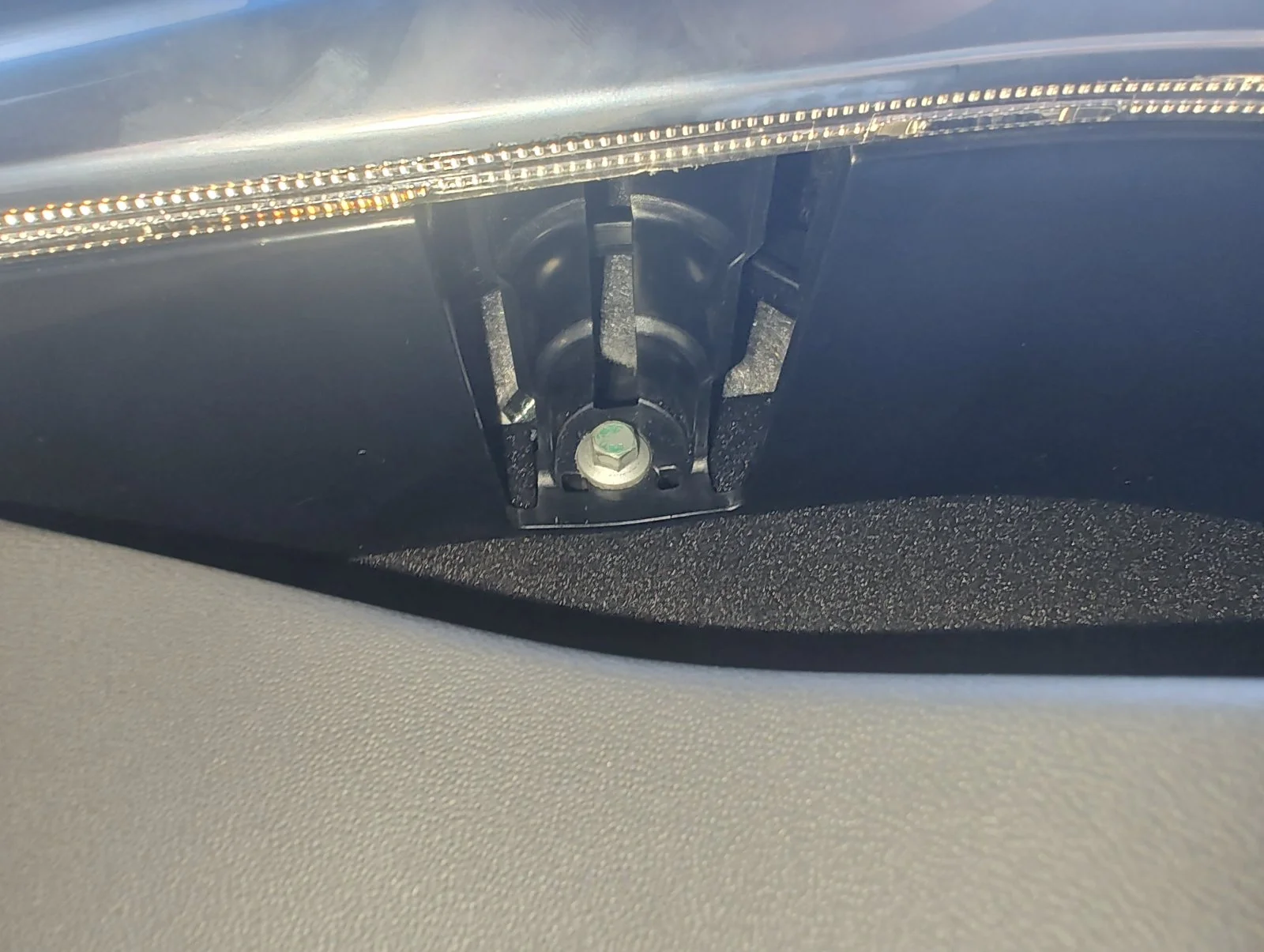

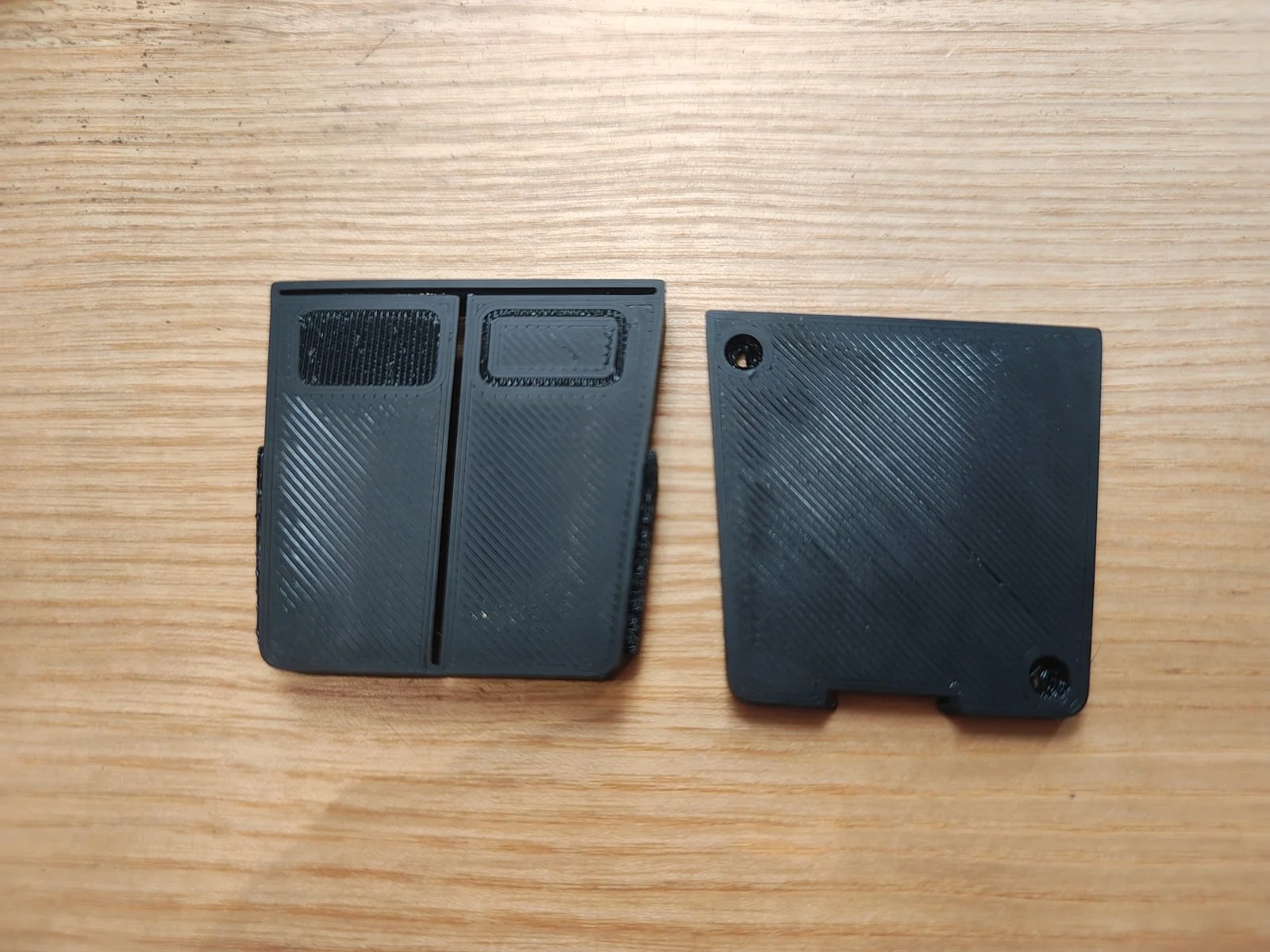

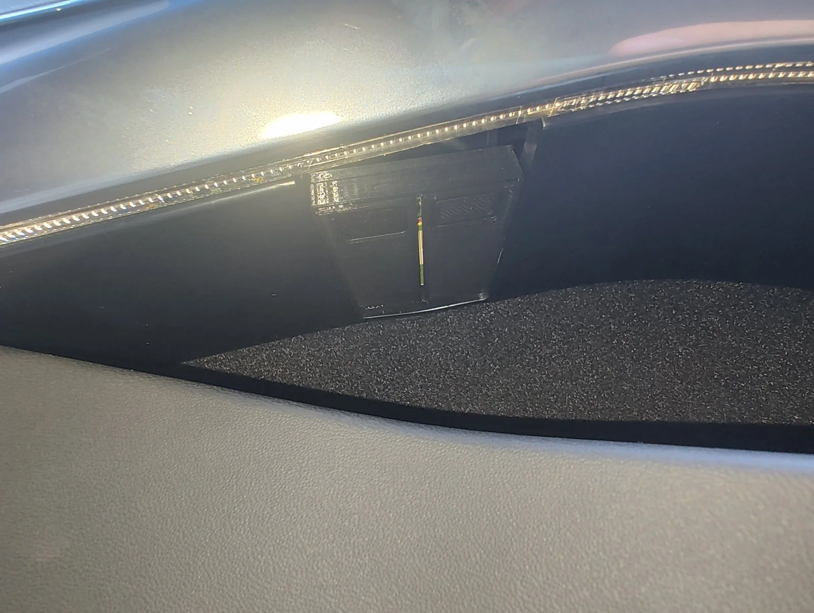

So I don't have homelink, and the little remote they give you is a faff to play with when driving. Had to find a way to make it easier to press buttons 1 and 2, but definitely not 3...
A few evenings and many attempts at the 3d printer later, I've got a new remote housing that clicks into place in a concealed location in the door card just under the seat memory controls.
Much easier to find/change while driving!
