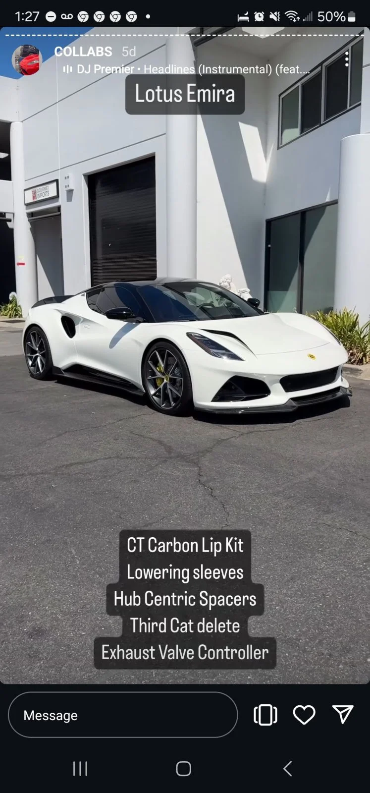

I just finished installing bunch of stuff I ordered from Greg.
1. Eventuri Intake
2. Miltek valve controller
3. 3rd cat delete
4. CT Carbon full kit
5. Lowering sleeves
6. 12mm hub centric wheel spacers
I'm so happy with the result and just researching on what to do next. Any recommendations on what to do next??

That looks stunning! I want to add the CT Carbon kit, but I'm worried that my country roads might be too rough for it. I already have to plan my route around town so I don't scrape the front bumper.
You might want to consider the short-shift kit and a lithium battery.

Looks awesome! How was the lowering sleeve install? Do you know how much you lowered it? Is the ride quality the same or did it change?
