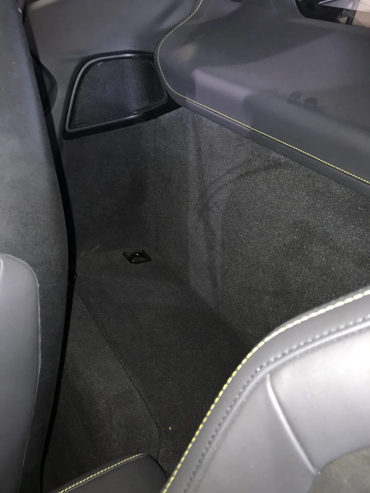

Behind the seats, in the side plastic trim, from memory (this was covered in a bit of detail on one of the other Lotus forums).
Is it this grille in the rear, so higher up at shoulder height rather than lower down? Or is that just a conventional speaker rather than the sub? I'm no audio expert!
None of my pictures of the rear show any kind of grille in the lower section, but it is a show car and may have been omitted. There is another one of these on the opposite side.
may not be subs, but think its going to be part of the HIFI, meant to be 10 speakers so good place for mid range :) well spotted
Yep, I think that grill is too big to be the sub, Tom. The subwoofer vent is actually quite thin… one of the great advantages of the Aussie design.
