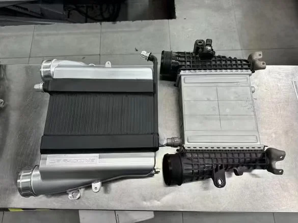

I’ve attached a picture of what his tuner sells

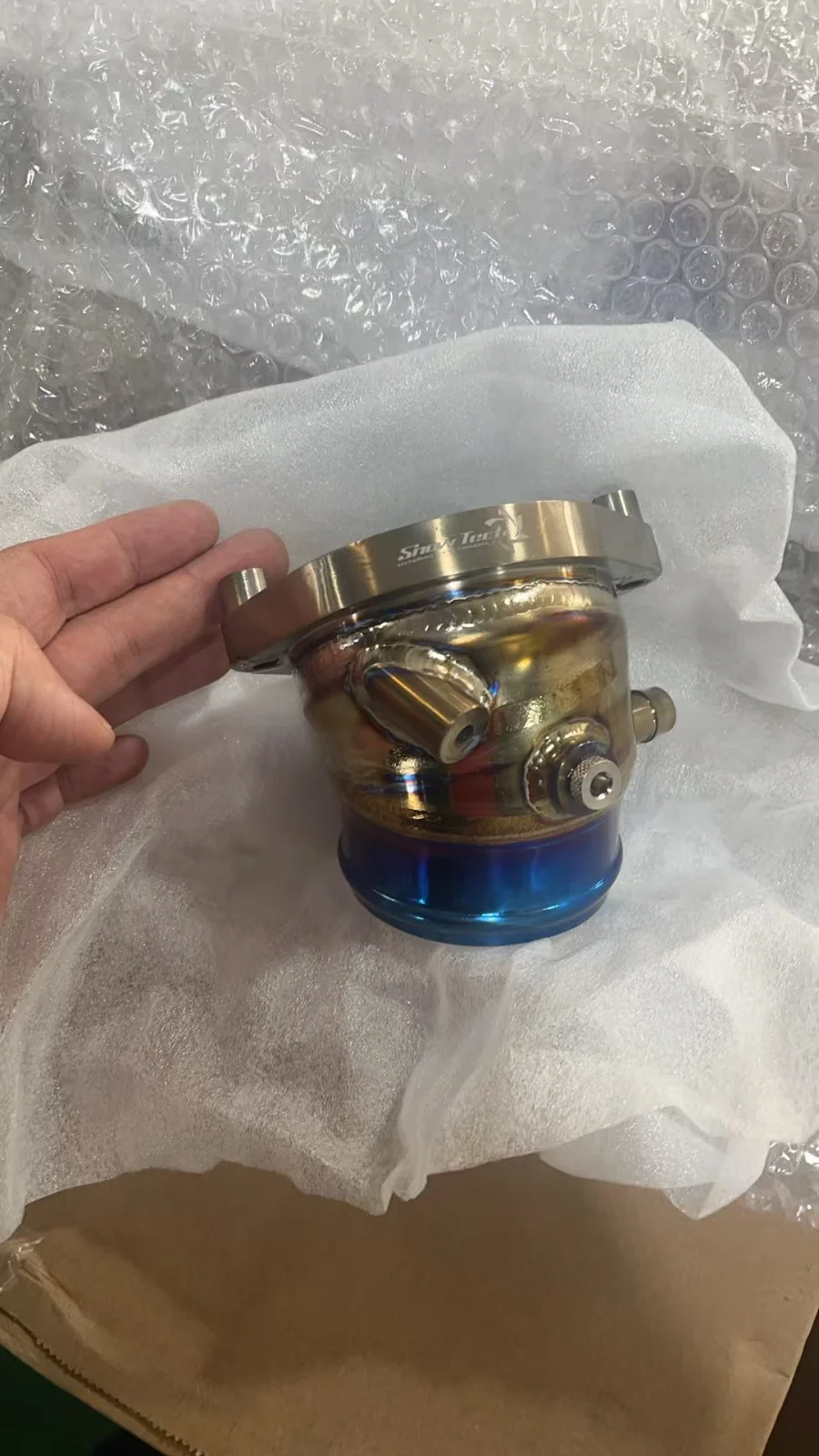

I bought this which is the charge pipe post intercooler.

@docron found this and waiting for replies

From info I found online, they seem to charge 2700
If it’s 1500, that would be pretty good as that’s what I paid for my top mount intercooler in the f80 m3 days
oof $2700 is pricey for one small intercooler core...yeah something in the US should be like $1500-ish, strange no one makes one here already seems like a no brainer for the M139 applications

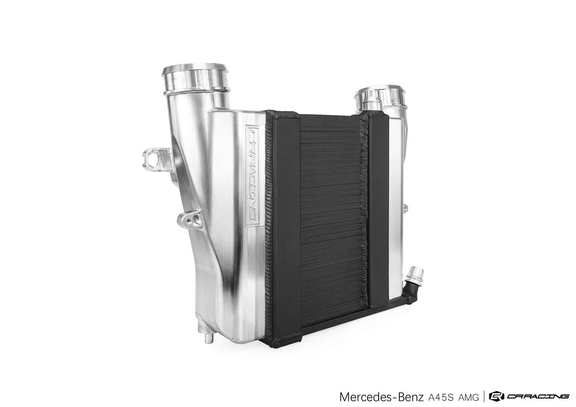

Got a reply from crracingengineering and they are charging 2430 but they also said they’re not sure if the lines will fit lotus as they modified the coolant line locations…

I am really surprised no other company is making after market intercoolers for both the V6 and AMG here in the states.. I would imagine the gains would be good enough to warrant the cost for some people..
