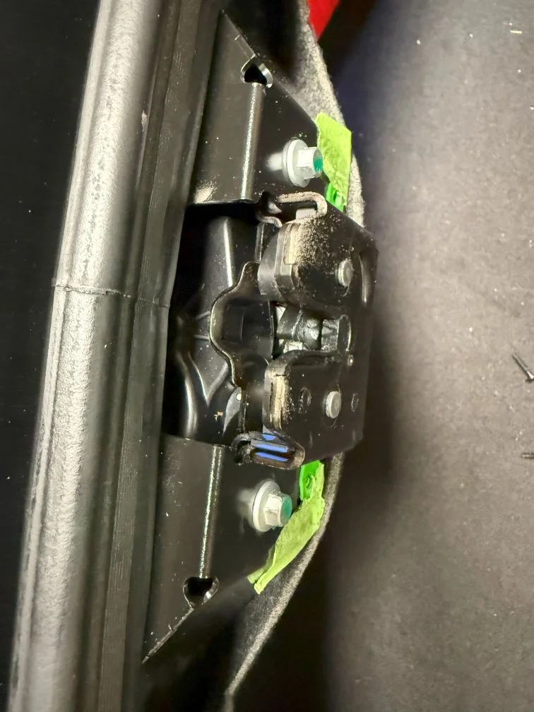

Hey I’m in a bit of an emergency here. I parked the car and opened the trunk, then went ahead and lowered the tailgate as always to close the trunk. Now no matter what I do, the tailgate will not fully trigger the latch and the car will display the “trunk open” light in the dashboard. I can’t fully close the car and I can’t even drive back home, since it’s actually not fully closed. I try searching the forums but didn’t find an answer. Only found the topic to locate the handle to unlock the trunk inside the car. If I trigger the latch by hand it works, and the light goes away so I suspect the metal piece hanging down from the tailgate isn’t fully triggering the latch. Also the whole latch mechanism wobbles. The tailgate already gave me headaches, but it closed fine with a nice push until today. What can I do?
Sure I’ll post some pics tomorrow or Monday, as soon as possible. The latch assembly was the culprit
Post some pics if you can of what was loose. Was it the top latch or bottom assembly?

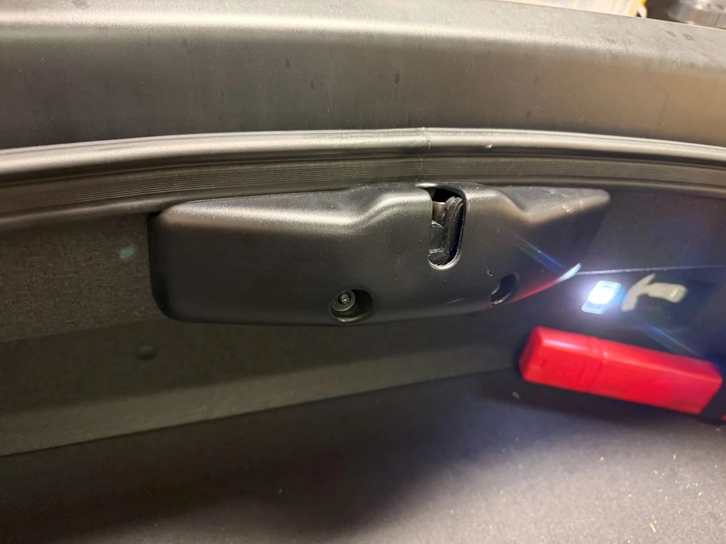

Hey, I'm so sorry for being this late. Had no time really until today.
Here are some pics. The bolts in you see in the last pic with the green dot on them were completely loose, and this made the center piece loose as well. This didn't let the latch to catch on the tailgate hook, and the whole thing wouldn't close properly.
It was a very easy fix, but it needed the right torx screwdrivers and wrenches. That's all :)
