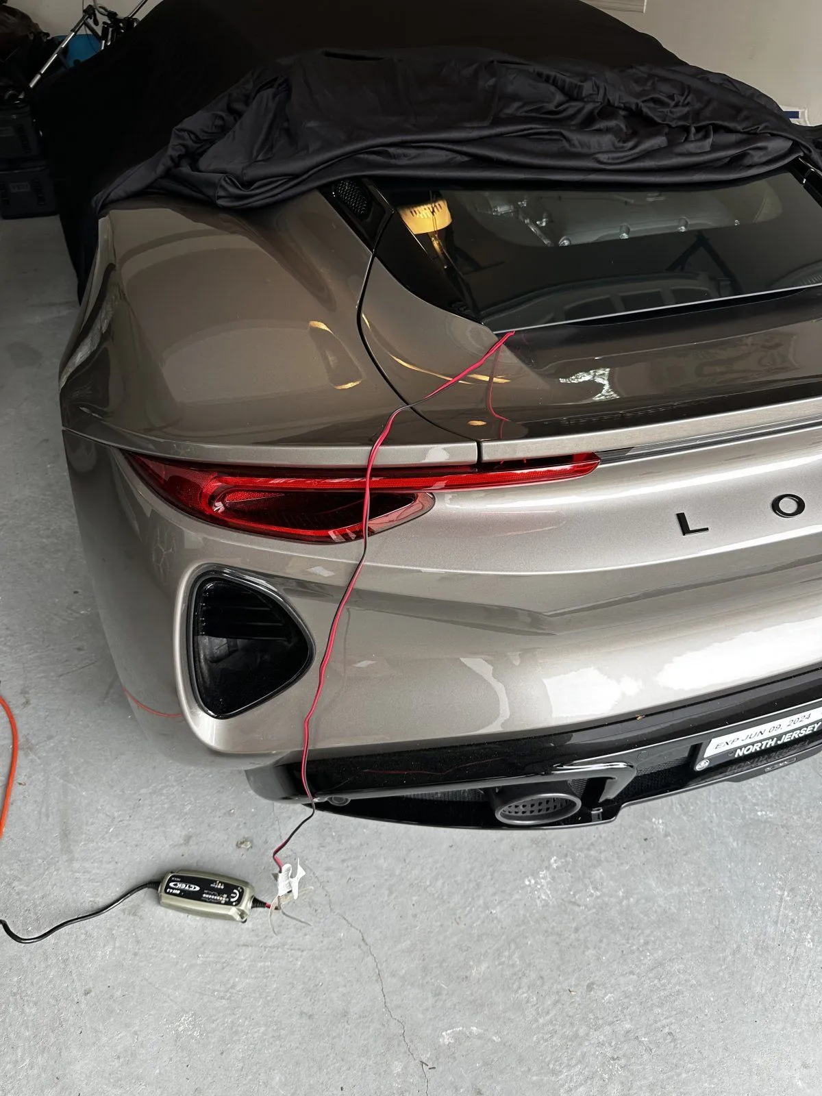

The trickle charger cable is the biggest culprit of my trunk issues...

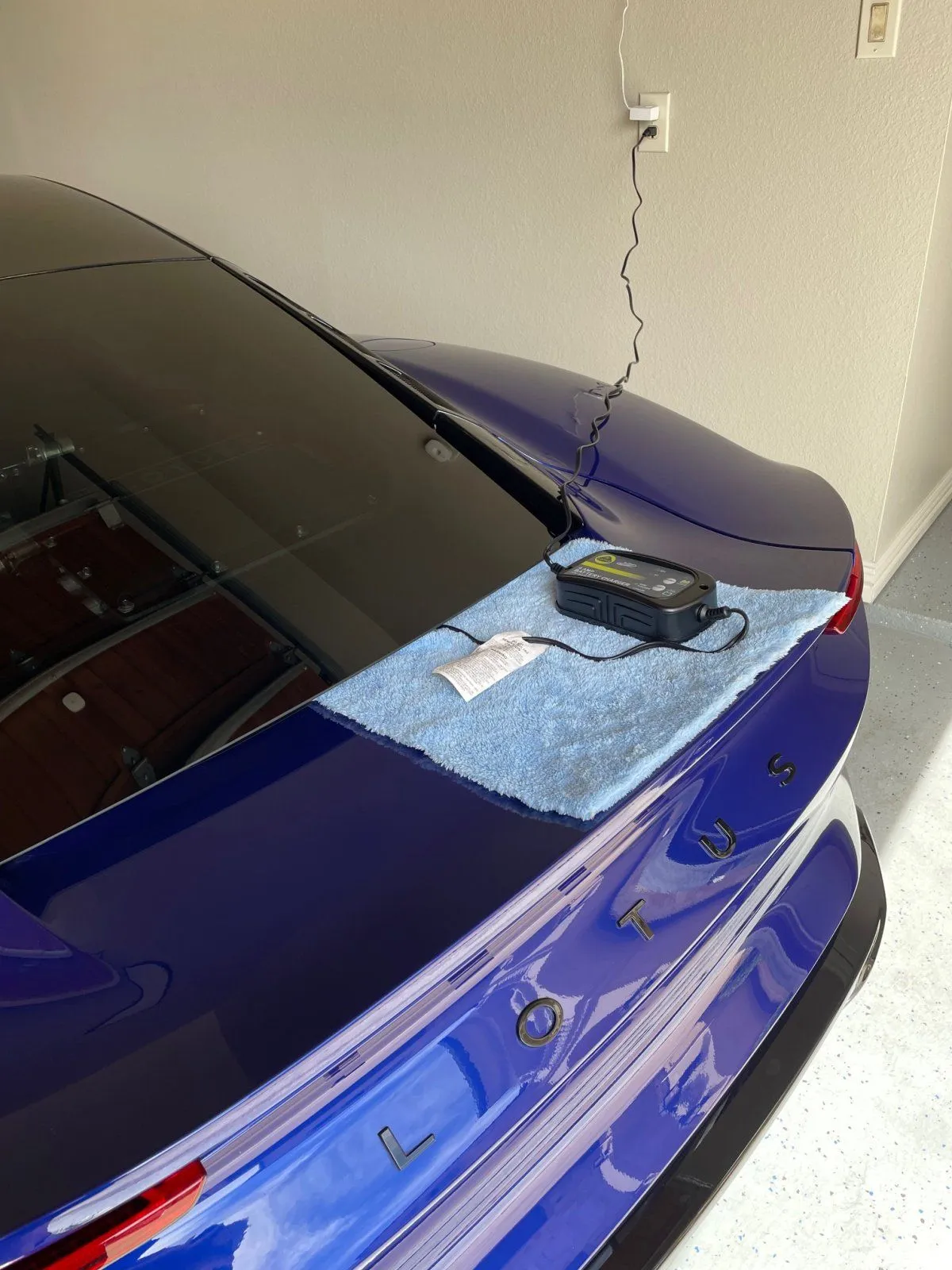

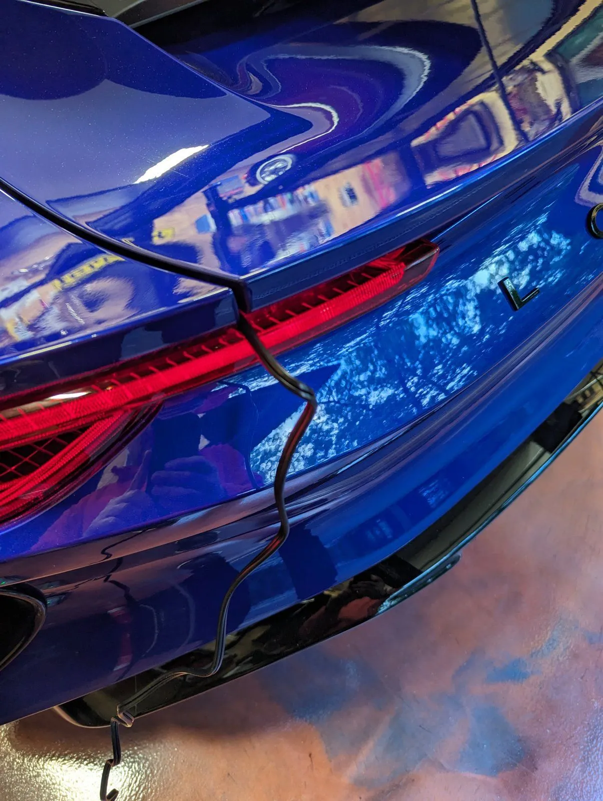

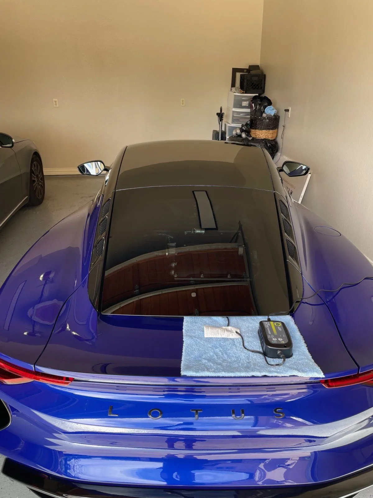

Off-topic, but you could put a towel on the trunk and run the trickle charger wire through the slot below the rear window. That’s what I have been doing.
Exactly what I do, is a little hassle to set up but then won't have to worry about trunk wires being damaged or trunk issues

It took me a few minutes- but the gap under the rear window is perfect to run the cable without crimping the wire in the rear hatch.
