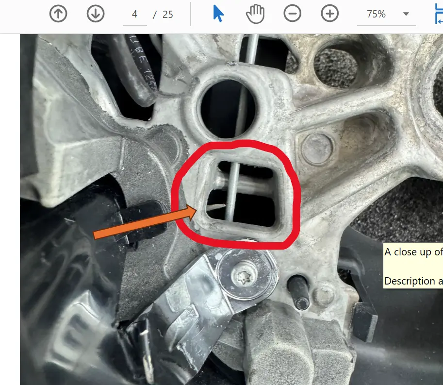

Been trying to get the airbag out for the last hour or so. No success. Maybe my screw driver is too short??? I have no idea, but I sure as heck don’t feel a spring at all…
Maybe I’m one of those un-handy people 🤷🏻‍♂️
make sure you're keeping the flat end at 90 deg (to the dash/fwd) as you push into the hole. See GRPs instructions for pics of the little release rods. If you dont the screwdriver will slip past that rod and not do anything. Youll feel a bit of resistance if that happens.

Sorry to hear about the trouble!
Have you looked at the pictures on our instructions?
The screwdriver only needs to be about 4" long at most to make contact with the spring clip.
Here is the link for those if you havent seen them already - GRP Steering wheel Instructions
I’ve seen those, and I even went at different angles with the flat completely flat (widest at the bottom - 180 degrees) and even when that didn’t work, I did it the other way just to make sure…. Am I suppose to hear an audible pop? Or feel an audible pop?
The opening is tiny but you may be able to peek in there with a flashlight to help align the screwdriver
I think it's because the longest screw driver I have is 50mm (about 2") for a flat head. The longer shaft ones are quite a big bigger being 1/4"+ so I'm going to get a 3mm/ 1/8th" screw driver with a 4" shaft from home depot/lowe's to see if that helps! Thanks guys!
Make sure you push straight down "inward" on that spring. It took me a few tries as well as initially I thought I was supposed to pull left or right on the spring. Ultimately, it released fairly easily when I pressed inward.
Good thing I’m renting my office from a friend who owns a body shop. Got it replaced!!! Told me it was just like the dodge’s airbag retention spring. So he got it out in like 10 seconds, put painters tape over the hole like a pro, and then the NEXT biggest challenge: removing the steering wheel trim. There are 3 retention clips on top, and 2 clips on the bottom, and then there’s the “mushroom head” pins that require some force to get out! We couldn’t get the top (hidden clips) and we thought it was screwed down. BUT, he went in from the back and got them off! The center you can see, but the top left, top right you can’t.

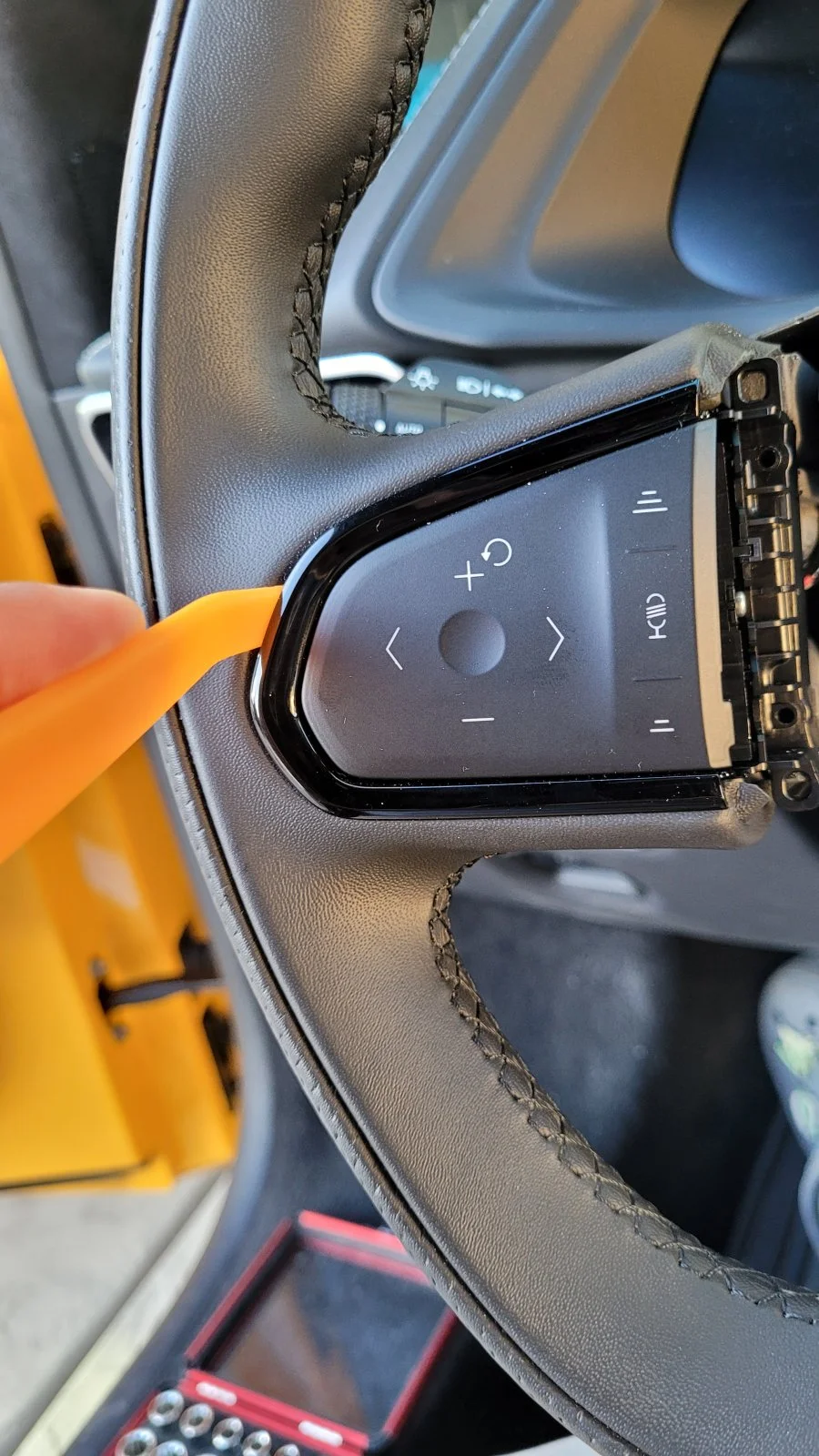

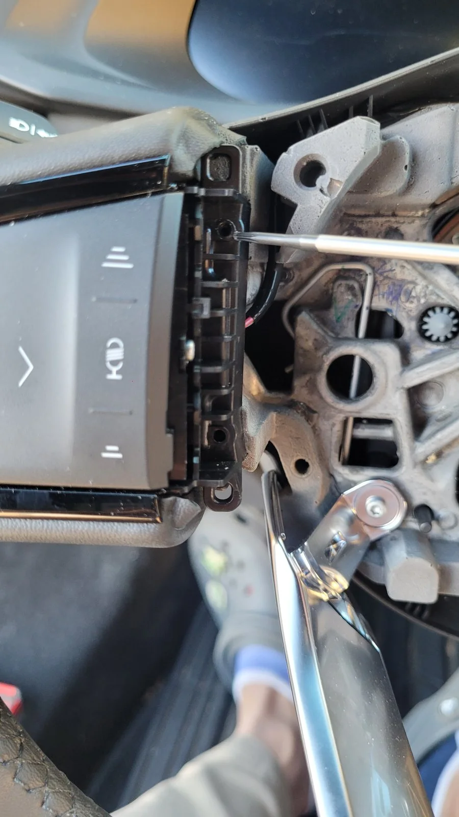

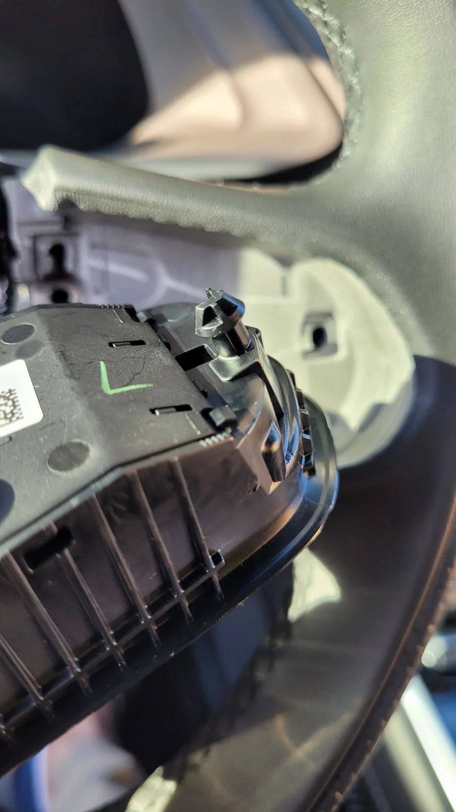

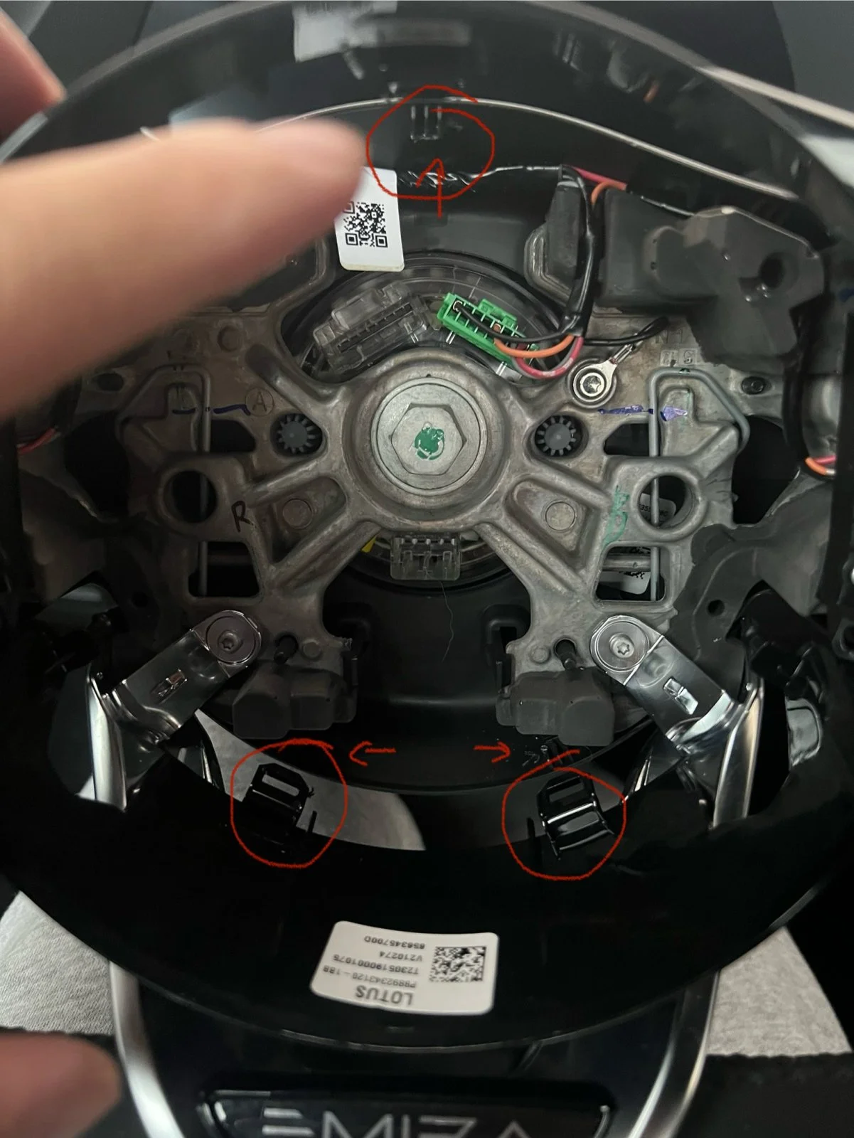

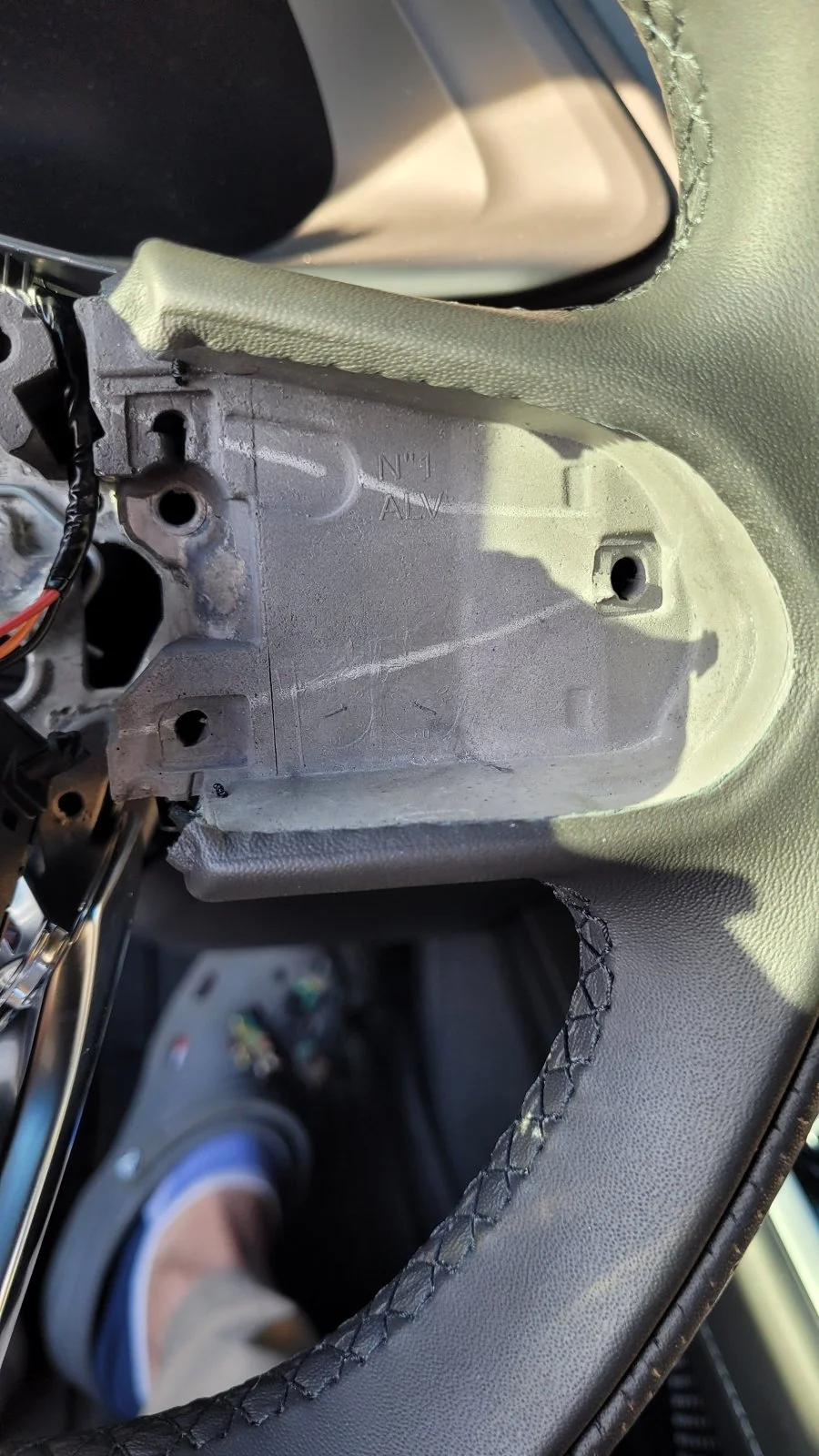

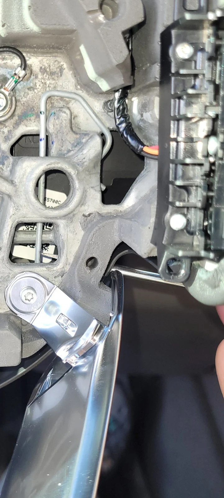

I've just installed the new non haptic buttons n it's easy once you figure it out but the instructions on GRP site was not clear....
1. AIR BAG REMOVAL was easy.... see the picture, while pushing the spring tab in, pull the bag out on that side n while holding that side out, goto the other side n push the spring Clip in, to release the mushrooms head retention screw on that side....
2. Removing the round "air bag collar" was difficult to figure out but basically, I used some force to push/ bend the plastic ring inward to release the tension clips, 1 top, 2 bottom while pulling the whole ring towards you..... it feels like it could break, but that's how hard you gotta force it.... kinda scary.... but.... it will come out n press fit when reinstalling...
3. The removal of the original haptic switch is another issue.... it's held in by pressure n 3 retention legs ; you have to use a small plastic pry bar to slowly work it out , from the sides.... the 3 T6 screws have NOTHING to do with holding the switches in there.... I removed one side by mistake n basically made it useless cause I separated the fine flat wiring and the intricate spring mechanism in the oem buttons... not that I care cause I ll never use em but.... and install is opposite, just press fit...
THEN put the bag trim ring back on n then reconnect the yellow harness for airbag n snap the air bag assembly back in....
Here's some pictures.....
Here's some pictures.....View attachment 55980View attachment 55981View attachment 55982View attachment 55983View attachment 55984
Very helpful! I just did mine too. A few more pointers that helped me as I just installed my GRP buttons
For taking out the airbag, when I keep seeing “push inward” I thought it was push inwards toward the front of the car… you literally have to push this spring straight down (so toward where the airbag is sitting). You will feel the spring tension
For taking off the collar, I haven’t seen any posts highlighting the retention clips so I’ve included that here. I simply put a screwdriver to lift up the clips and yank out carefully (1 clip on the top and 2 on the bottom)
Overall the installation is 9.5/10… just kidding haha. It literally took me 30 minutes and the buttons are a game changer. Another winner by GRP. Love em!

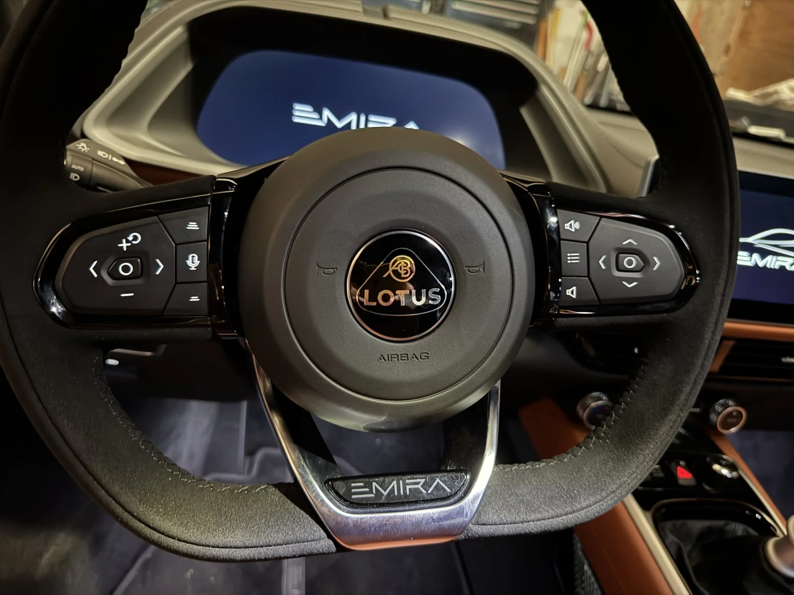

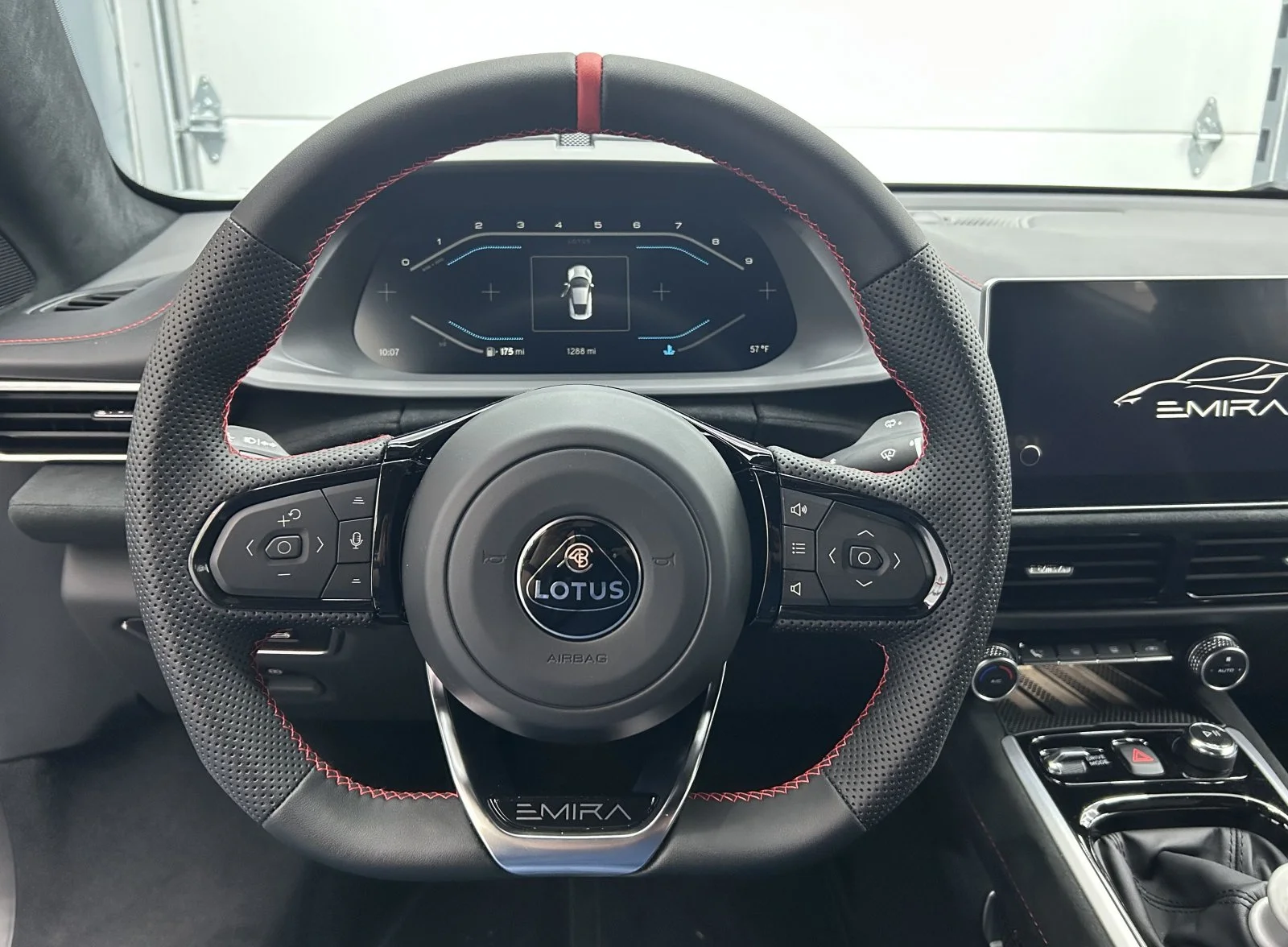

There are two issues with the stock steering wheel that I really didn't like. (1) The "square" top and (2) the haptic touch buttons. My car was recently in for service so while there, I had the shop install the GRP Steering Wheel with push buttons. We removed the factory alcantara wheel with the haptic touch controls and installed the replacement wheel pictured below. Its constructed with leather and has red stitching to match the seats. Haptic controls swapped for push buttons. I opted for the round top with flat bottom for the new wheel. Overall impressions, much improved with OEM quality and feel for both the wheel on control buttons. The wheel feels natural in the hand when driving and the infotainment doesn't have a mind of its own like before with the haptic buttons. Well worth it!
