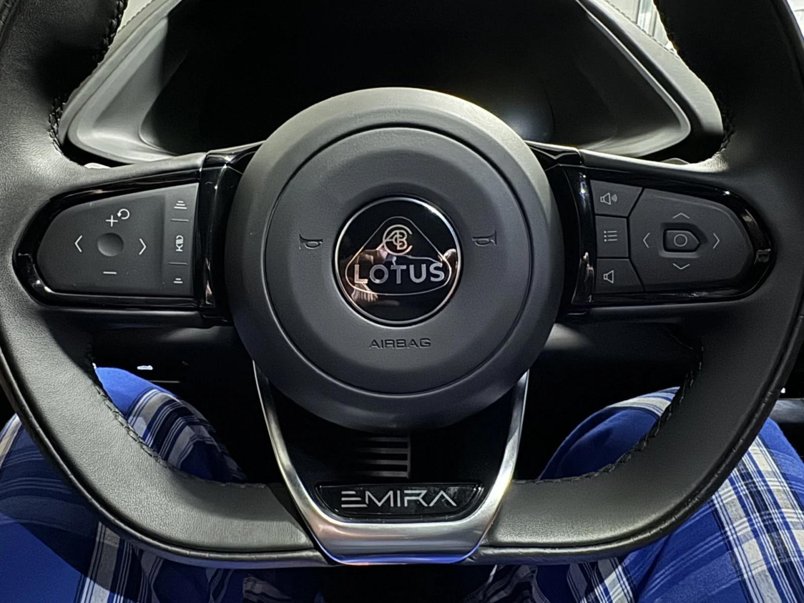

I ordered them from GRP, I installed them, which was fairly easy, but unfortunately the left side one that controls the cruise control was defective and didn't work, so I returned that one for a replacement which Greg is following up on with his supplier. Currently, I may very well be the only Emira owner with a bi-polar steering wheel. Here's a picture...
This setback aside, I'm very impressed with how the OEM button version looks and feels. You can barely notice a difference with the haptic ones, unless you look very closely. Functionality wise (at least speaking for the right hand one) it works perfectly with no more accidental triggering of functions and that one is the best tester since I've barely used cruise control anyway.

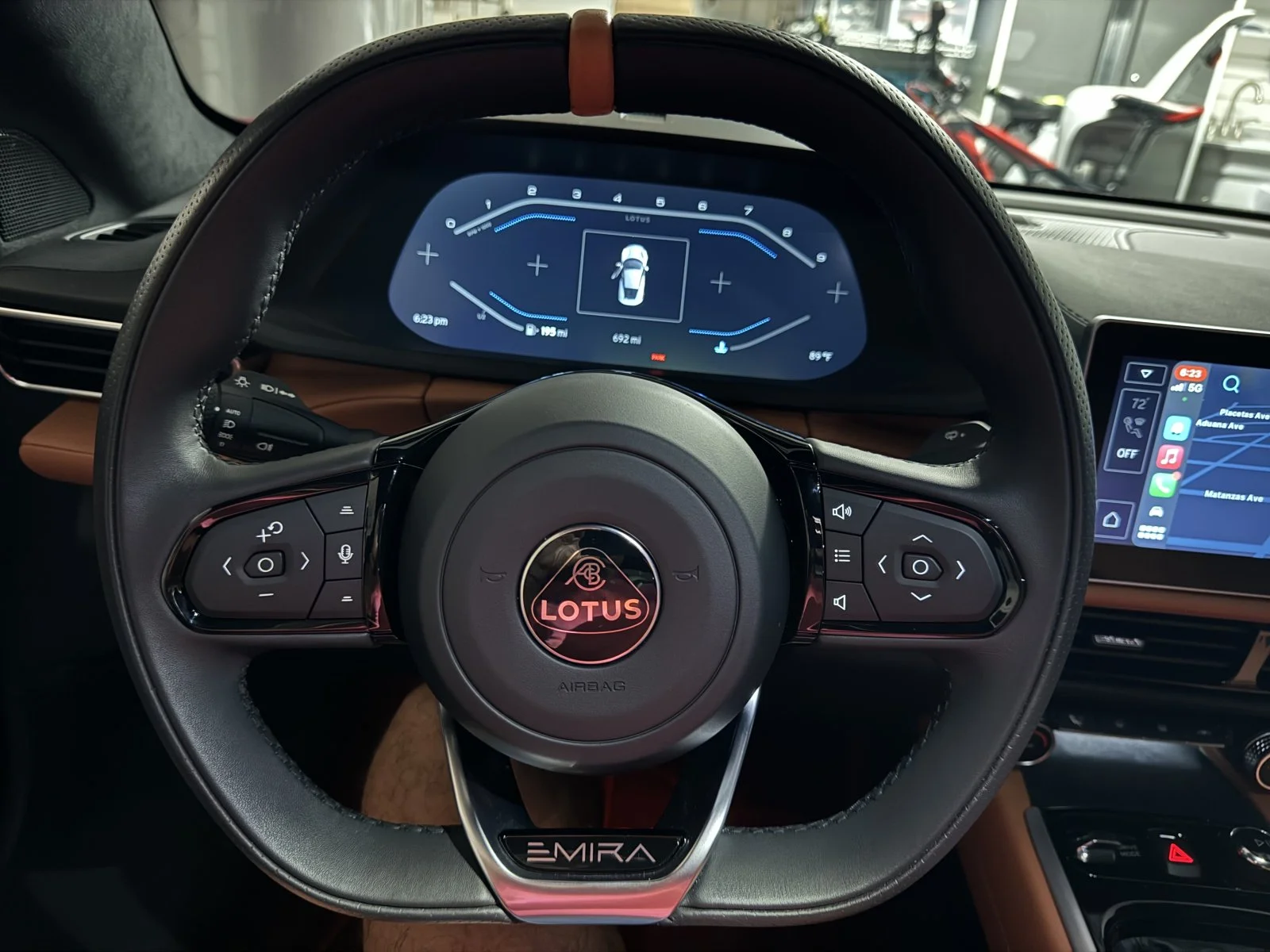

Although not ideal for you, it does give the rest of us a nice in-situ comparison of the two different types!
And bi-polar pants!
Not hating... celebrating.
I’m assuming pajama pants. I thought the same and was going to comment. I can’t say how many times I’ve sat in the car in my garage in my pajamas. Love it!

Installed the replacement left side module today and all is working fine now. My steering wheel's Bi-Polar disorder is now clinically cured.
Looks so good! Better than OEM, can't wait to have mine installed.
Yes, and the best part, it is avoidance of accidental mode activation that occurs with the OEM haptic version.
