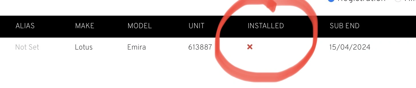

I hadn’t paid the tracker much attention until today. Dig out emails. Clicked on links and set up an account. Downloaded app (no luck with that).
But don’t seem to be able to get the tracker to work.
2 questions for those who already have their cars (in the UK) and have Scorpion up and running;
If you log onto your account online and go to Vehicles what does it say under the “Installed” column ? Mine has a red cross as shown below.
Second question - if you get in the car without the tracker fob does the car tell you (as it does in a Porsche for example) ? Mine doesn’t.
I fear the system was not set up properly at the factory - but will call Scorpion and do more troubleshooting tomorrow.

I would call Scorpion. This was how mine looked and it transpired to be a faulty unit and had to be replaced. The thing to keep an eye on is if it’s a requirement of your insurance. Scorpion were great at responding with me on this.

I had same issue, contacted Scorpion they sent someone out the day, they rebooted the tracker unit and that fixed the issue. Good luck
You need to ring them up and they will complete the installation remotely in my case they sent a command to the unit to finalise and the Red Cross went away.

Thanks to various Ops for their replies and input.
Sorted the tracker today but the fix was interesting so I’ll share what happened;
As suggested by @JXJ and @Emira28 I called Scorpion. Has to wait 15 mins for an answer (holding music is horrible) but then spoke to Jordan who was super helpful.
He checked his system and agreed the unit was not working/installed correctly. He asked me to go to the car with a fob and start it up so he could try to finish the install remotely.
I did that and he asked me to turn it on and off a few times and we waited about 10 mins at one point. No joy so he agreed to send a technician.
He called back a bit later and said one more thing he wanted to try. We tried that and no joy.
Then the killer question - where is your car parked ? In the garage I told him.
What is the mobile signal like, he asked. Not great - so I rolled the car out of the garage, the system saw the satellites and got a better mobile signal and boom it was working.
Obviously this won’t for everyone but two lessons from this;
Before you leave the dealer/factory log on to the Scorpion system and check the system is actually up and running.
If you get the red cross call them. They may be able to log on remotely but if they do take the car out of garage/car park whilst they log on.
Or they will send someone. Good service. But Lotus should really check install works !

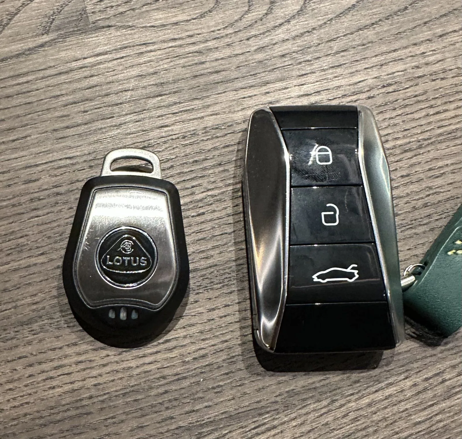

in some of the posts above you mention tracker fob ? What is this I’ve sent various emails to lotus and had no response .
Had the car for around a month now, but I don’t have any fobs ? Just the car key ?
Cheers
The fob talks to the Scorpion unit in the car to tell it that you are the owner. If car is stolen the theory is that the thief won’t have the fob and the owner is alerted and car is tracked. As long as you don’t keep the fob in the car or by your keys !
It’s on the left by the key for scale.
