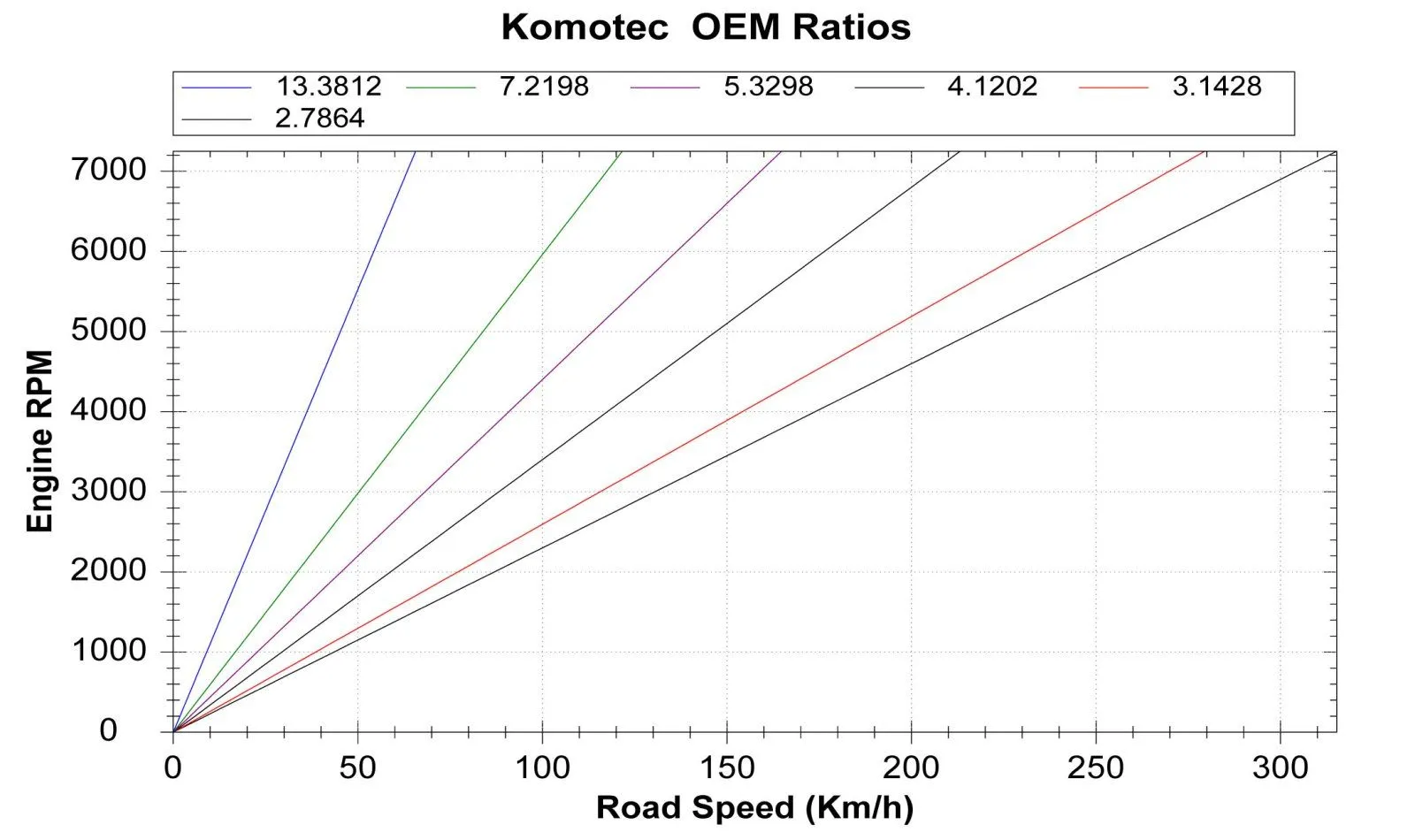

Found this on their Komo-Tec homepage:
Ratio Standard (Evora 400/410)
Gear Speed km/h at 7200rpm
1: 65,65
2: 121,65
3: 164,79
4: 213,17
5: 279,47
6: 315,21
Ratio Standard Evora 400/410 (Emira)
Gear Speed km/h at 7200rpm (6800rpm)
1: 65,65 (62 km/h)
2: 121,65 (114,89 km/h)
3: 164,79 (155,64 km/h)
4: 213,17 (201,33 km/h)
5: 279,47 (263,94 km/h)
6: 315,21 (297,70 km/h)
