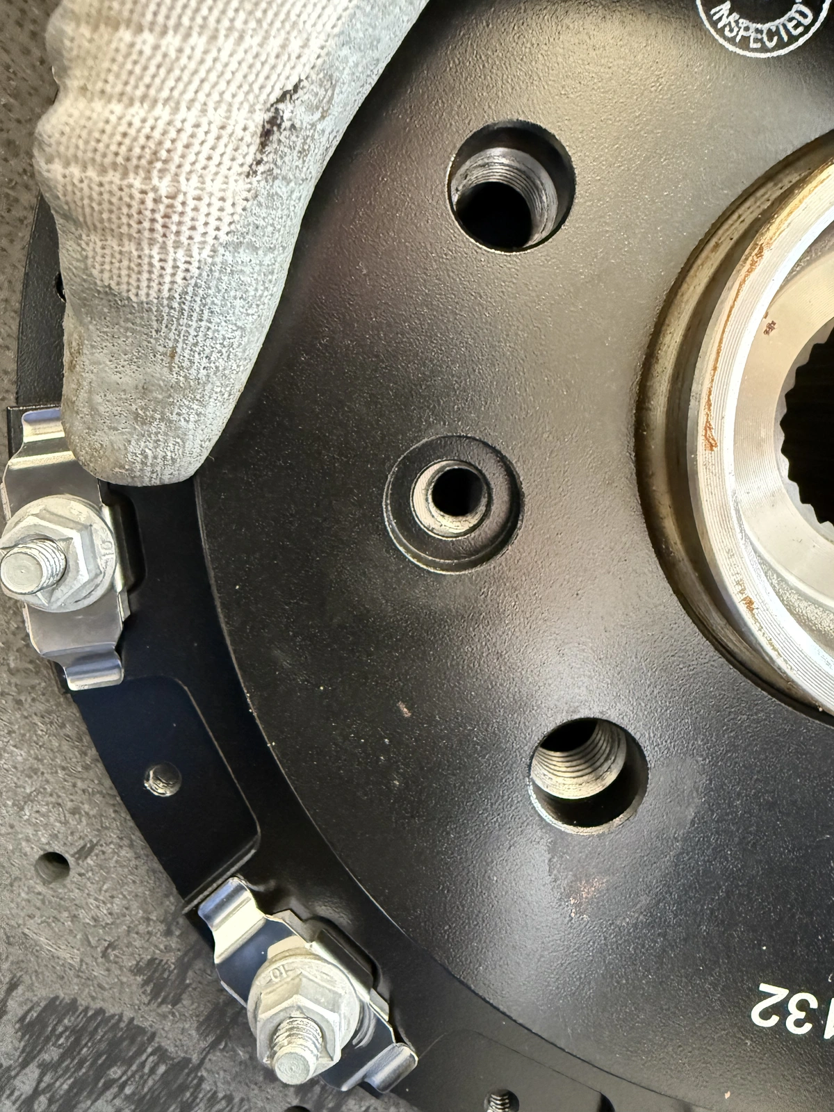

Starting this thread to document my experience with the RB rotor conversion as well as a how-to for anyone as annoyed by brake dust as I.

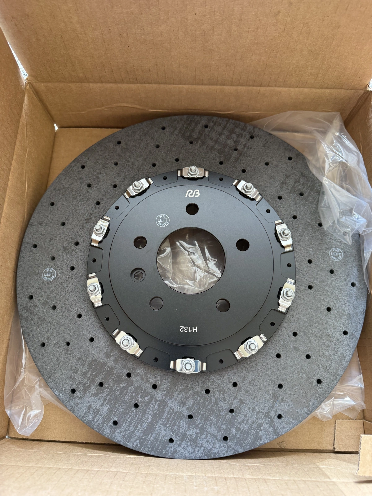

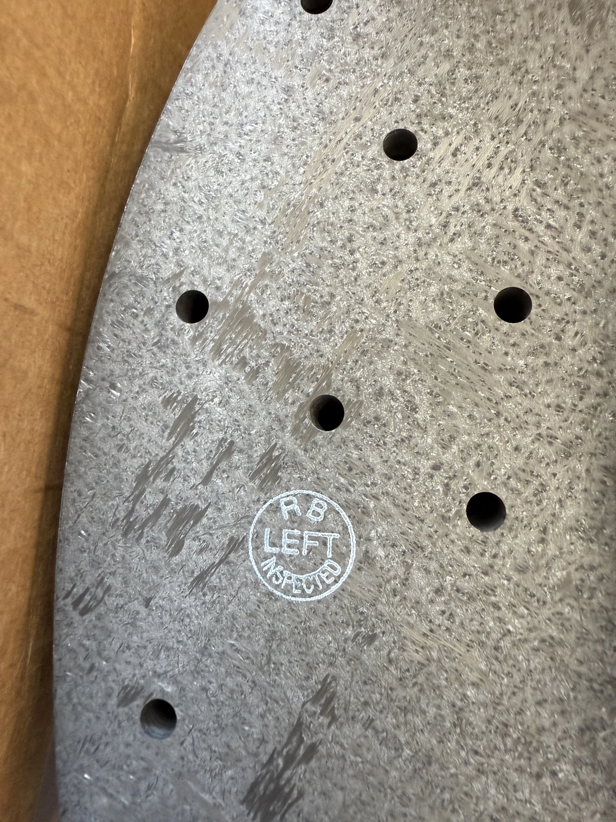

To start, the ordering process was smooth and since I'm also in CA they arrived very quickly. They certainly look awesome:

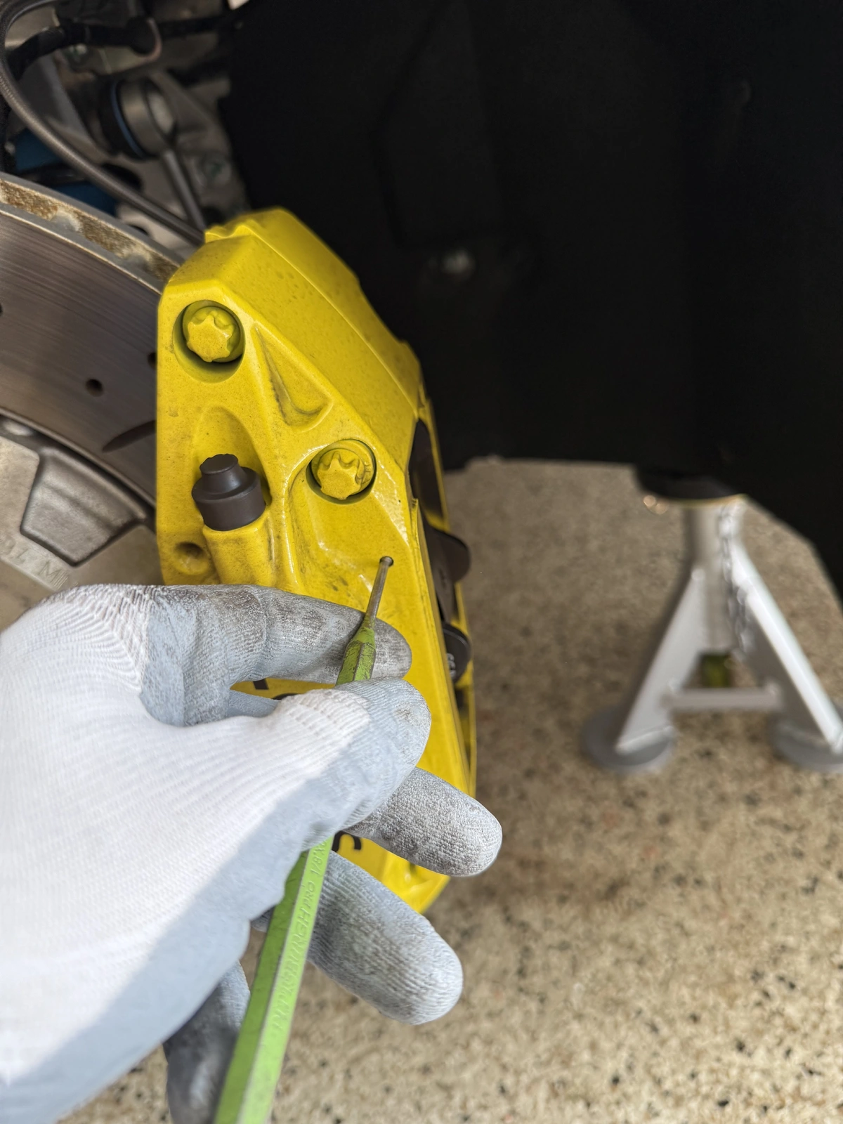

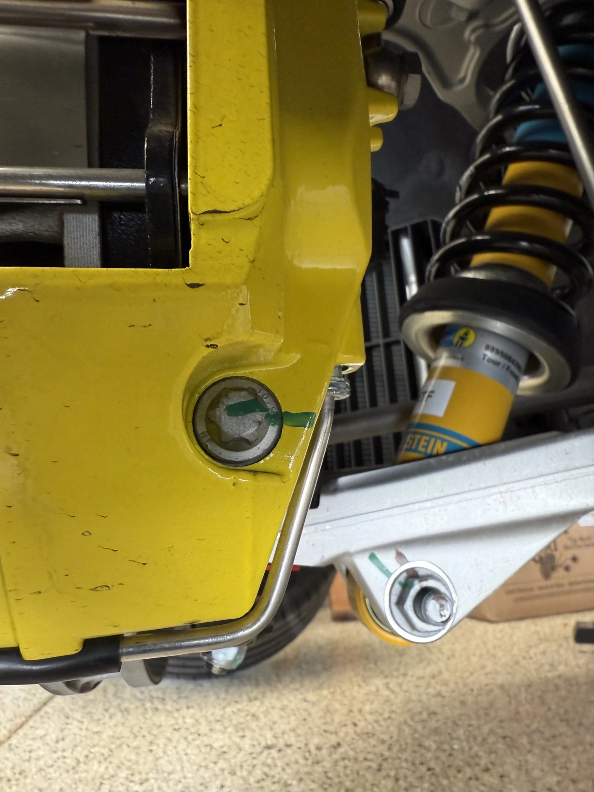

The first thing I noticed when reviewing the service manual was that the caliper bolts are one time use and need to be replaced. This seems easy enough but it turns out non of the US dealer websites have any Emira parts available so you need to call to order the parts. My local dealer is only able to order parts on Wednesday and the parts arrived about a week after that. They are very proud of these bolts and they cost ~$40/each.

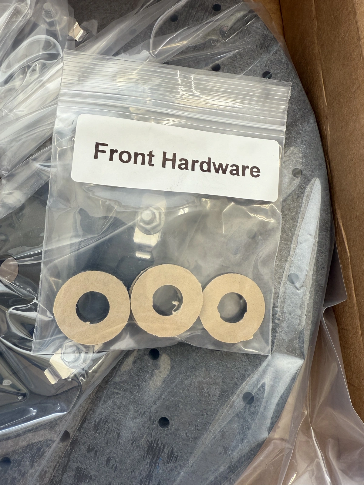

I also contacted RB around this time because the front rotors include some hardware (4x spacers) but no instructions on where/what they're for. Given the front rotors are 10mm larger it's fairly obvious that these are spacers to push the the caliper out 5mm. The team at RB confirmed this and around this time I also suggest that they include new caliper bolts given the premium product. The folks at RB agreed and sent me new caliper bolts for the front but not the rear. I also suggested that they include 5mm longer caliper bolts to have the same thread engagement as stock but the team at RB assured my that the factory bolts are plenty long enough. I'll probably buy 80mm bolts just to be safe.

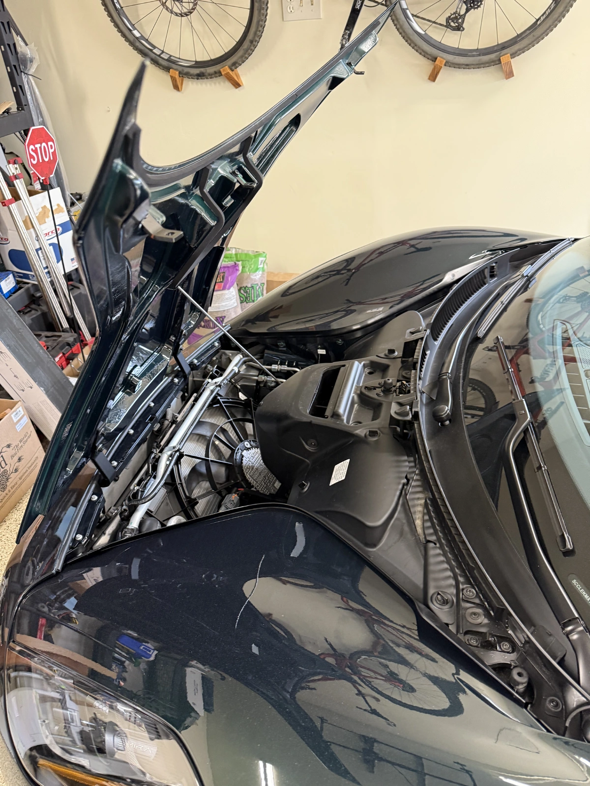

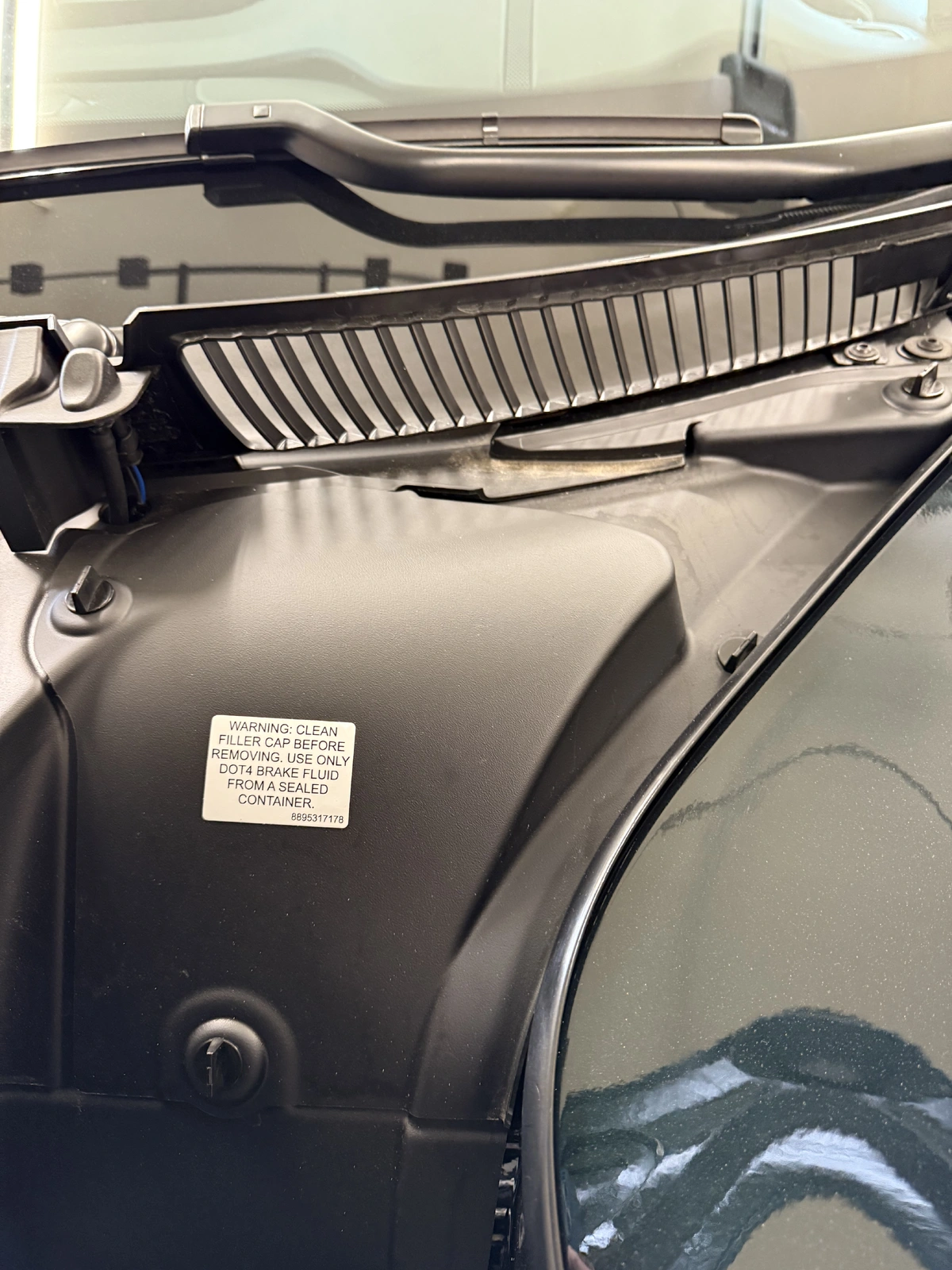

From here I began the install; make sure the parking brake is off. The first step in service manual instructs you to open the brake fluid reservoir so you can compress the caliper pistons. There are three T30 Torx screws that you need to remove in order to prop the hood up. They are behind some plastic flaps which somehow went missing during my PPF so they were readily accessible to me. I suggest opening the hood while the car is still on the ground as the middle screw is tough to reach. Once the hood is up the reservoir is behind a black plastic cover held in by four twist fasteners.

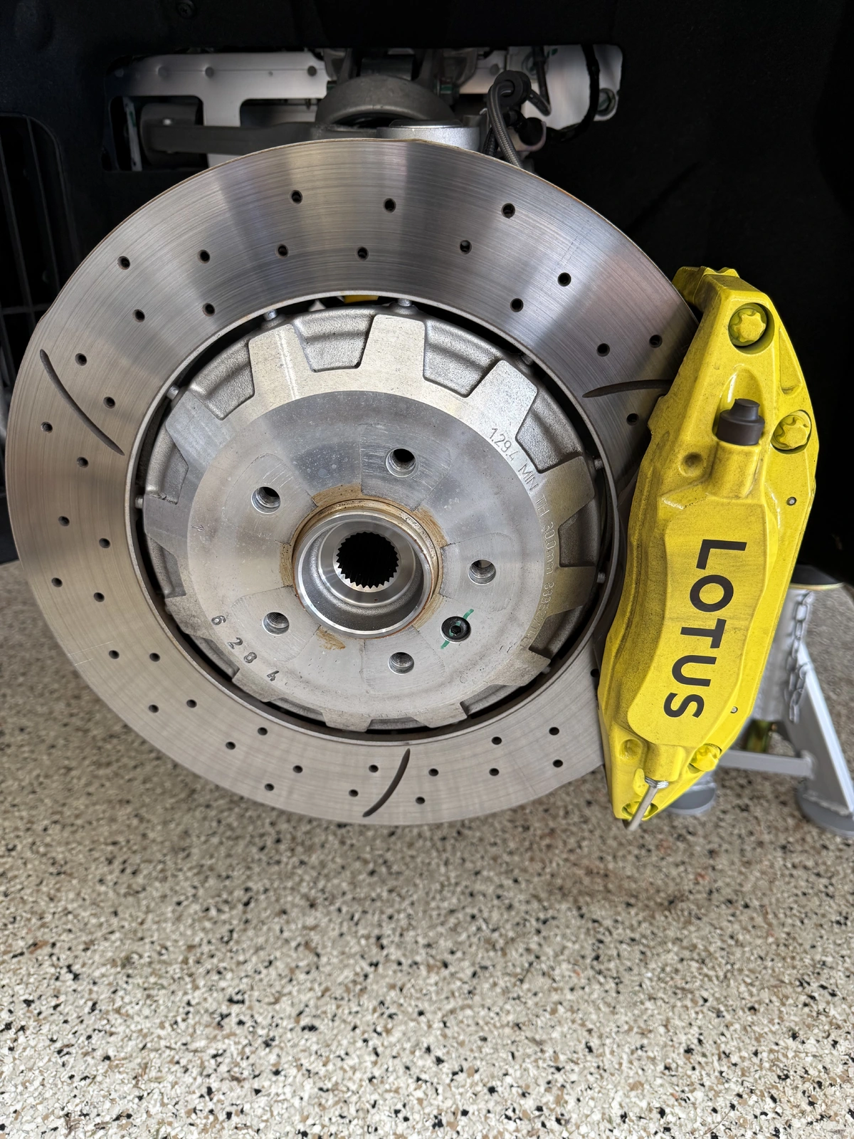

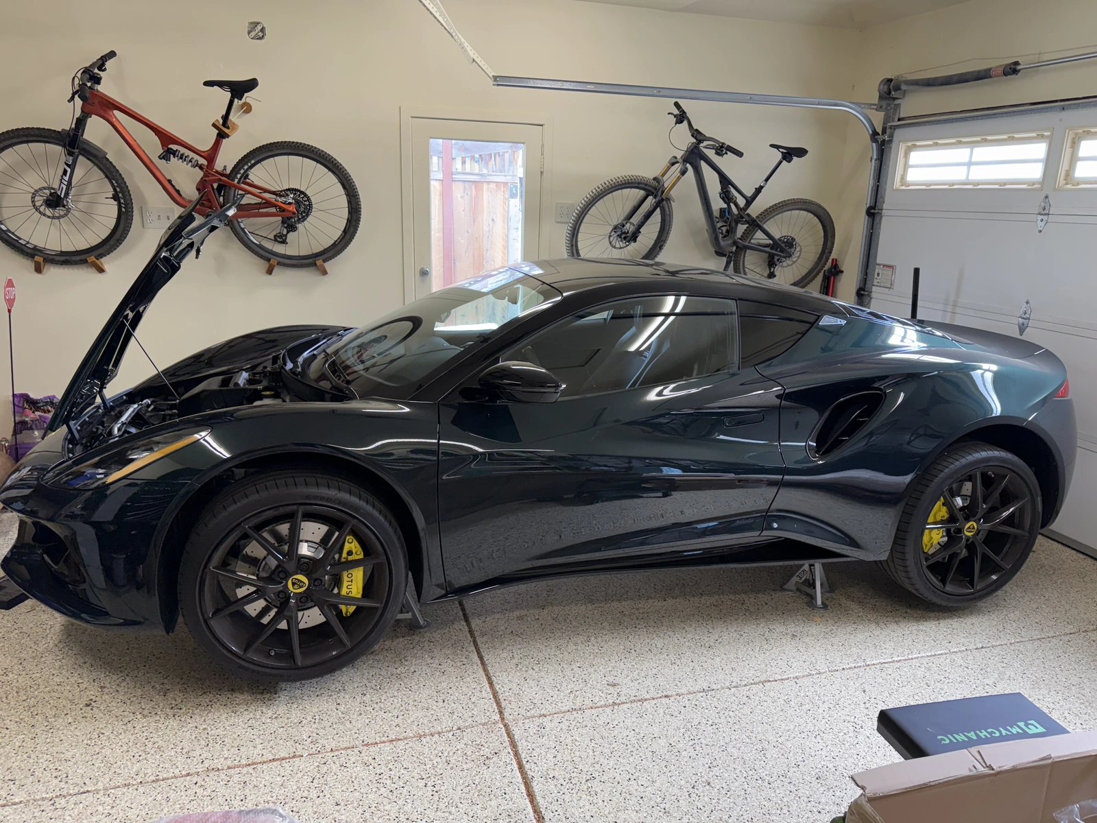

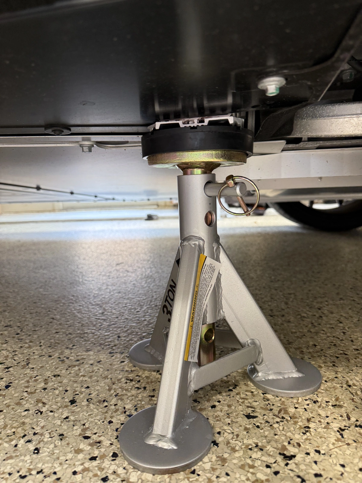

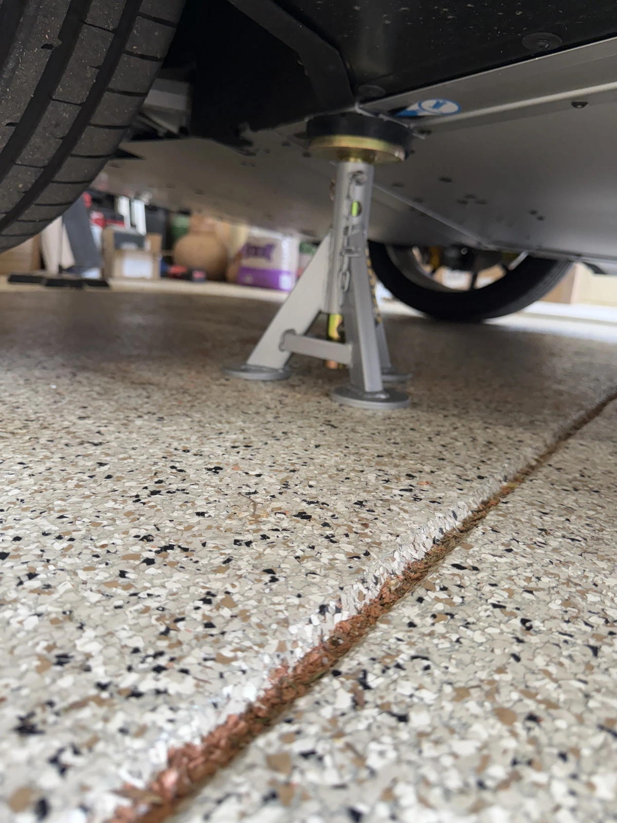

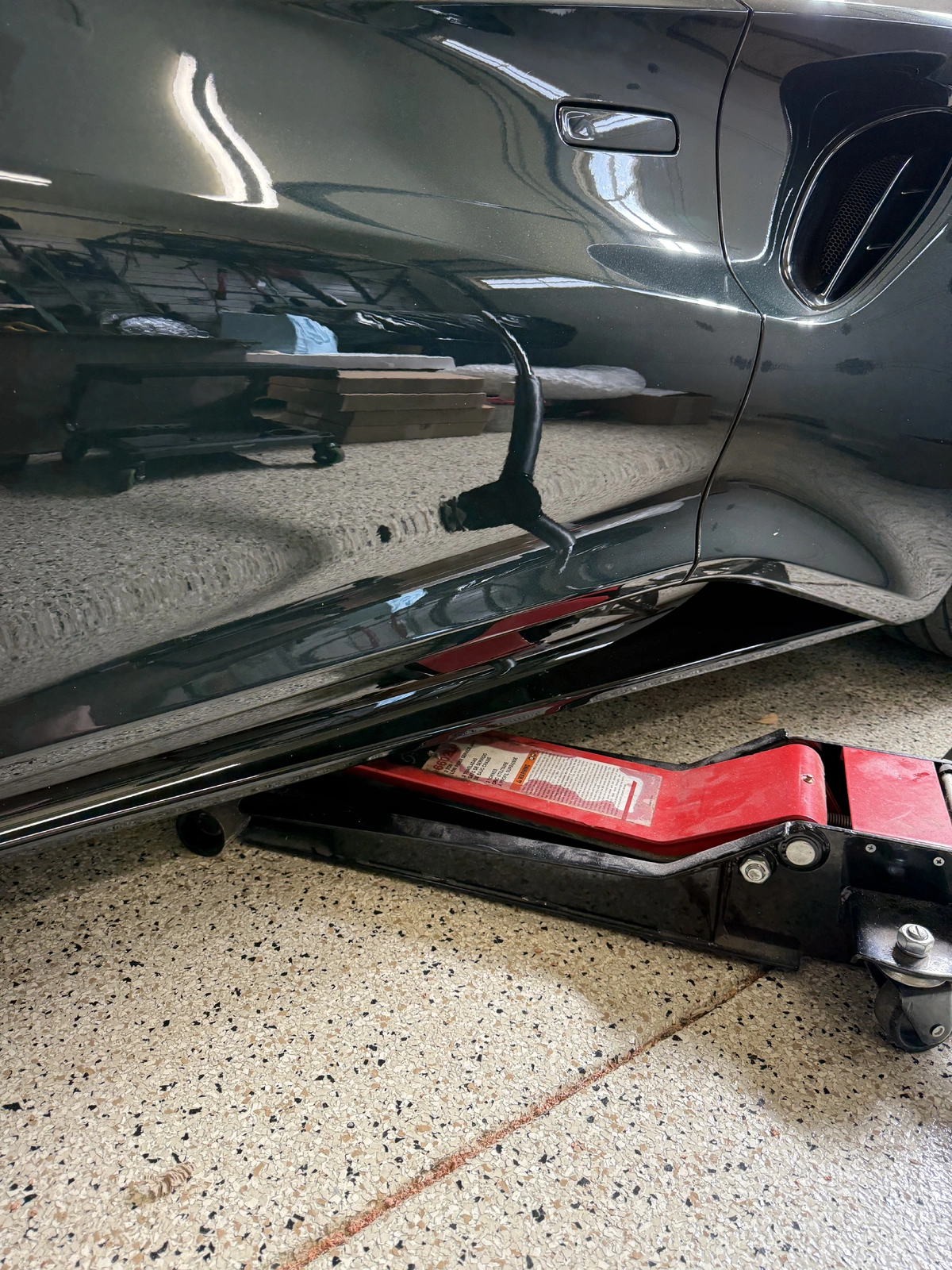

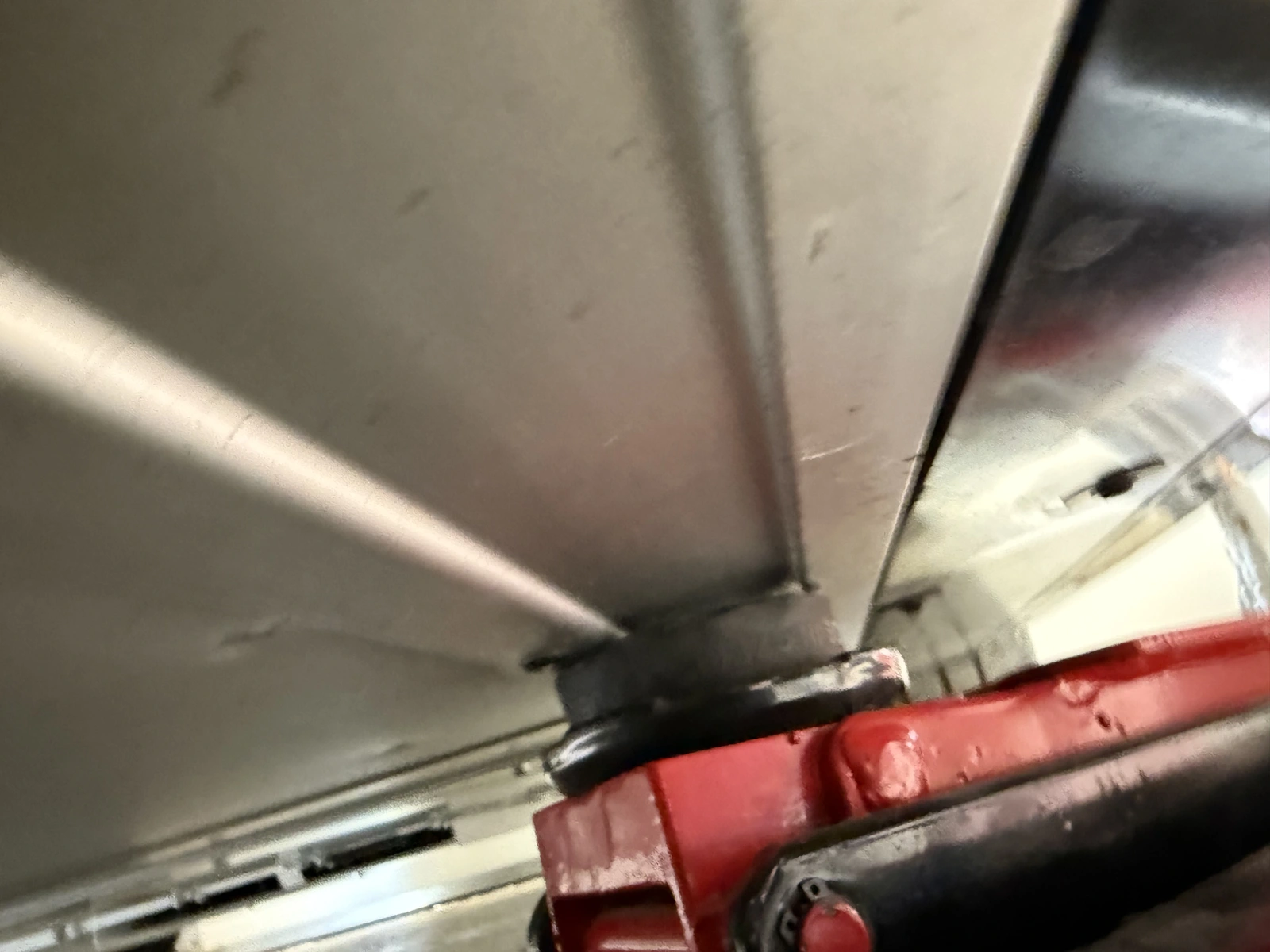

From here it's time to jack the car up and get it settled on jack stands. I'm using an impact gun to remove the lug bolts but if you're not you may consider loosening them before you get the car off the ground. I jacked from the side using a hockey puck against the rail and then positioned the jack stands under the factory jack points.
With the car in the air you can now unscrew the brake fluid reservoir and start the install.
