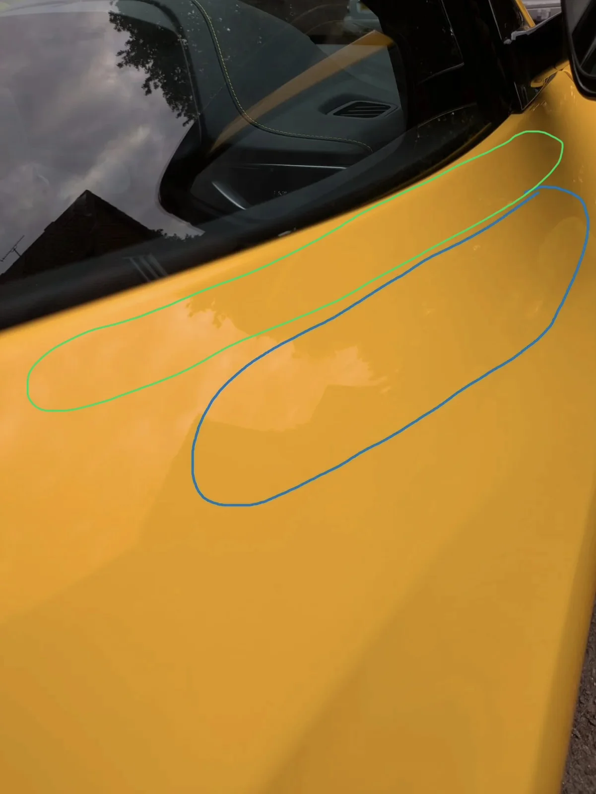

@geoffbland apologies, I’ve pinched your photo!
My bubbling was slightly higher up on both of my doors, in the area circled in green. I’ve also seen a number of pictures of other people’s cars with bubbling in the same area as mine.
I don’t think water can collect behind the panel in the green area as it’s the very top of the door and it’s angled so water would run down the door.
I'll also try and get some more pictures when I take mine in for replacements, that is if I'm allowed to.
Mine is also in the green area, but I don't have a picture from the other side.

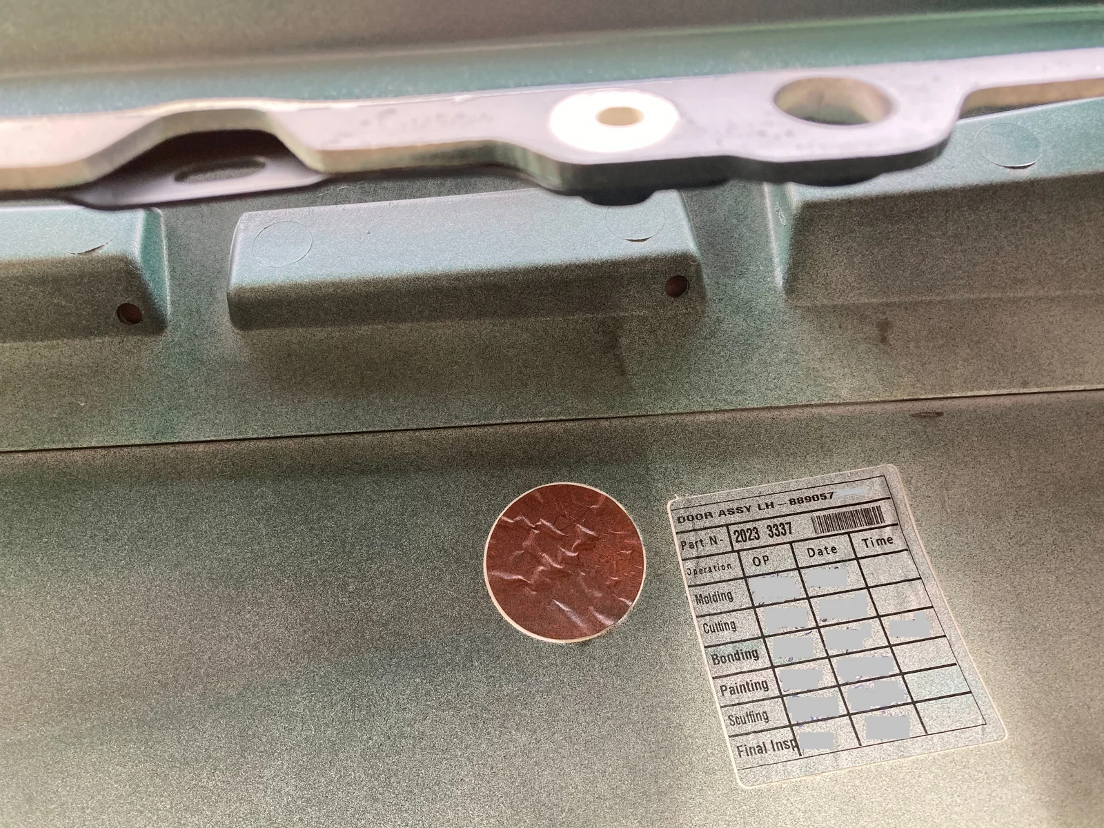

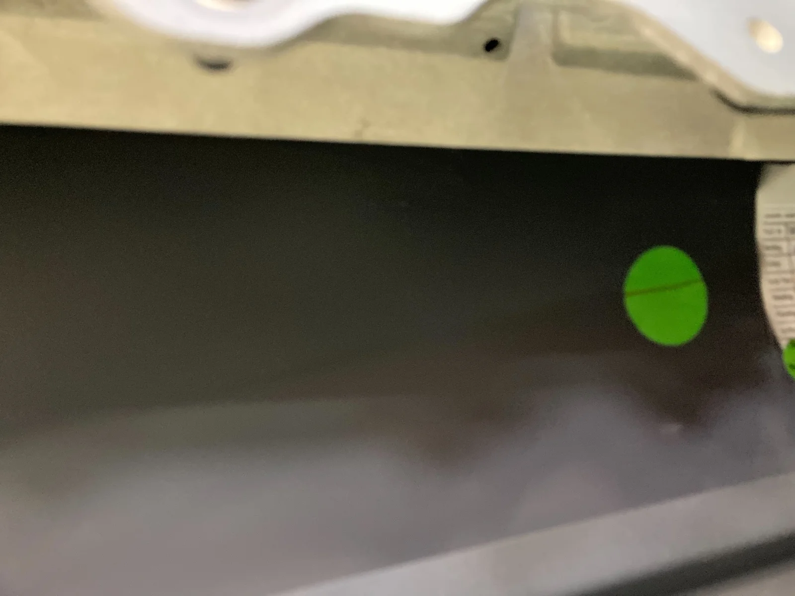

This is a picture of the unpainted door taken from a low angle looking up. You can see a seam between the inner panel and the outer "skin". The inner structure has drain holes, but they are tiny. Maybe this is an updated design? I am asking for a picture of the removed door from the same angle to compare.
I think what all of us want to see is what is happening on the other side of that area (that is where my blisters are), and that is why I am asking the dealer / body shop for a picture of the outer skin removed. I don't know if they can do this for me, but will let you folks know how it goes.
This is a great pic, thank you. The fact that there are drain holes confirms they are there to extract moisture. My theory now is that water gets in from the top where the rubber seal meets the actual glass from the window (i.e., top of the door where the glass slides up and down). Water seeps in and collects in the what is likely a super narrow cavity between the exterior skin and ends where you see the seam. That's probably why the drain holes exist in those small blocked areas right above the seam.
That skin removed pic will be insightful, for sure.
BTW, I'll just add, behind those drain holes and above them would align with where most are seeing damage. The suspense to see that pic!
There seems to have been a mixup of photos. The door with the round brown inspection sticker is my old door (Dark Verdant paint overspray on white-ish panel), and the door with the round green inspection sticker (unpainted white-ish outer shell on new(?) dark gray inner side of external skin panel) is my new unpainted door.
They both have drain holes, so the fundamental design looks the same, but the color of the insides of the external skin panel is different.
