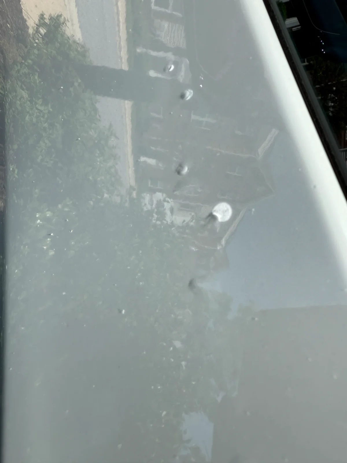

Washed my April ‘23/10k miles Emira at the weekend and noticed some strange marks on the bonnet/front wings (6-8 spots in total, each the size of a small coin) which I hadn’t seen before. Am planning to take to my detailer for an opinion, but wondering if anyone here can advise what it might be./had the same issue? It’s always garaged, so not from tree sap/bird guano. Car never been through a car wash, or even had a jet washer on it either. Having had both doors replaced perhaps I’m just paranoid and it will polish out🤞

Looks like some type of chemical etching.. Should be able to polish that out.

Remember the front wings and bonnet are composite but not made in the same place as the panels with paint problems.

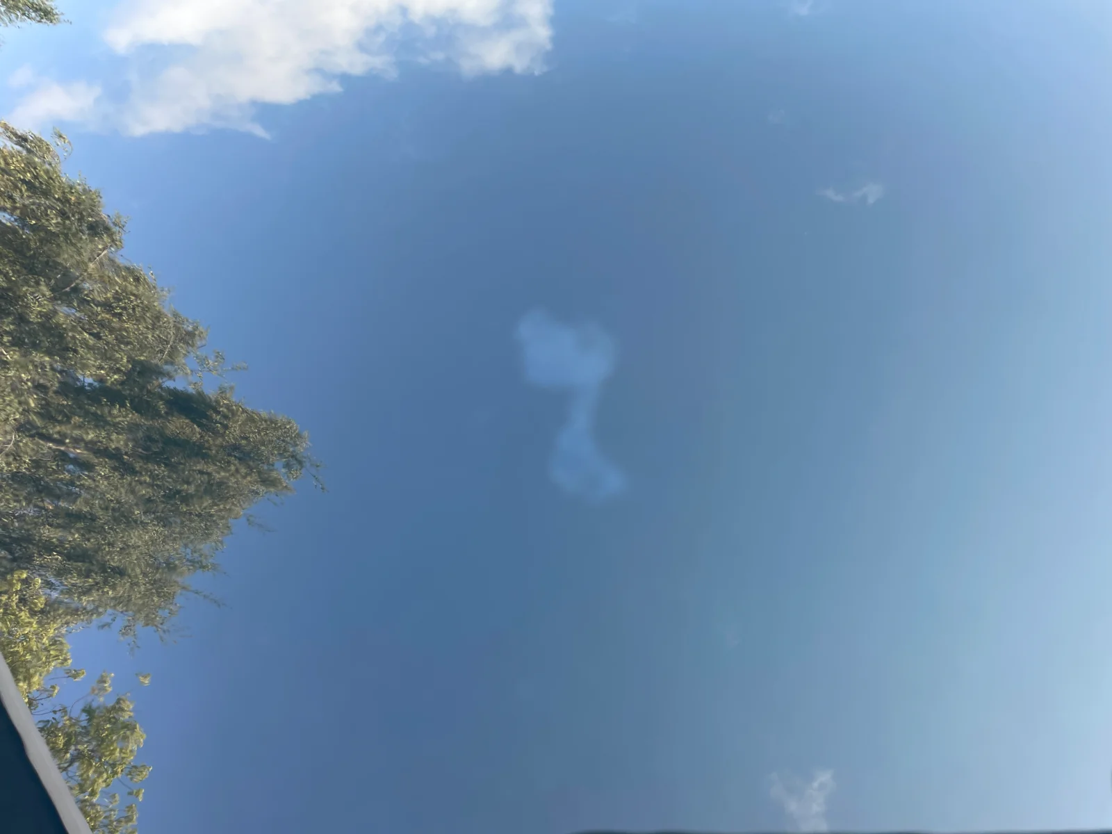

2025 Lotus Emira V6 received end of March 2025. Lotus of DC in Rockville, Maryland USA. Notices this under the Lotus PPF in May. Dealership is waiting on the replacement door. I was already told they will be replacing the PPF.

So they basically do nothing about it and keep replacing doors. Seems like a really good plan…
