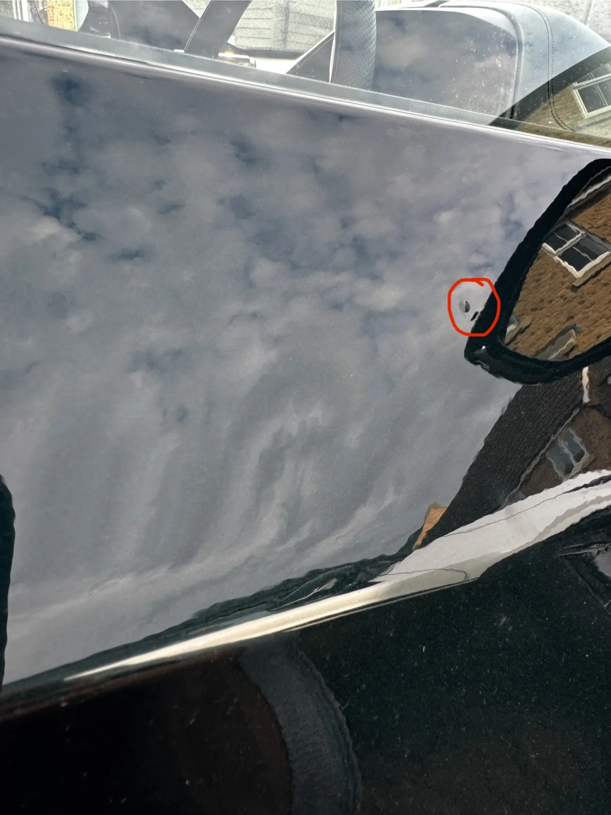

Just noticed this on mine today, drivers door about 3 inches from the top of the paintwork!
Purchased mine in Oct 2023.
It’s been PPF’d so this will be an interesting conversation with Lotus!
I was in the same boat - I thought it was going to be a battle but was just accepted. I had to submit them a copy of the bill to prove the type of PPF used. They will be fitting the same as part of the repair by the local dealers preferred PPF company.

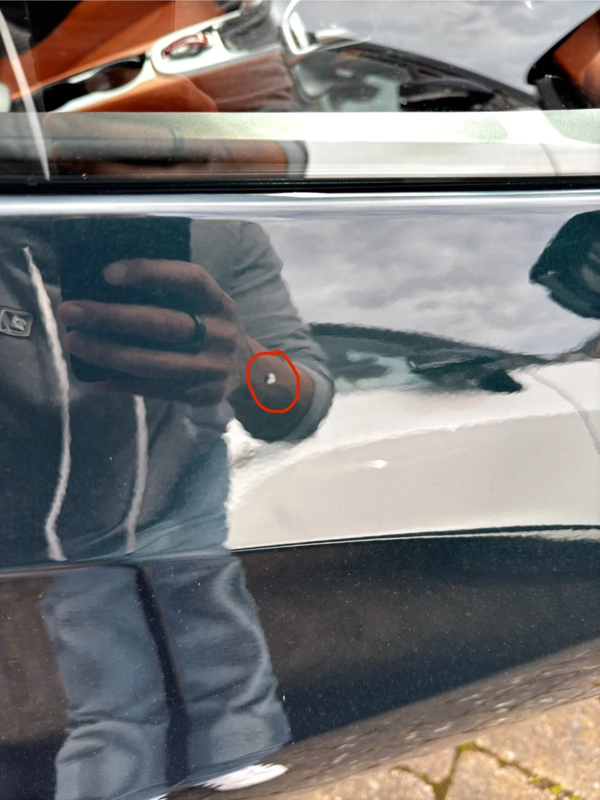

I just noticed a bubble on mine near the lotus badge on the back. F*ck.

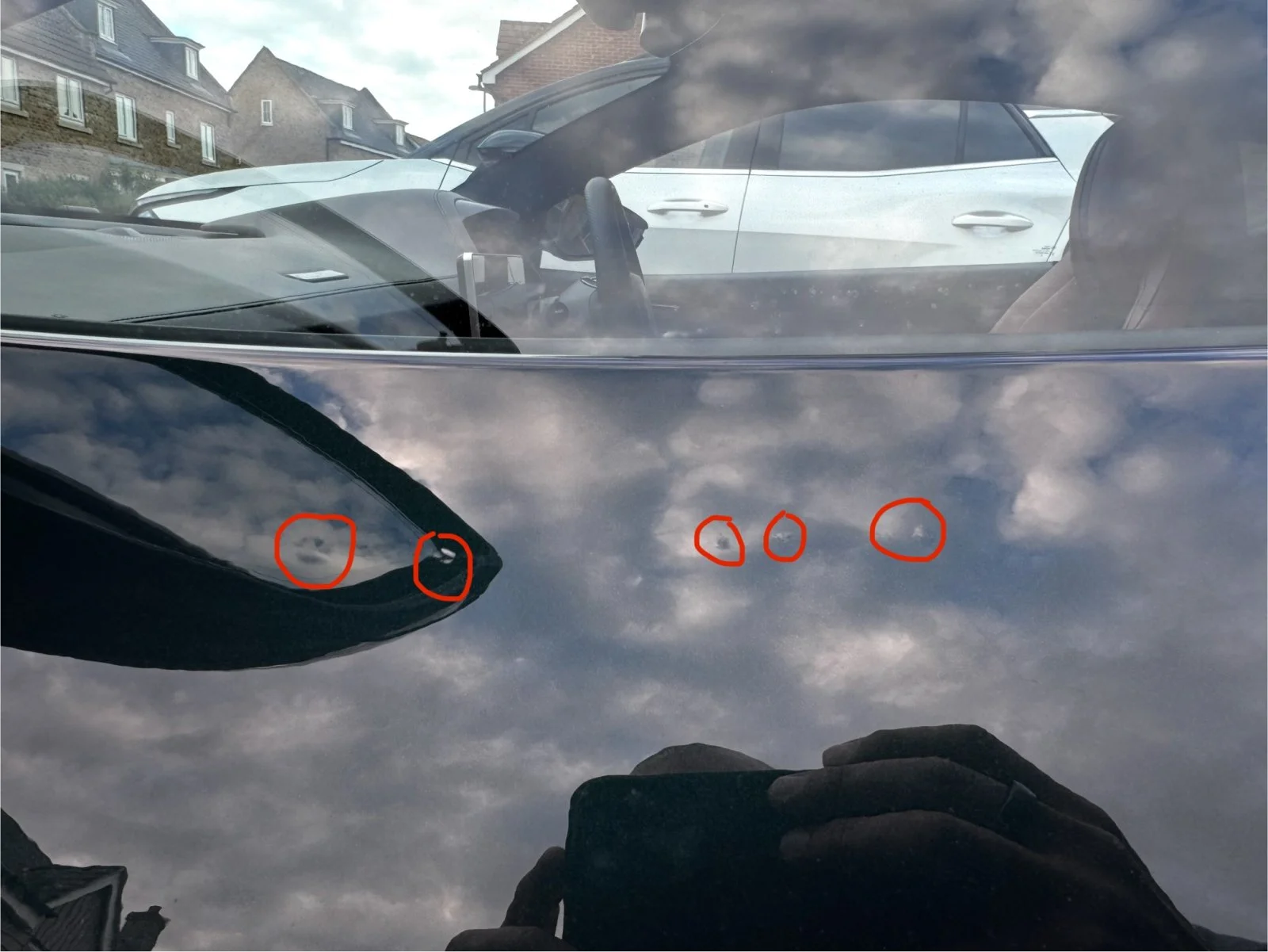

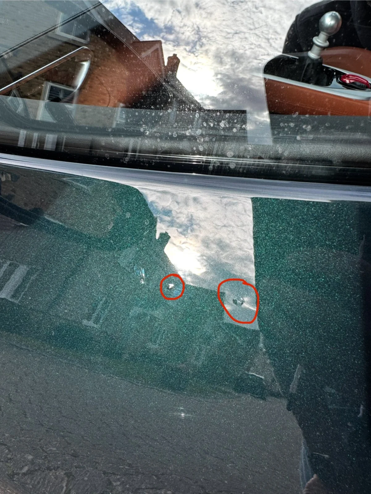

Just noticed today bubbles on both doors. Build date was early 2023.
I’m the second owner and now I’ve properly looked over the drivers door after seeing the bubbling, it’s 100% already had a sand down and respray under warranty to “fix” the issue. Just goes to prove that the issue isn’t with the paint……..
Have emailed Lotus Silverstone as my local service centre to see what they say. Given it appears to have already had a bodge job done with a respray, I won’t really accept anything less than 2 new doors 🤪
